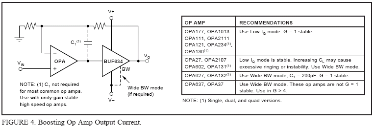

I used the LT1010 simply because I like it a lot. I find it equal in my testing to the BUF634, yet it is less expensive and easier to obtain.
Russ, I understand that the price is more appealing, but the LT1010 is not the right buffer to use with some op-amps, including the OPA627/37.
20Mhz bandwidth, 75V/us slew rate.
These figures should be much higher (like on the BUF634) to guarantee a stable interface with fast op-amps, when used in the feedback loop.
Russ White said:
As an example the bandwidth is lowerd well below 20hz with a 20pf cap between opa out and opa inverting input as per the buf634 data sheet.
Notice on the datasheet what mode they recommend for the BUF634 working with the OPA627: Wide BW. Even with the 200pf cap.
Wide BW mode is 180 Mhz, instead of 30Mhz.
Now look at this table (in page 9):

The LT1010 should be okay with the 627, since it's GBW is only 16mhz, right? I believe TI/BB recommends using the wide bandwidth mode on the 634 since it lowers the noise and distortion figures.
