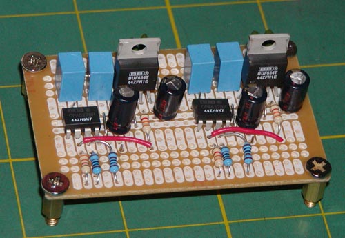

OK, I have finished building an testing this preamp. 🙂 Here are some pics. It works great!

Here are two pics, the first is the PCB design, the second the finished pre with +/- 15VDC PS.
Cheers!
Russ

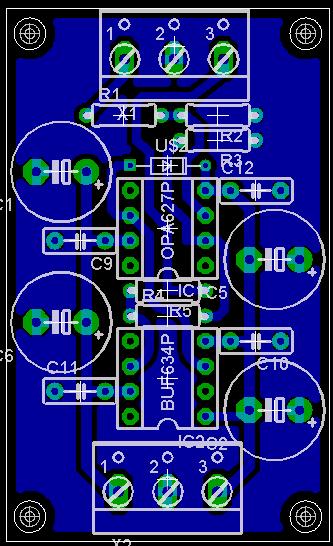

Latest buffered pre design
I had some time to tinker. If you want to run a buffer biased you really should use the TO220 package, so I did here. I also left plenty of space for a heatsink as you will verly likely need it.
I used the LT1010 simply because I like it a lot. I find it equal in my testing to the BUF634, yet it is less expensive and easier to obtain.
This design should work for just about any single opamp.
It would make a great headphone amp, and will pump out 150+ ma. easily.
Any feedback?
BTW the jumper is there for insurance. I probably will not need it, but I wanted pads there just in case.
Don't laugh I am still a n00b!
Cheers!
Russ
