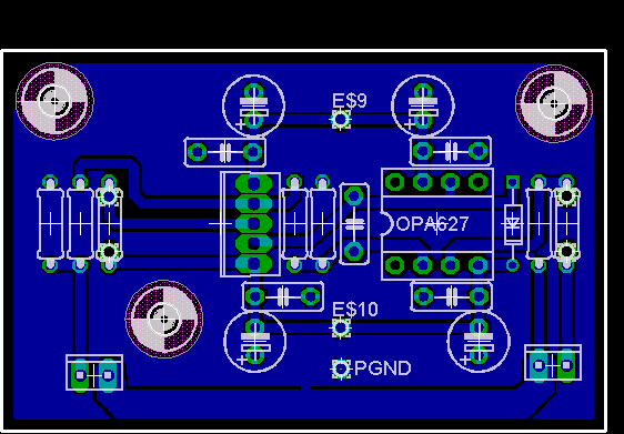

Ok here is what i have so far.
Things added:
*Mounting Holes
*BUF634 BW mode resistor or cap location
*Pads at input to allow option of cap instead of resistor
*Signal ground and power ground now connected
*Only one mounting pad for psu wires (+V, -V, and Pgnd), instead of connector blocks.
*More space to allow for easy mounting of BUF634 heatsink.
*Board components spaced out a little bit, due to board being slightly larger.
What do people think of the board now? better or worse, more room for improvement?
Please give me your suggestions.

Awesome!
Wow! Very nice noober, a couple of ideas if you don't mind:
1) flip the cap on the V+ side of the buffer to make mounting a heatsink easier.
2) Consider trying to get the mounting hole on the lower left more toward the lower left corner for the the same reason as number one. You could do this by slightly rerouting the SG plane from/to the buffer.
3) Instead of a direct connection between the two ground planes, make two pads. Then there are lots of options - leave it open, jumper it, use a low value resistor for isolation.
I like the power and ground changes. :up:
Very good work!
looks quite good, cute too.
however, inputcaps this small is had to come by, at least i have trouble getting them small sized.
if possible, make it possible to use 22mm Rm caps like the one found here if you paste in "2447-7500PF".
hope you can find the place for it.

Hi there Marius,
I could not connect to the link you posted. However is this the device you are referring to.
It shouldn't be a problem to add it, but it will slightly increase the size again.
I dont want to drasticly change the layout from its current state. Once this one is finalised I may work on another version that has "little improvements", but that depends on how happy i am with tis one :devilr:
This would allow this kind of addition with less of a size impact.
But thats for the future.
n00beR
EDIT:
On closer inspection if the cap you are looking at has the dimensions "20.07 x 7.87" this could probably be added with no change in size.
However it would hangover the -in resistor, the CRD and stick out a little over the edge.
If there is enough demand for it I will add it, otherwise the leads could be bent sufficiently to fit.
First of all the current design looks great, and I would be ready to purchase them as is. That being said, I do have a couple of comments.
Yes I realize these comments are too late for the current board design, but I thought I would suggest them anyway in case anyone else is designing a similar project with the 627 and 634.
I would like to see a version of the PCBs with adjustable regulators on the boards, as it is best to have them as close to the opamps as possible. Being adjustable, different power supply voltages could be used (by changing out resistors) based on what tranny voltage is used. This could be an easy way to use this pre inside a GC with its current power supply.
Using the opa627 and buf634 in these designs results in an expensive parts list and a high end product if designed right. Therefore I see using on-board regs as necessary if you are going this far already.
I like Dave's thinking, And I think his suggestion is a great idea for a larger board, especially a stereo board.
Let not forget however that while this board is for the 627/634 it will actually support just about any single opamp (ad8610, opa227/228, opa277, LT1115, etc..) So cost is actually quite arbitrary. You could also use any buffer with the same pinout of the 634.
Also, while this preamp sounds absolutely fabulous with a regulated PS (I am currently running it as such), it also sounds amazingly good even with a simple unregulated PS. I think that should be a builder's option.
Plus, there is something to be said for this board's simplicity/size. Still, I would love to see a board with Dave's ideas implemented.
