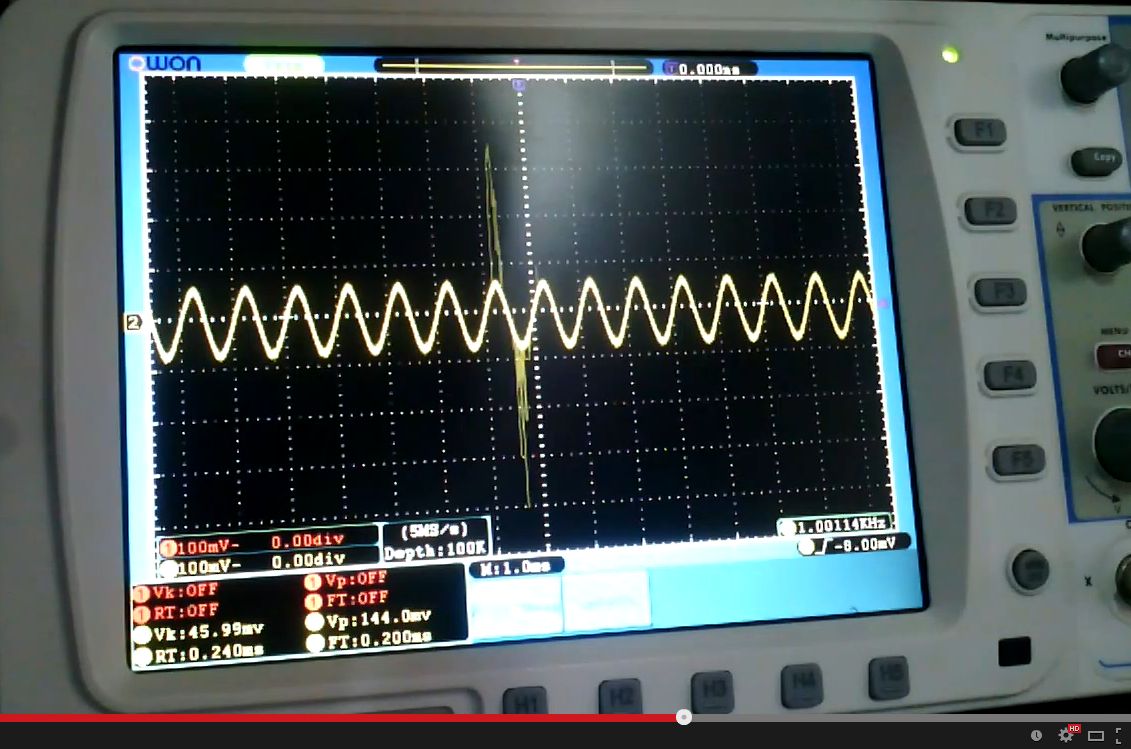

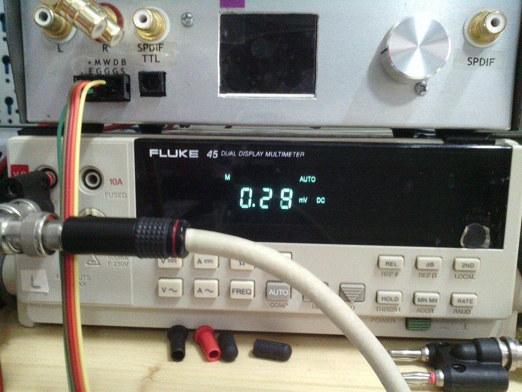

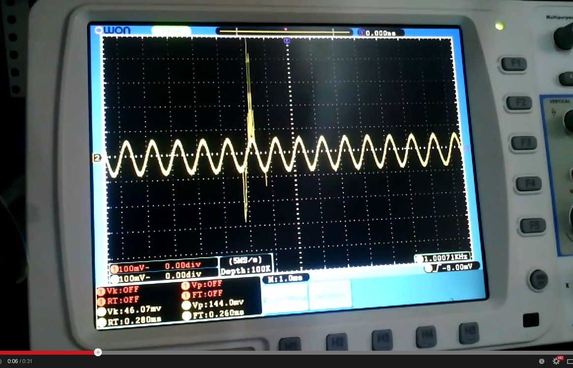

Hi Tibi,
Now, I caught the glitch very well!

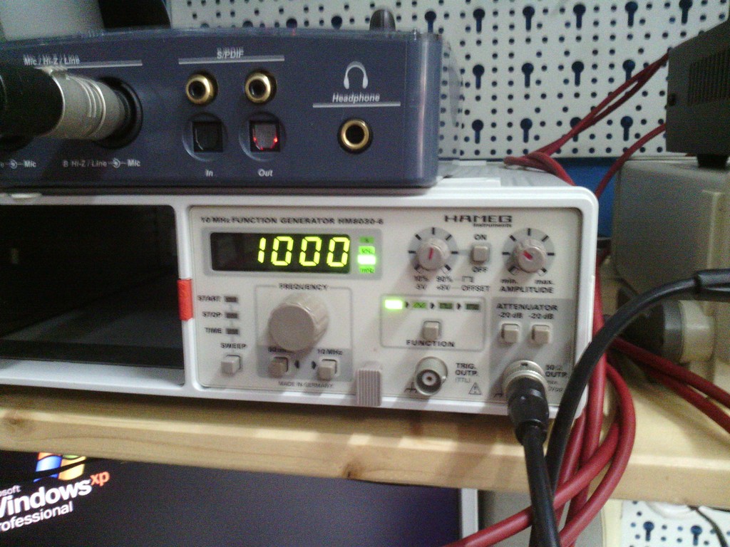

Here is the setup, that I used.
A 1KHz sinusoidal signal from a signal generator, with very low dc-offset feeds (≈0.3mV) the left channel of R2R and the Left output or R2R feeds the input of oscilloscope.
The oscilloscope was with DC Coupled at 100mV/div, at 1X full BW.
The signal at the display of oscilloscope has 148mVpp.
From what you will see, there are many significant glitches at the zone of 32-31dB of attenuation (the same are at the 16-15 zone and some very closed to 0-6dB).
I measured glitches from 300mV until to 800mVpp!

Hi Lemon,
As far I see you are testing an older unit ?
The last version have decoupling capacitors on each relay and relays are Takamisawa.
I have measured these glitches again and beside the fact these are far outside audio band > 40KHz, are barely distinguishable and do not affect in any way audio performance. So what we are talking about ?
Tibi

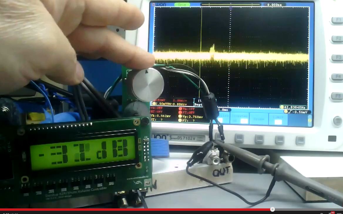

Tibi, I looked to the new board and this glitch is bigger from the old one. Sometimes is bigger than 1000mV to this and more often!
Yes, I see that you have added a small smd capacitor under the diode.
I tried to find the frequency of this glitch...I have done some FFT measuring and I see when this is happening, all the Noise Floor of the FFT from 10-30KHz rise-up to the -65dB. At the other range that there is no this "pop" the rise-up of noise floor is under -100dB.
I have done a video about all of these, but first I want to put some parallel capacitors to diodes, maybe 470uF and see what will be happens.
Lemon,
Adding a 470uF over diode will mess relay switching due capacitor time to charge and discharge. You need to use far smaller cap, something under 1uF, but I think proper value will be in 1nF - 100nF range.
FFT on a step or Dirac impulse will not tell you anything. The right approach to to calculate inductor cap based on relay release and connect times. For A5W these are 6ms and respectively 4ms. And of course experiment with these values. But the most efficient is to remove any parasitic DC component.
Tibi
