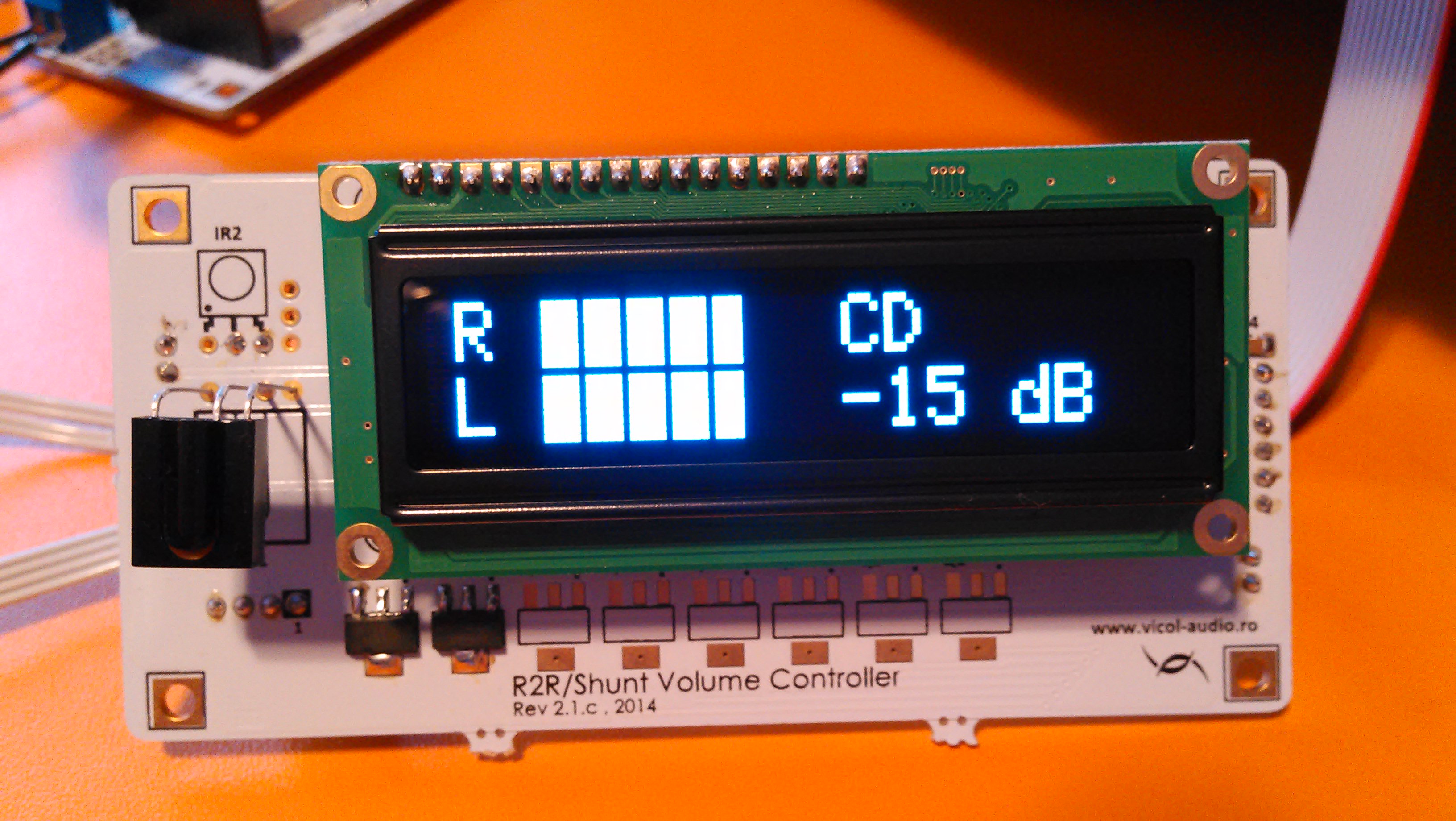

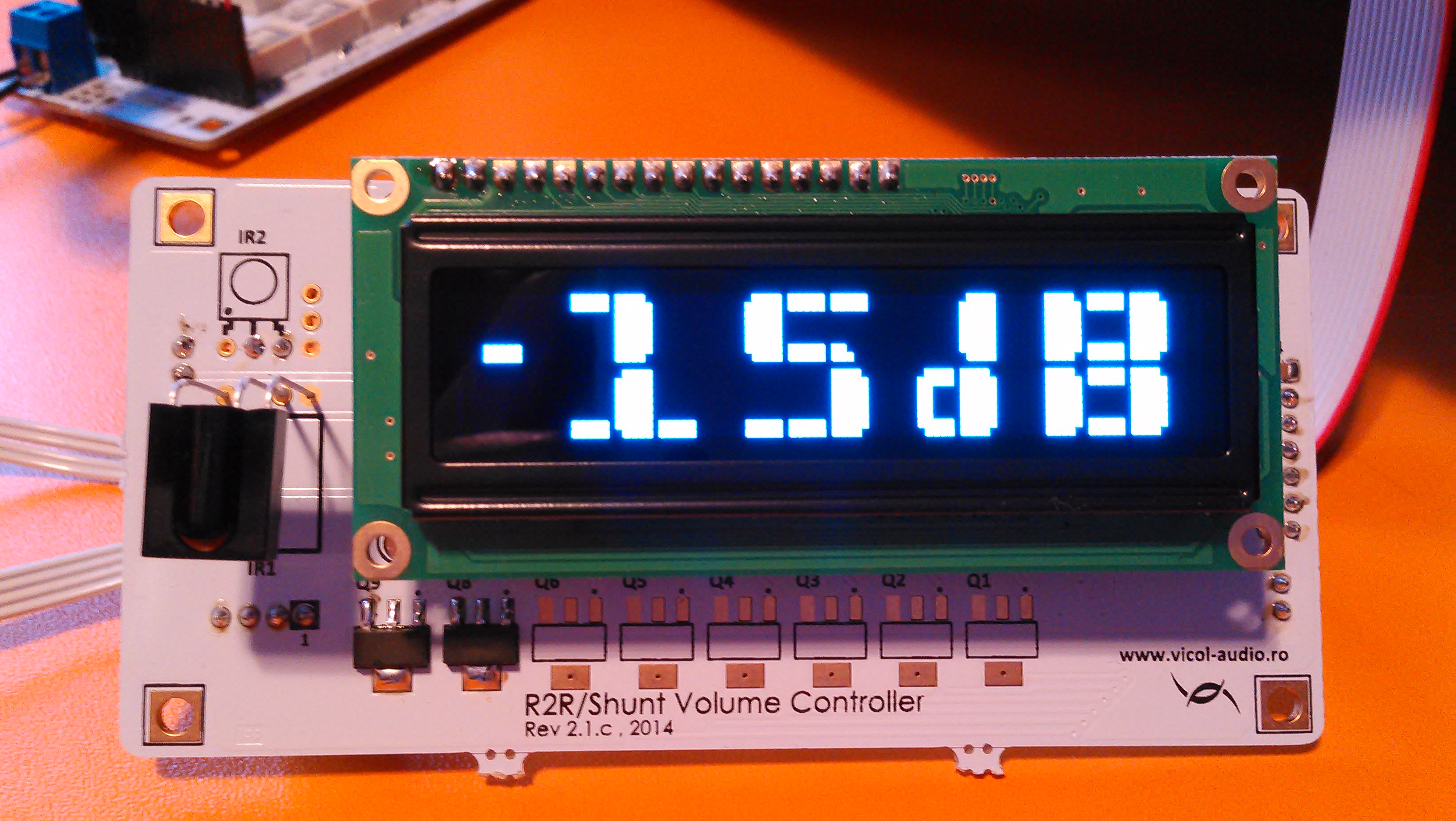

Hi Tibi,
Winstar WEH001602A is HD44780 compatible, which means I can buy it as replacement?
Just tested and is working without any firmware change, very, very well.
Thanks rogerchou !
OLED controller is fast enough to accept atmel quick commands. Therefore WEH001602A is a drop in replacement.
However, backlight menu option have no sense now, but this will be implemented in small firmware update.
Tibi
Thanks rogerchou !
Tibi
Very nice!
Have in mind that the NHD-0216SZ-FSW-FBW from Newhaven Display works perfect with your controller.
The NHD-0216SZ-FSW-FBW is a large 99 mm x 24 mm viewing area display (Size: 122.0mm x 44.0mm).
More info at NHD-0216SZ-FSW-FBW NHD-0216SZ-FSW-FBW [122.0mm x 44.0mm] - $22.00 : Newhaven Display International, Inc., High Quality Standard and Custom OLEDs, LCDs and VFDs.
There is no compatible series 16 pin (it has 15,16,1...14 in series) but it is no problem, with the dupoint cables the problem has gone.
