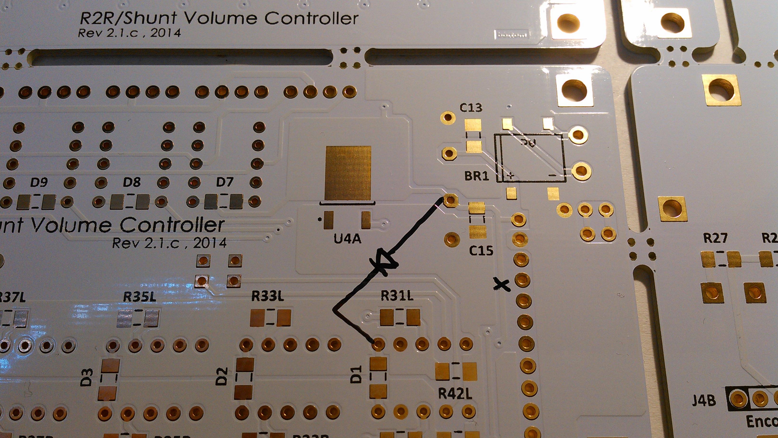

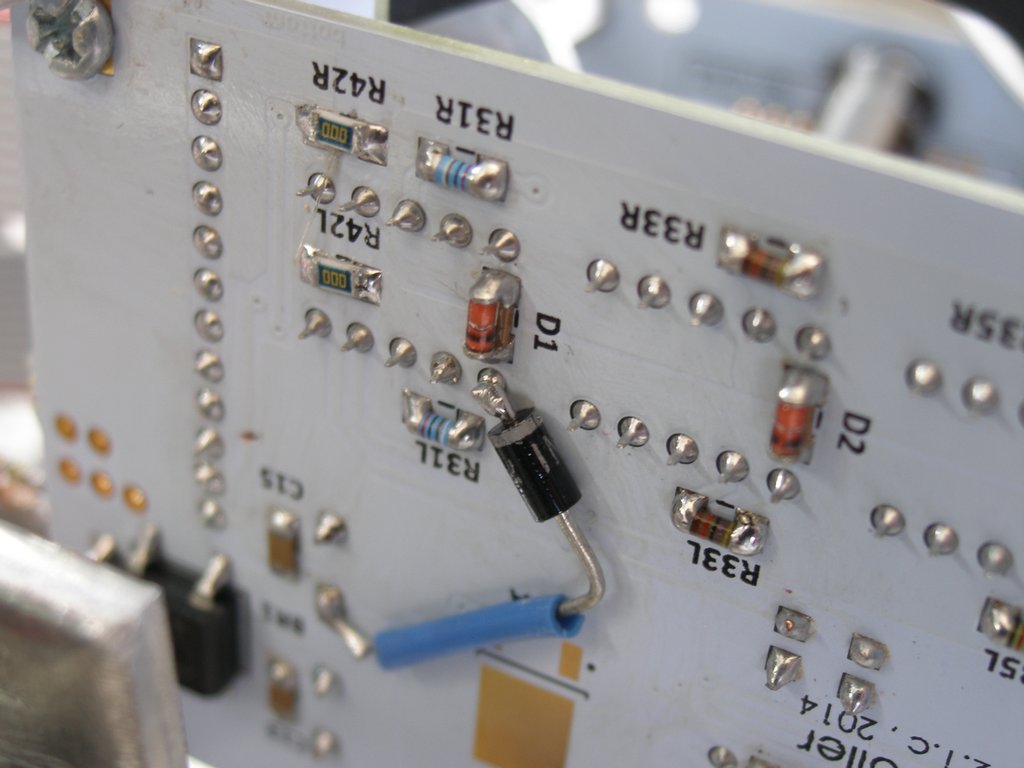

I think that there is a alternative solution about clicking relay noise, without code changing.
I have tested this on oscilloscope with lower voltage at relay. I see that the glitches has gone completely when the voltage is below than 4.0V.
With acoustic test the glitch has hone from 4.2 and below completely.
Finally, the alternative solution could be different voltage for relays and 5V for the controller+display.
I am looking for what is the best, without a lot of modification on pcb.
Two 1N4001 diode in series will drop the voltage to ~3.8V. Put them only on +Vcc for relay section.

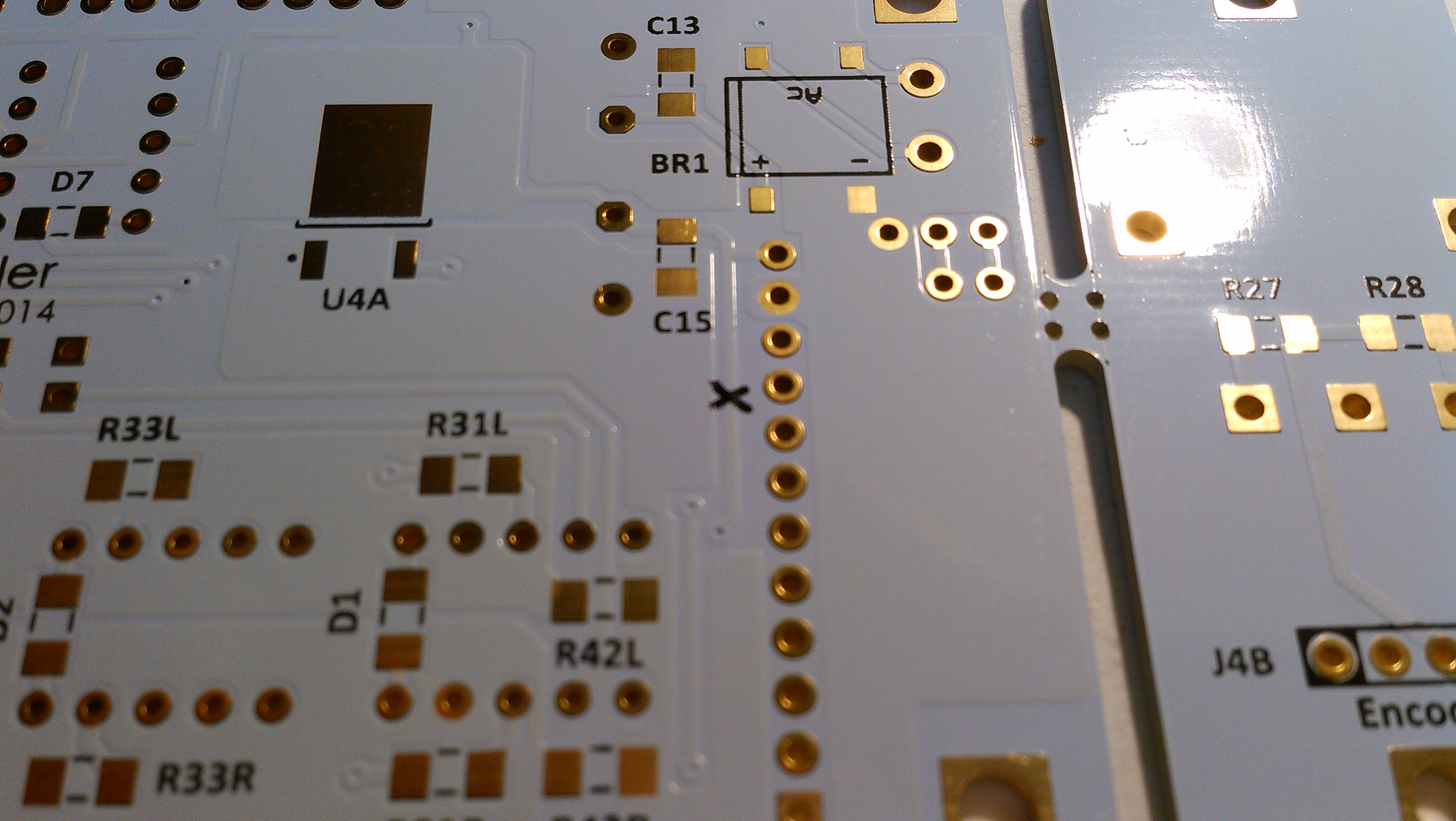

Here are promised pictures. Left picture indicate where you need to cut the track - see small black x, second indicate where to put 1N4001 diode. If one diode do not satisfy you, put second in series in same direction. Do not attempt to put the third diode as the voltage will drop under 3.7V and relays may barely work.

Thanks Tibi,
I'll try to take a closer look this weekend... hopefully there's enough space between the two boards to do this minor surgery (much more pain to unsolder that stretch of pins to separate the boards than this mod!)

One diode 1Ν4007 is adequate to filter all glitches, although the dropping voltage wasn't bigger than 0.67-0.79V depending from attenuation point.
The current via the diode is very small at idle position (0,033mA-0,049mA) that increased via transition (max. 16+mA) but the total energy is very slow (max. 0,040mW).
Then, this solution will be reliable at all the time of R2R.
