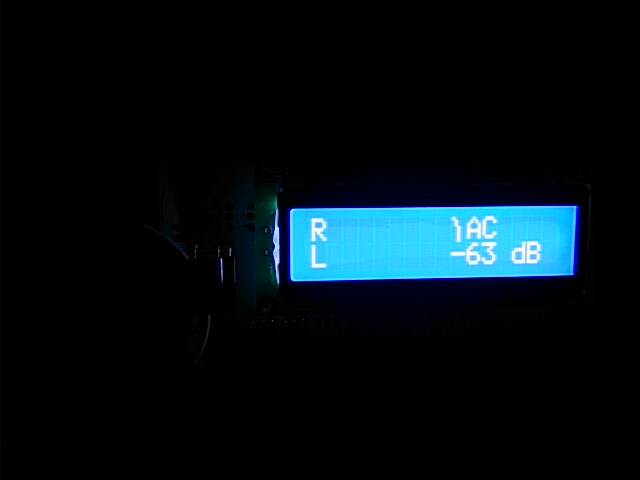

I have encounter something like this (but not the same) in the past only when firmware was not programmed OK.
I am try-ing to reproduce this strange behavior I have seen on youtube on your video but can not to obtain that glitch to appear.
This is how my test board is behave :

Tibi yes I have used the P1 pot, but...
To capture blue TN display right, you must have a camera with manual aperture not a simple tablet that I used !
OK, I make the fw upload and I will inform you.
Yep, that's it!
I uploaded again the appropriate fw and the problem with wrong volume level has gone!
Thanks guys.

It is very unlikely to happen that I was not believing my eyes when I saw that .Yep, that's it!
Thanks guys.
I have uploaded a new video, that demonstrate the right function of R2R kit. I captured the 2nd issue, also. I changed the blue display for the capturing...
I think that a possible solution is that the numbers of attenuation to be big but the letter dB to be capital small at the low right corner. Thus, when the input will be refreshed, don't mix with dB letters.
https://www.youtube.com/watch?v=ZODD4vHOe9M&feature=youtu.be
Then look at the code and see that sometime it is possible to happen (so rare that for me never appear because someone need to press in certain way buttons but you have already 2 with the same bug !!!!!) sooooo : v3.13 will resolve this.
