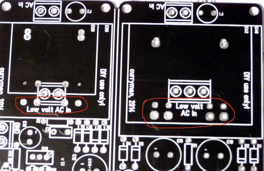

I have a quick question. I've been looking to source transformers in the US for the PSU but so far haven't been able to find any PCB mount trafo with the same pin outs, so my options seems to be to locate the trafo's off board. I'm thinking of using some small torroids that I have from Antek with dual secondarys for the 18v trafo and single secondaries for the 9v trafo. am I correct in assuming that I just attach the secondaries to the board at the PSB trafo secondaried as shown in the attached picture ?

Yes, correct. Alternatively you can use screw type connectors (5mm lead spacing) on the boards to attach external transformer like in the picture below 😉

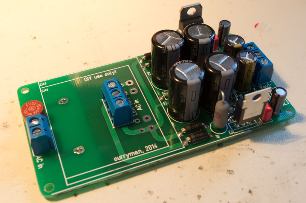

Just to be sure, D11 & D12 (zeners) go under the PCB directly on the trimpot pins, right ?
If you use the zeners for setting the voltage reference you must not use the trimpot and thus just put the zeners on top of the PCB.

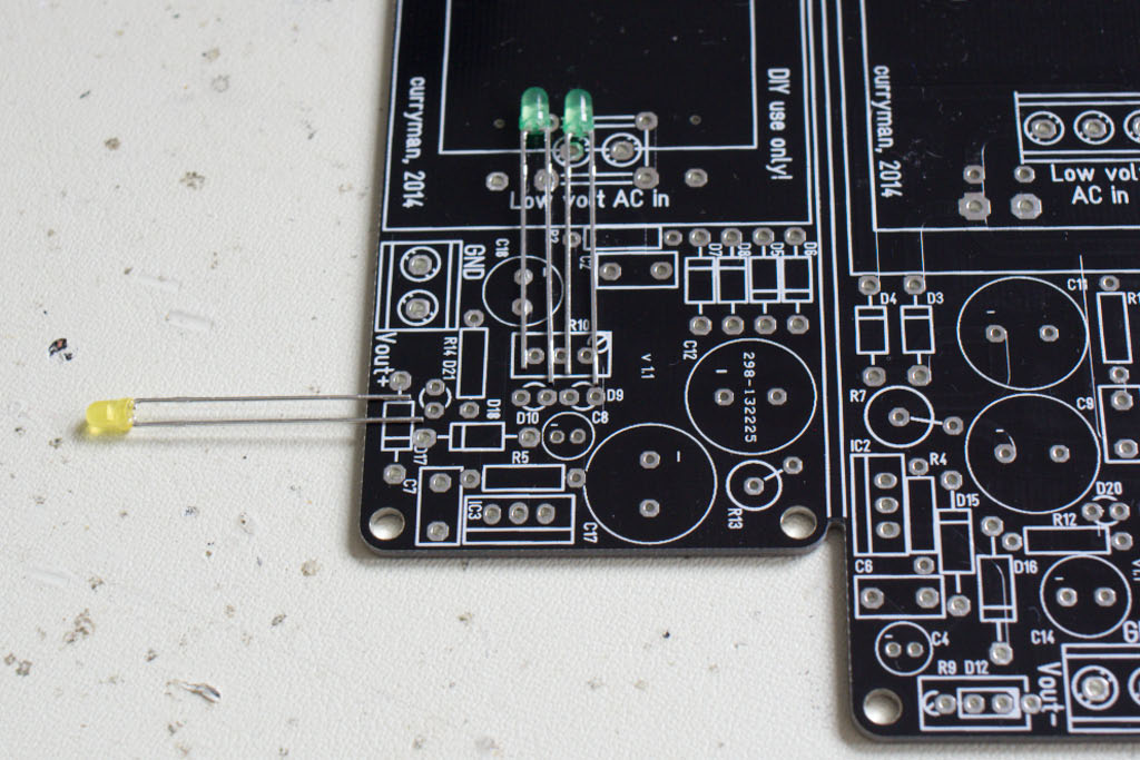

Guys, I need some help. I am in the process of putting together the PS boards and I am at a loss when it comes to:
The zener diodes -I understand they go into D11/12position of the larger board - but in which direction and does it matter which of the four holes I use?
The LEDs - which direction are they put in? The holes on the boards do look exactly the same to me, so where goes which leg - and is that the same with all (i.e. green and yellow) LEDs?

Yes, noticed the assembly guide, but in terms of LED orientation I wouldn't have minded more information and/or clearer pics - especially concerning the one next to R14.
As per the schematic all LEDs are used in forward direction and cathode (short leg) goes to the more negative point (this is GND for the positive regulators and -15V for the negative regulator part). I see, some markings would have been better
Hoping the attached picture helps.
Just to make sure: if you are unsure with the schematic (i.e. not that deep knowledge wrt electronics) you should ask an expert when it comes to attaching the board to mains voltage - can be dangerous 😱
