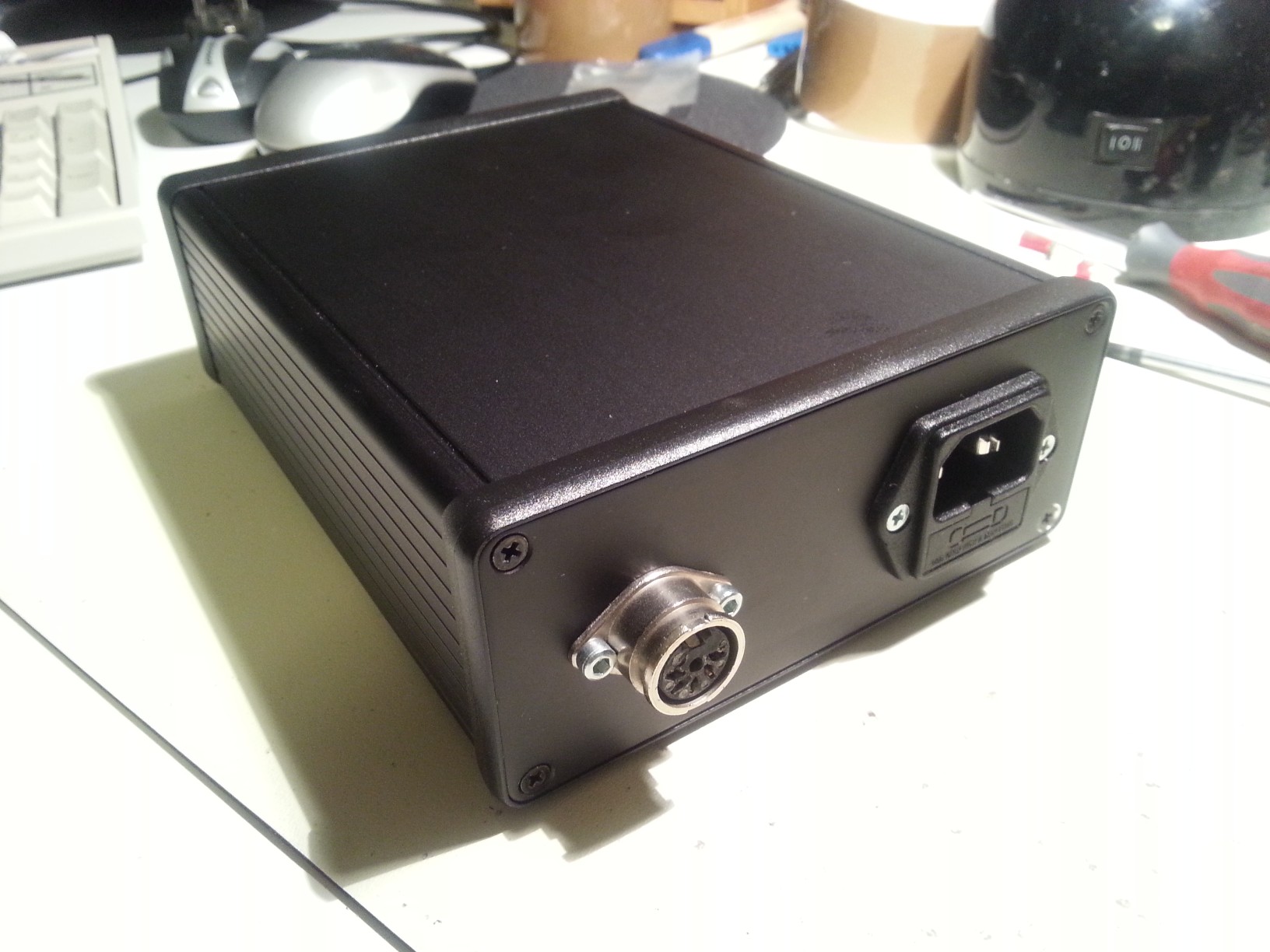

In the meantime I made a new small Powersupply for my USB-DAC (Amanero + Isolator + Curryman DAC) using the boards from the GB.
Furthermore I also changed the supplies of my RPi streaming client from a crappy SMPS to linear supplies.
So, my DAC and PSU projects are finished at the moment 😉
kind regards, Daniel

rondadon, I did order one of those cases at ebay. It was delivered by DHL Express to my door. One hiccup though, I had to pay €23,11 for German customs and VAT to the courier. And as the DHL people do not carry change or card terminals with them, it had to be paid exact in cash.
I didn't pay any import duty on my one but it had a declared customs value of only $20.
Ray

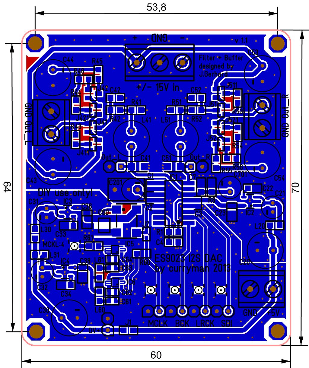

I’m trying to design a usb interface for the curryman dac with the same board dimensions so that it can be mounted above or beneath it. To connect the I2S signals I plan to place pins at exactly the same positions.
What are the precise mounting positions of the pin headers and the screw terminals? The only picture of the layout I found so far is the attached image.
Something else: Are the I2S inputs on the es9023 5V tolerant?

Maybe you can contact me via PN and I will be happy to help you with the necessary information.
I was also thinking about an input board with several inputs, e.g. SPDIF/AES/Toslink (WM8805) plus I2S for Amanero, however didn't have the time to develop such. Which USB to I2S converter IC are you planing to use?
Regarding the I2S inputs. I have a fairly old datasheet of the ES9023 which mentions a maximum input voltage of 5.5V for all 5V tolerant input pins but I couldn't find any information which pins are 5V tolerant 😱 I'll contact ISMOSYS regarding this info. Maybe someone else can help 😕

PM send regarding positioning.

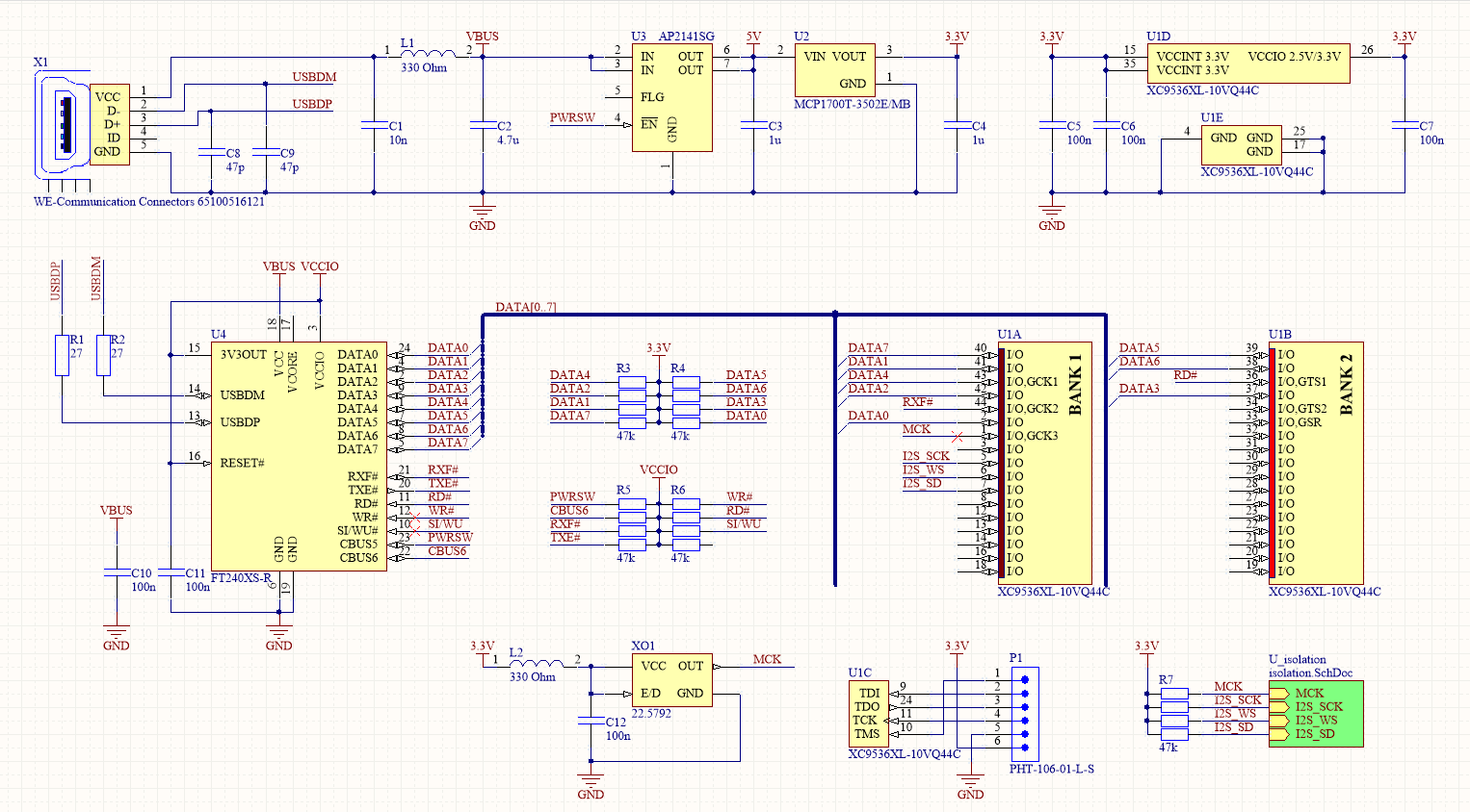

For the USB to I2S conversion I first tried to use STM32F4 MCU with my own custom firmware. It took me already 35 hours of work to get the USB audio connection working properly only to realise that I have no way to generate a precise bitclock for the I2S interface. That’s when I started looking for alternatives. I stumbled upon koon3876’s audio projects. His CPLD approach looked nice and because I wanted to teach myself HDL programming I decided go this route.
I attached the current (alpha) schematic for anybody who is interested. 🙂 Critique is always welcome.

@nanonymous
The idea of a stackable USB interface for the Curryman DAC is really nice. Please keep us informed about your progress.

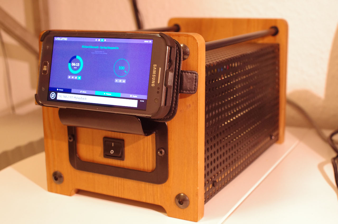

I am almost done with my Music player. Maybe I will try to put a Slot-In CD Drive into the case so I will be able to play CDs or dump them on the HDD.
Here two pictures. It's a miniITX Case. It will get small black spikes beneath.
