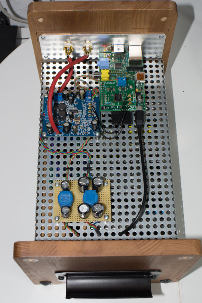

curryman DAC with RPi
Hi all,
just a small upgrade: today I managed to do some first tests with my small I2S isolator board for the RPi. It stacks directly on the Pi and provides isolated I2S outputs on either a pin header (same layout as the curryman DAC I2S header) or U.FL connectors. I used the latter for my network player setup.
Still have to upgrade the power supply (currently crap SMPS, thus the supply line filters) but it sounds already quite good 😀
have a nice sunday, Daniel

Looking very nice indeed. I was about to ask how would it be possible to use I2C with it until I noticed that there is a separate I2C pinout at the edge of the pcb. Now I want to have one...

Nice! I like the way the isolator is stackable. That will allow the whole combination to be housed in a pretty small case (which my wife will like very much...) 🙂
There is indeed I2C available at a pin header but it is not isolated! So if you want galvanic isolation you'd need to add an I2C isolator.

Temperature buildup
I too have noticed the boards run quit warm even when loaded with just one dac. Put a few together in an unvented box and the temperature begins to rise significantly. I originally had one 15v board with small heatsinks driving 2 dacs and another 15v board without heatsinks driving a single dac plus a 5v board. The ambient temp in the case reached 50 degrees after about 30 mins. The lm317 on the psu with heatsinks (driving 2 dacs) reached 62 degrees and the lm317 without heatsink driving the single dac reached 85 degrees.😎
I've now added small heatsinks to all the regulators and getting readings of 55 to 62 degrees.😉
