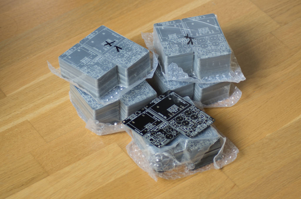

So, only to inform you: The PCBs will be here next tuesday or Wednesday. I am preparing the packages now for delivery, so I only need to put the PSU PCBs into your packages and can finally get them sent out!

Teaser
Black PSU Boards look quite nice 🙂

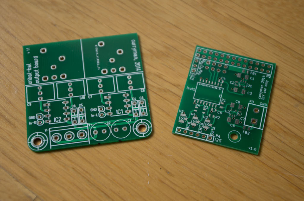

With the PSU boards also an Isolator for the RPi and an unbalanced to balanced output board where delivered. Will test them first and probably make them open source (don't want another GB at the moment 😱)

RPi isolator is nice indeed! Is that isolator a requirement when using the RPi as source?

The isolator is no requirement. Currently I am using the RPi with the curryman DAC without isolator. Work really fine.
Just makes wiring easier/better (U.FL) and - of course - provides isolation 😀 There are some reports that THD+N of DAC output is much worse when LAN is used compared to W-LAN - clearly a ground noise issue. Therefore I thought isolation might be a good idea 😱
However this has yet to be tested...

Just wanted to inform you that the first batch will be sent out tomorrow and the second batch next week. It's really a lot of nasty and boring work! ^^ . Wrapping all those PSU PCBs into paper, attach the addresses directly around the DACs and PSU PCBs.
All these small packets are being packed now in bigger karton boxes ment for shipping. And my Brother is for one week in a different place in Germany, so I can not force him to help me! ^^
And don't mind the socks in the bass reflex pipe.. It was an experiment to see how the bass behaves with a closed bass reflex pipe.
I will post some more pictures of the packets next days...
Here is one:
