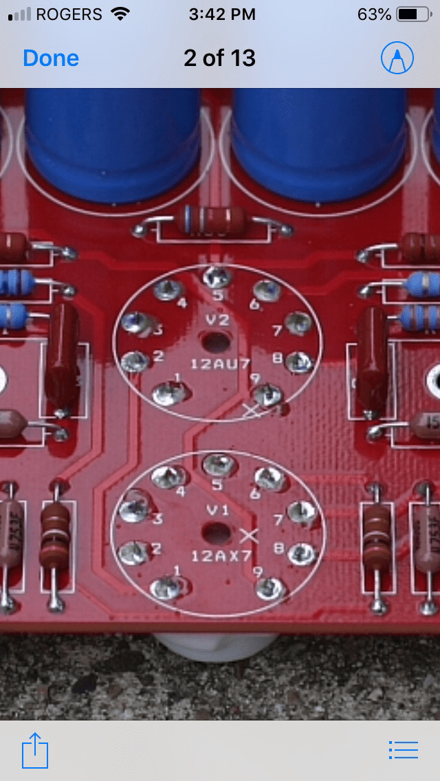

Hi Prasi
I’m wondering why the tubes sockets are on the wrong side of the PCB...this is bad but I know it’s not you that work on the original PCB.
I bought 4 of these EL84 PCBs not knowing about this...I just found out...that’s a shame.
Picture shown below is an example on how it should be, the pin number must be clockwise.

e_fortier,
Sorry to hear about the problem, but I’m a bit puzzled by the issue your experienced. I see that you ordered the EL84 PCBs at the same time as I did (https://www.diyaudio.com/community/threads/gb-for-baby-huey-pcb.312869/page-34#post-5615590). Prasi sent the PCBs marked “Rev 1.6, Nov 25, 2018” which I used it and did not see a problem. The sockets go on the printed side of the PCB - is that what you mean by “the sockets are on the wrong side”?
Most common tube amp pcb allows the builder to easily put the tubes outside the enclosure. (Look at DIYtube PCBs) This EL84 PCBs have the tube sockets on the components side which is odd. You could of course build the amp but it will have to be in a well ventilated enclosure since you have the tubes inside the enclosure.
You could put the sockets on the components side and put most of the big components on the other side.
All I’m saying is the pcb for the EL84 and EL34 should not have their tube sockets on the components side unless the silkscreen for all the components and connectors are on both sides of the PCBs.
