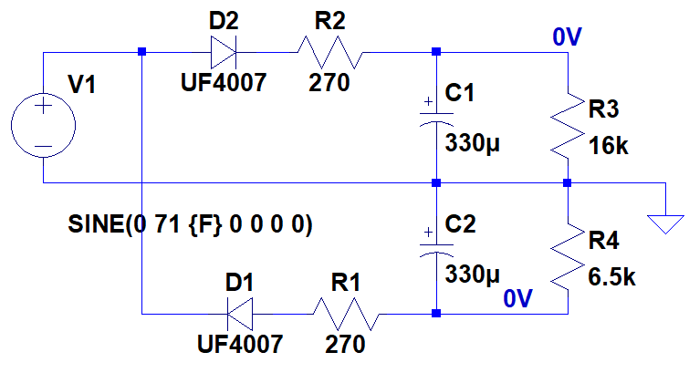

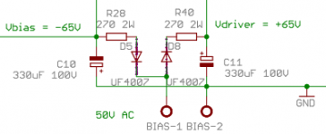

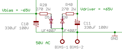

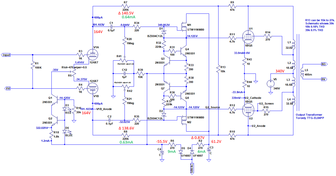

The schematic for the EL84 amp has nominal ±65V derived from half-wave rectifiers connected to the mains transformer 50VAC secondary.
My simulation says that ~4mA is drawn from an ideal +65V supply and ~9mA from than ideal -65V supply.
Plugging those currents into a simulation I get 0.2Vpp ripple on the +65V supply with a mean of ~60.74V and 0.4Vpp of ripple on the -65V supply with a mean of -54.3V.

Isn’t the constant current source on the input differential pair sensitive to noise on the negative supply?
How about ripple on the bias and negative rail of the source follower CCSs?
Thanks.

50Vac means around 35Vdc, not 65.
CCS have high impedance so high rejection to noise.
You only need 1.2 mA more on the negative rail (PI's current)
I guess you have overdone something in your simulation, and ripple is way better.

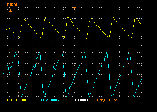

I’ve now tested one of my EL84 PCBs. My measurements are very close to the simulation results in my original post.
The first image shows the schematic with my measured voltages and currents. HT is 340V regulated.
The second image shows the positive and negative rails derived from the 60VAC bias supply.
As predicted by LTSpice:
Interestingly, there’s no ripple on the output transformer secondary. There must be some cancellation going on in the output stage.
I need to do some frequency and noise measurements on the desktop computer with the fancy sound card but my breadboard power supplies aren’t really moveable to my study.
Anyway, in my final build I’ll regulate the bias-derived supplies down to ±35V.

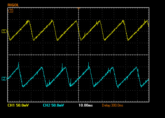

- The voltages are -55.5V and +61.2V.
- Positive rail ripple is ~200mVpp and negative rail ripple is ~400mVpp.
- Positive rail current draw is 4mA and negative rail current draw is 9mA
Yes, the B+ ripple is common mode. They cancel out in the output transformer as long as the two tubes conduct the same.

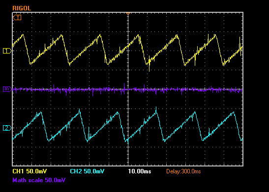

Thanks Chris. The noise is common mode on the output tube grids rather than the B+. It is generated by the preceding LTP because of the half-wave rectification and filtering of the -65V supply on the LTP CCS.
Here's a screenshot of the LTP anodes and A-B showing the perfect cancellation of the noise induced by the noisy supply.
The second image shows the ±65V supplies again.
Dave.

Having said that, a cleaner supply will allow it to perform better. Especially if the sharp sawtooth were to be filtered to be more of a low frequency sine wave.
