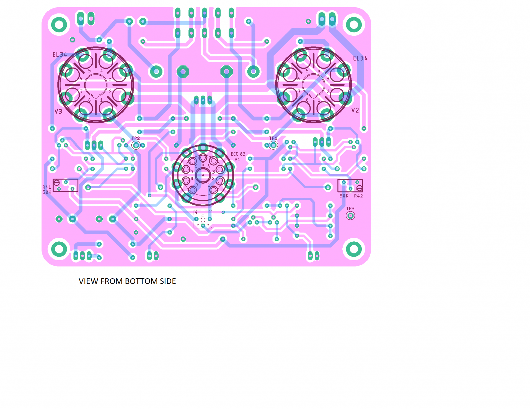

Eric,
Yes, silkscreen both sides of the PCB might be useful, but as is Marc and Prasi’s PCB is not a problem. Simply place all the tube sockets, small resistors, semiconductors, etc on top (where you have the silkscreen) and the few large caps under the PCB (observing polarity, of course). The small parts are small enough to fit easily between the top plate and the PCB, attached with suitable stand-off spacers. The tubes are sticking through holes in the top plate. See for example Bas’ nice thread on how he built it:
https://www.diyaudio.com/community/threads/oh-no-not-another-baby-huey-el84-build.351919/

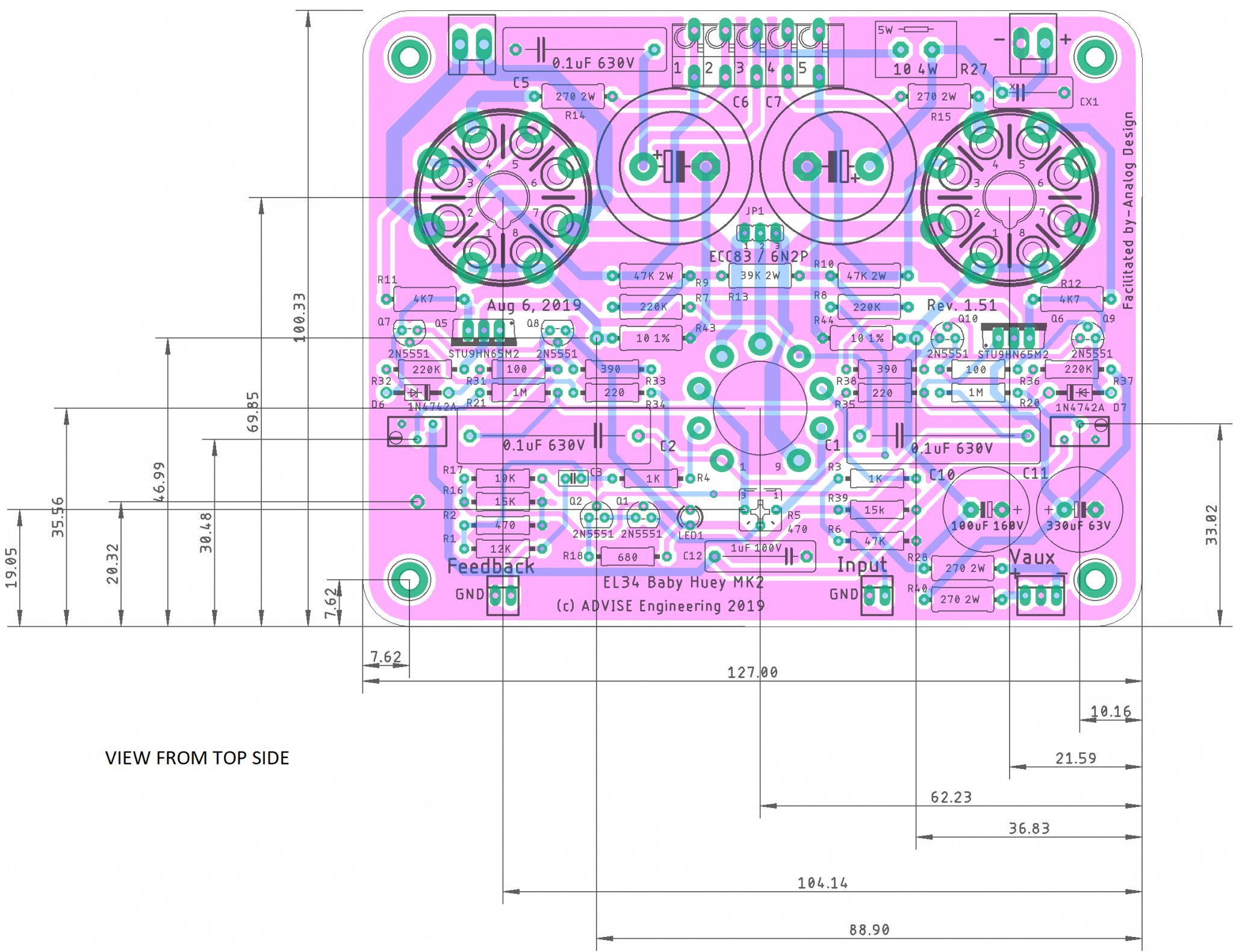

You can solder other parts on other side.Hi Prasi
I’m wondering why the tubes sockets are on the wrong side of the PCB...this is bad but I know it’s not you that work on the original PCB.
I bought 4 of these EL84 PCBs not knowing about this...I just found out...that’s a shame.
Picture shown below is an example on how it should be, the pin number must be clockwise.
BR
Eric

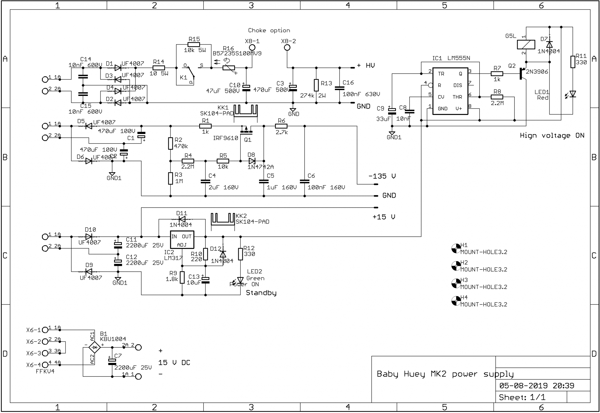

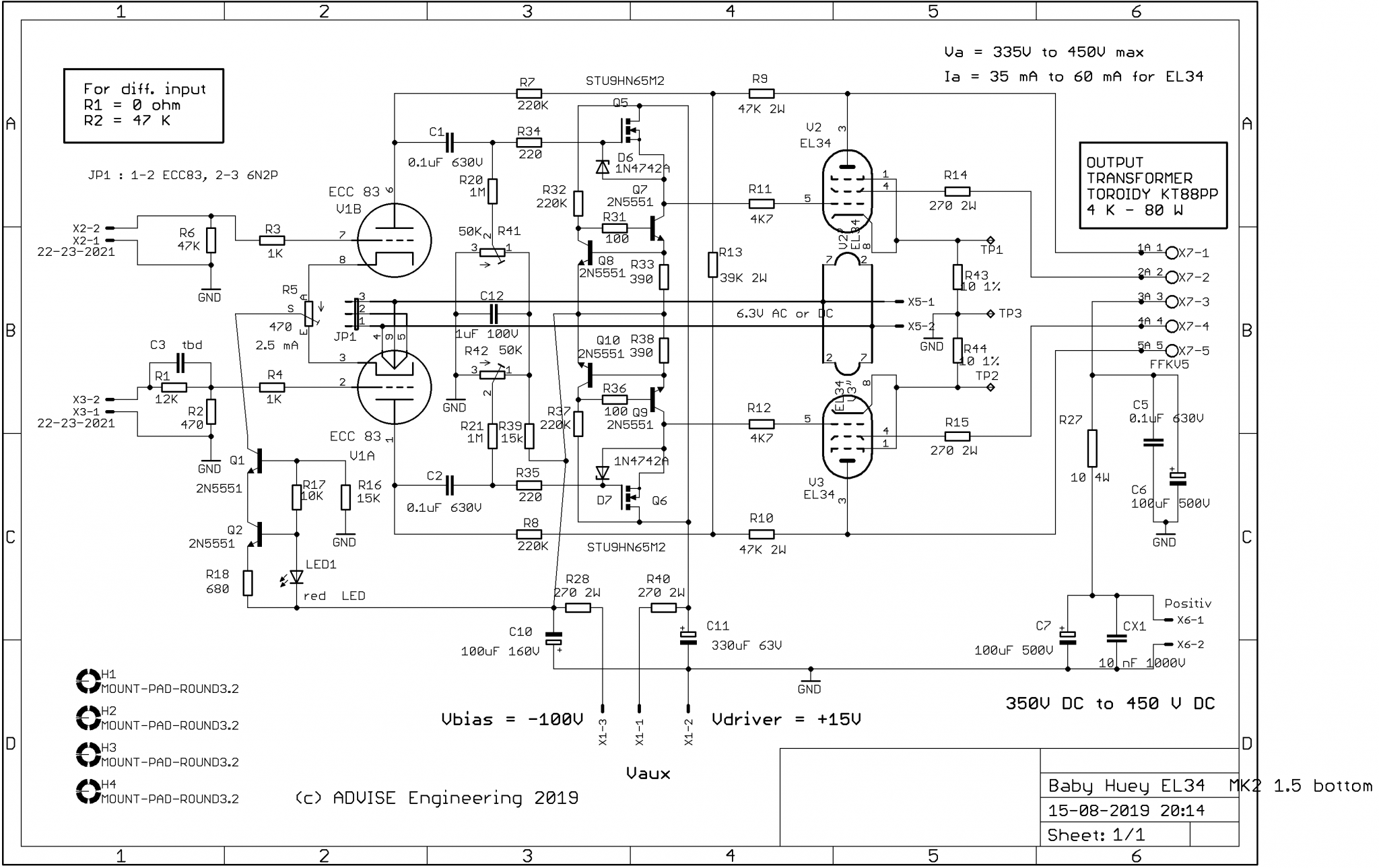

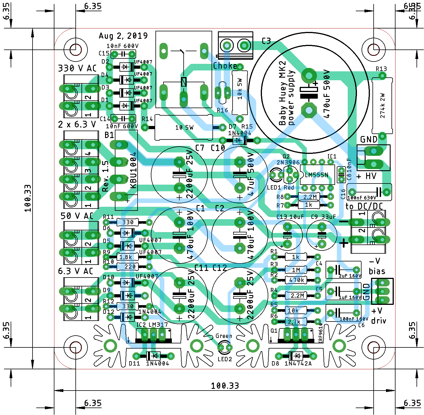

Hello Ranko,
here baby huey mk2 and its psu for your reference.
regards
prasi
regards
prasi
Nice work Prasi.
To make it easier to build I would add 5 small holes in the pcb. One in the Center of each tube and the 2 others where the screw of each of the trim pots is located. I’m aware you provided a illustration showing the dimensions but it’s much easier to know exactly where to punch the openings when there’s holes in the PCB.
Just an idea,
Eric
Just an idea,
Eric
