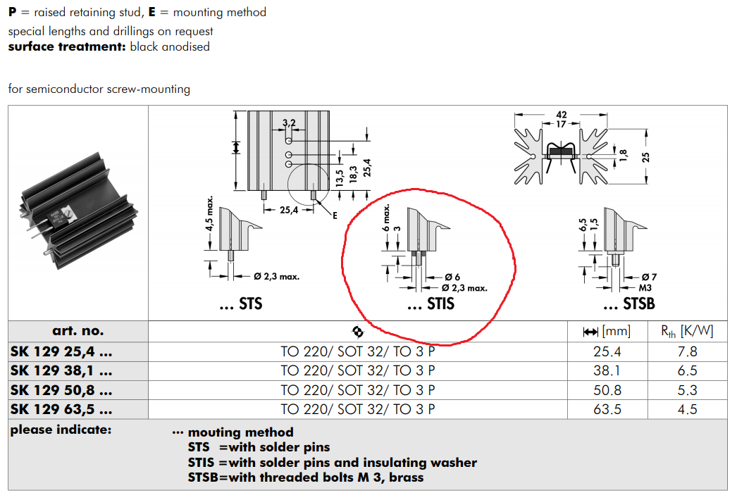

Prasi, I have a newb question about heatsinks for CRCRC board.
I saw (Use insulator below diode Heatsink) typed on the boards.
Is it so heatsink would be a bit lifted to not to heat the board?
Should the type of heatsink like on this picture fit better?
Hello Rainfallsky,
Yes, those are perfect.
The purpose is to insulate the bottom of heatsink rubbing away the solder mask in the long term and touch any vias.
One could also use following options
1. 1-2 layers of kapton tape
2. Plastic washers on the heatsiNk solder pins
Regards
Prasi
