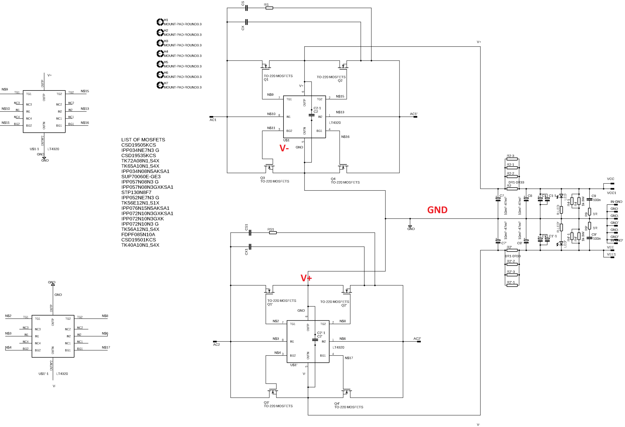

Here are the schema and BoM for both versions of the ideal bridge rectifiers.
ver1. without AC snubbers (smaller PCB- 21.5mmx30mm)
ver2. with AC snubbers (bigger PCB- 25mm X 30mm)
I was unable to include these in all the packages as I ran out of rectifier PCBs.
The BoM attached is for the rectifier with snubber components.
I had in mind , the SQJB00EP mosfet , which is will generate about 10mW/ amp more than the mosfet you suggested above. Still should work well in the design.
Regarding the LT4320 package, I have incorporated options for both DFN as well as DIP08 package. Only those who are good with smd soldering may attempt soldering DFN package.

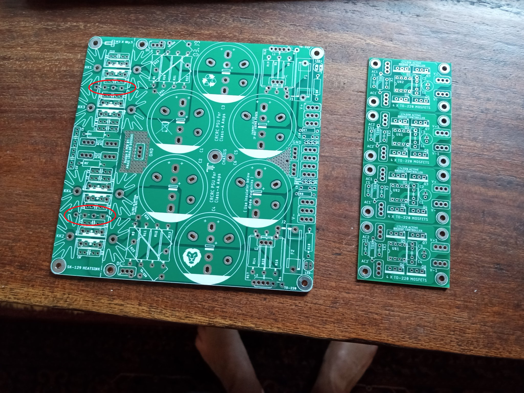

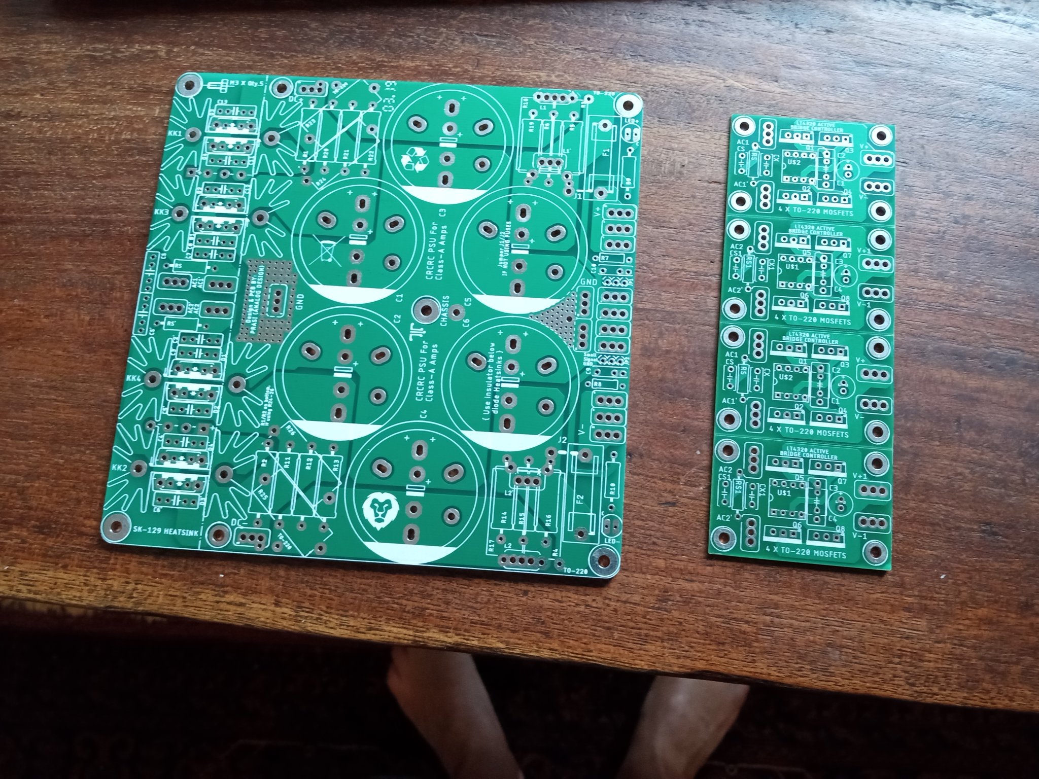

hi kokanee,
unfortunately, those are THT rectifier pcbs and those wont fit directly on the CRCRC PSU PCB, although one can run wires from THT rectifier output to the CRCRC DC+ GND and DC- pads marked on the pcb.

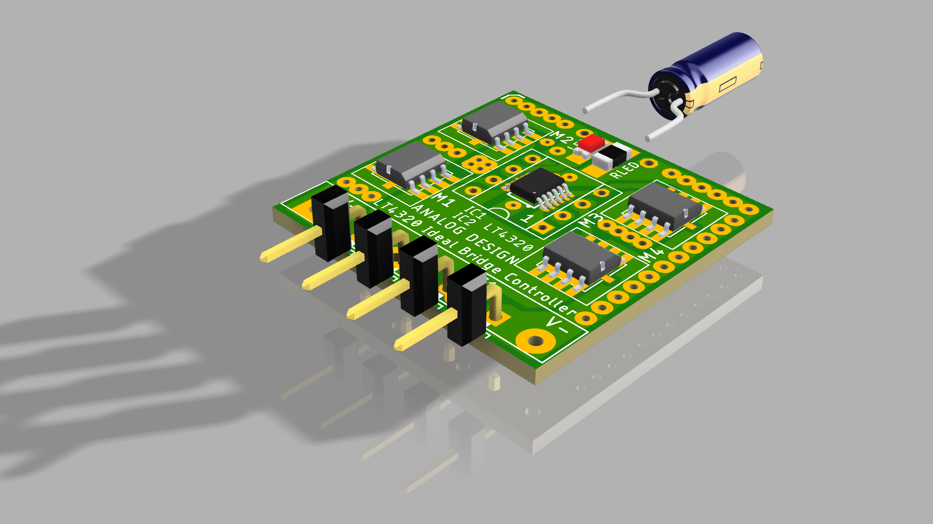

If you also have the SMD LT4320 rectifer PCBs, then assembled pcb can be mounted directly in 4 holes marked in below pic. Also attached is the 3d model of the assembled smd lt4320 rectifier.
hope, that makes it clear

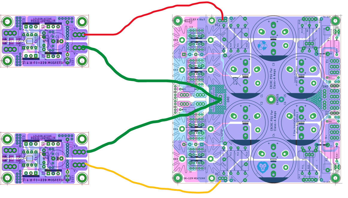

Thanks for the reply. Is the THT rectifier pcb output V+ and V-. ? If so, would one run 3 wires from V+ and V- to the DC+ and DC- on the CRCRC. Maybe you can mark up the pics to illustrate. Thanks.
V- of the positive rectifier and V+ of the negative voltage rectifier are connected together to form the ground and connected to GND TAB of CRCRC.

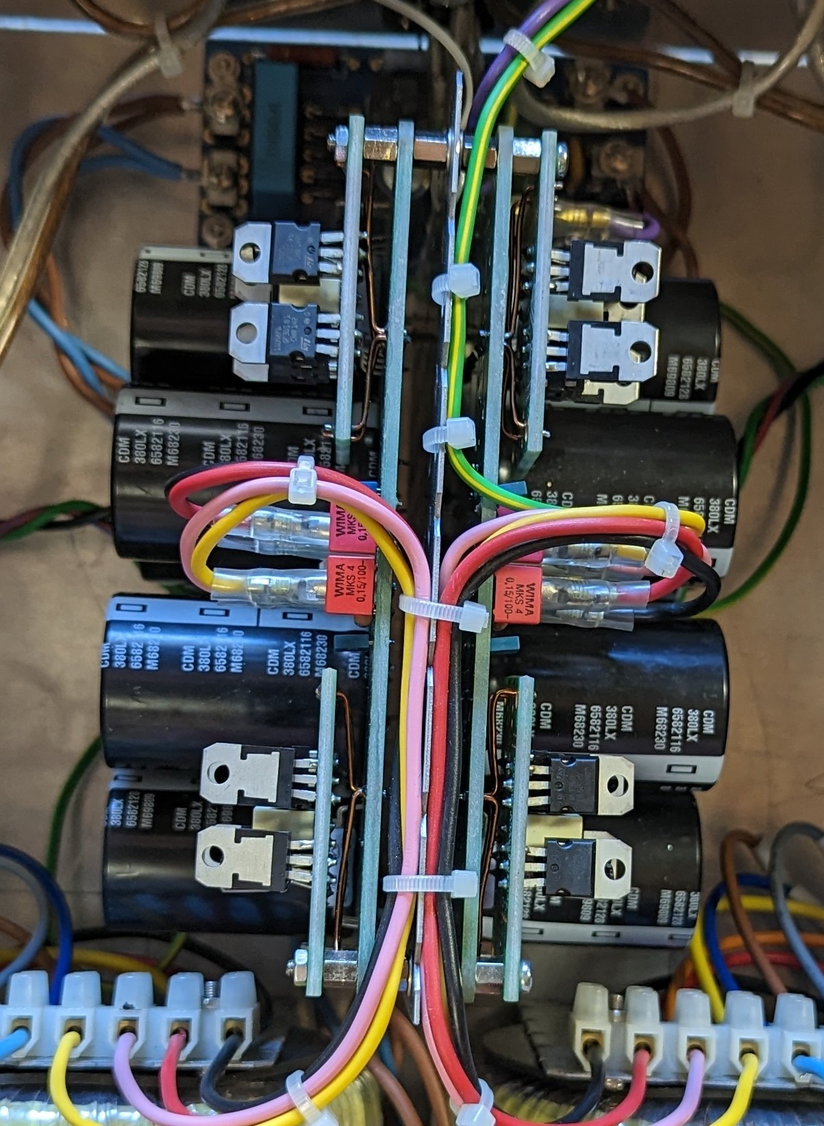

Kokanee, here's what I did to mount the boards, it may be of some help to you. Utilising enameled copper wire, of course.
