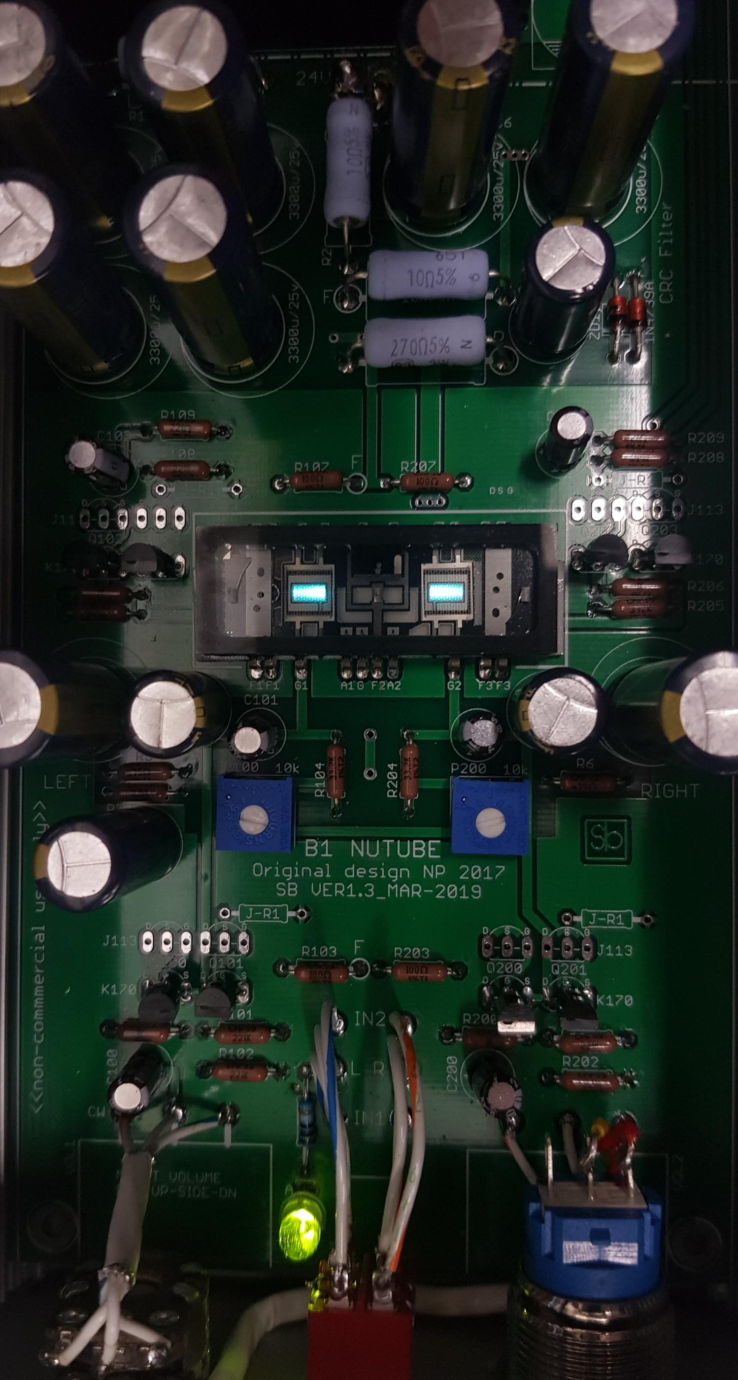

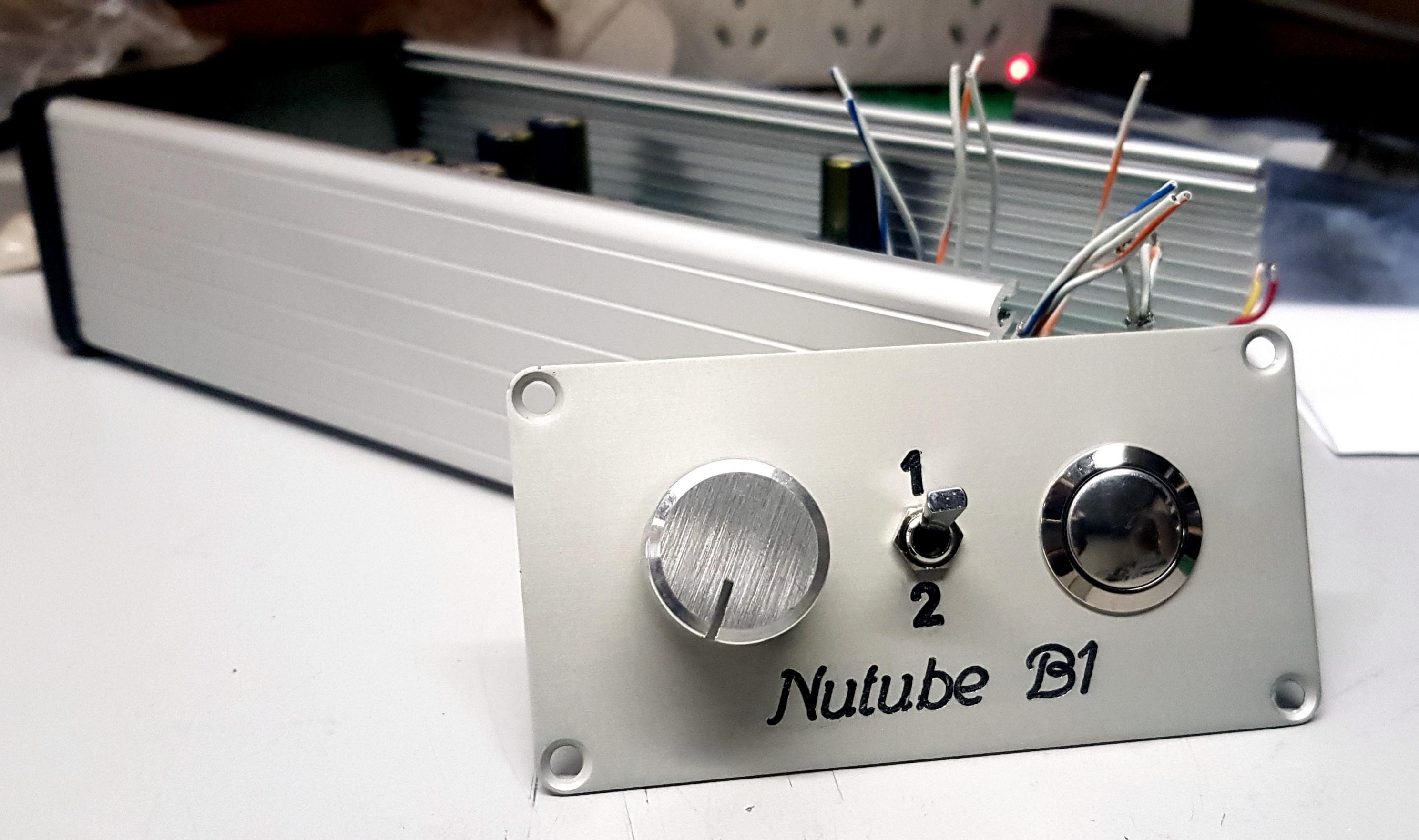

A little preview of my build.
Waiting for some RCA sockets as I ran out :rolleyes: so I haven't heard the magic yet.. although it fires up without smoke ;)
Chassis front was done on my homebuilt CNC and I have made a windowed top cover in white+clear acrylic. Not sure if it'll look good or not yet..
I ended up cutting the track by the 24v insertion point so that I could switch off the DC side. The resulting connection isn't as pretty as I'd like, so I might revisit that later and bond a new pad where I made the hole in the PCB.

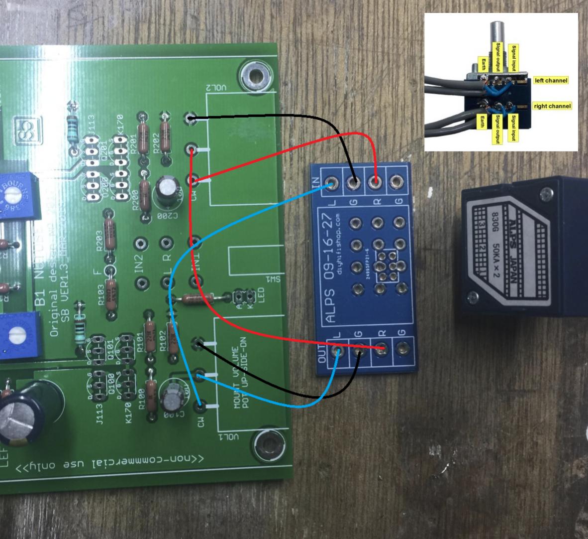

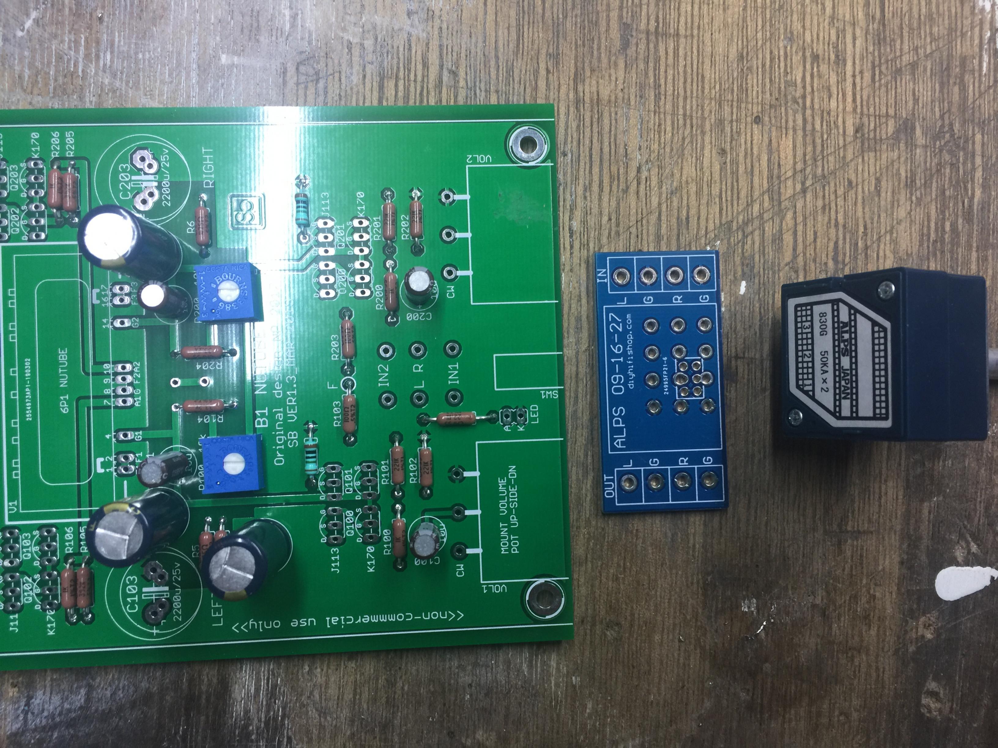

Hello,
Could I get a bit of advice on wiring an Alps pot to this wonderful pcb? I bought the pot with a nice little pcb to aid wiring. Just not sure how to connect to the 2 sets of 3 pads on the amp board. So far I get the left right bit;)
Thanks!
