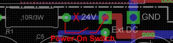

I was intending to break the line between the 10R/3W and the 24VDC feed pad and insert a switch there but that will still leave the 230VAC connected so I haven't decided what to do other than yanking the cord each time.

Hi GASCo. Here answers to your questions:

-The front switch is only for input selection (In1 or In2), the pcb is always powered, there is no power-on switch.
-One solution as some suggested, is to use the +24V TP and R1 resistor leg to add a switch, see picture. Simply cut the bottom trace between the 24VTP, and the indicated R1 resistor leg and add a siwtch there. It will disconnect the 24V Supply from the CRC filter and preamp. Indeed the 24V SMPS will stay On, and well as the smd part, but that can be view as a standby mode, supply stays On, when the preamp is off...
