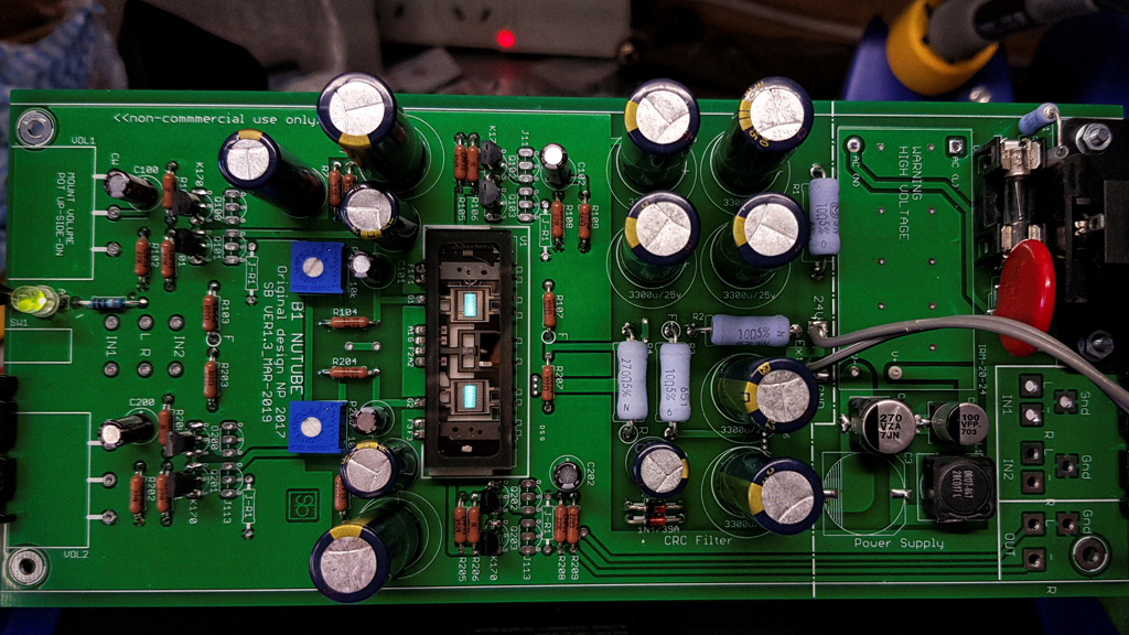

Hello all. I'm going to use a remotely mounted IEC power input connector (likely this part number 693-6100.3300) so I can wire in a double pole switch for the AC supply. Should I try to keep this power switch addition at the back panel end to keep the AC noise away from the B1 amp stuff? Or can I run twisted wiring up to a front panel mounted power switch? Thanks.
AC is always best kept well away from the signal so I would personally keep the mains at the rear, but that's not very convenient.
Will you be using the Hammond chassis specified in the BOM? There isn't a great amount of room to allow for separation between the wires and the board.
It may be ok so perhaps lay it out without the front and back panels and see how it sounds. It won't be a great hardship to switch to rear mounted then if it is too noisy.
In that case, you should be ok to run a switch to the front.
Take mains along one side of the chassis and any inputs on the opposite side and leave a decent space between the wiring and the PCB and it will probably be ok.
When using a wooden chassis with a mains carrying switch, I normally connect the switch body with an earthing cable to IEC GND. I just don't trust mains switches enough to not end up live at some point due to an internal fault..
*Edit* I also fuse at the inlet to the chassis, before the switch.
Please share some photos of your build, laser cut ply sounds interesting!
C13 is missing from the 28 Feb BOM by the way. Make sure you order an extra cap same as C10, C11, C12: 1000uF, 16V, Panasonic FC Series EEU-FC1C102S (or whatever series you chose)
