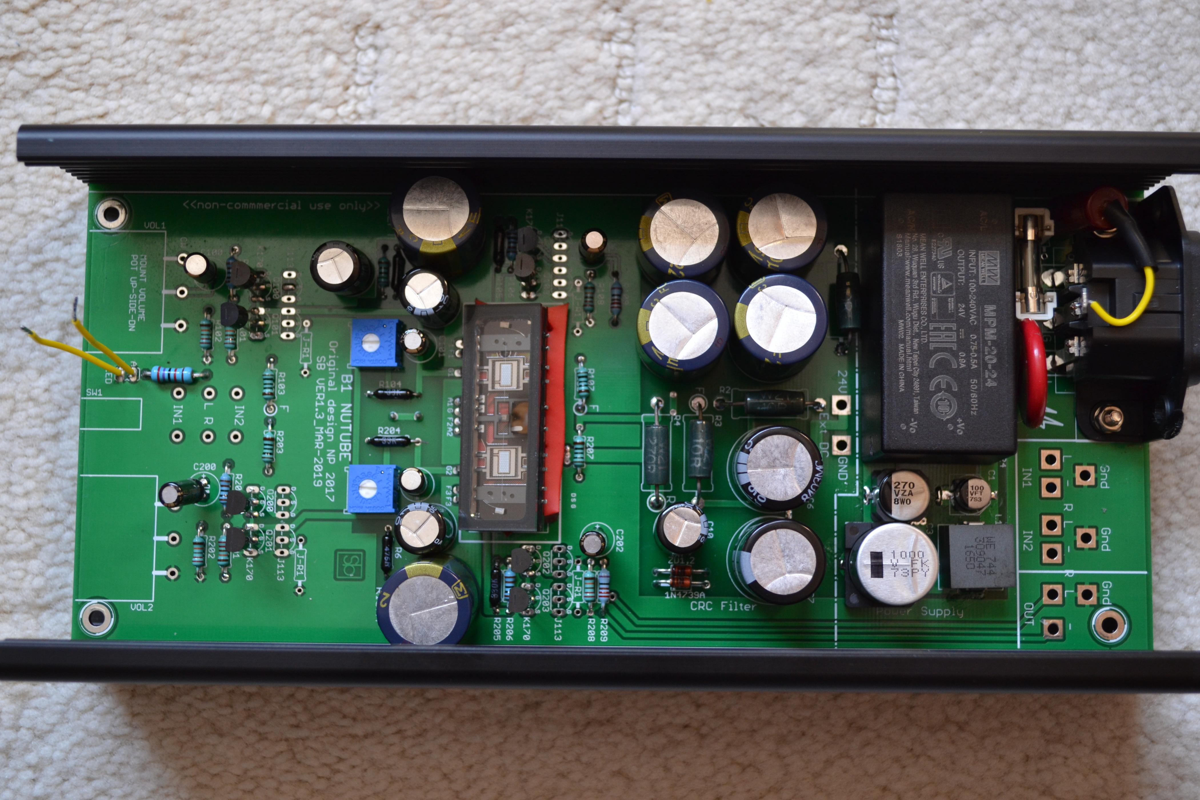

Do you have any photos Marra?

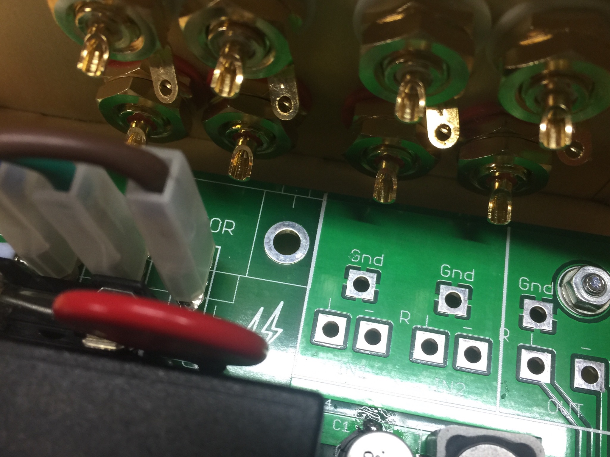

Is there any contact with the component tails and the chassis? Move the board up a level temporarily while you test.

Your build looks fine, I can't see anything obviously amiss when comparing it to my build photos.

I cannot see anything being in contact with the chassis and initial check was done out of the chassis.

Whoops 😱. Staring at the back of the board I realised that I had soldered the wire link between C202 and R209 and R208 at the wrong end of the two resistors😡. What damage and to what am I likely to have caused bearing in mind that the voltage will still not settle. On the up side the led I installed actually glows.
That would short out the RH channel output to ground via the negative side of C202.
Check Q202, Q203 for damage for a start. You should be ok to remove those two and switch on to check voltages.

I removed Q202/3 and both check out ok still reading 6.77mv idss. Powered up I am still having the same problem with the p/s fluctuating although it does now slowly rise.
Do you have a pic of the bottom of your board too?
Does the voltage stabilise at 24v at all? How long does it take?
Unfortunately it doesn't reach 24V . I only let it get to 12.5V before turn off but it took a couple of minutes. I made a mess of the back panel s0 made one out of 3mm acrylic which is why there is an earth wire soldered underneathnready to attach to the chassis base. A bottom view. I much appreciate the help.
