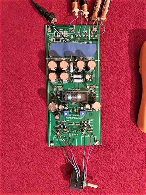

Finally got around to finishing the PC board and had to quickly give it a test run before installing it into a case. Powered right up perfectly. Set bias to 10V and I'm now listening to wonderful music.
Thank you Sylvain for designing this unique board and for the group buy. Thank you JeffreyJuice for the JFETs. And finally, thank you Nelson for sharing your exceptional creations with the DIY Greedy Boyz.

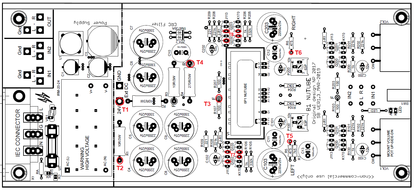

Hi all. I was wondering what the equivalent test locations are for measuring the voltages T1 to T8 described in the original Firstwatt article ?
