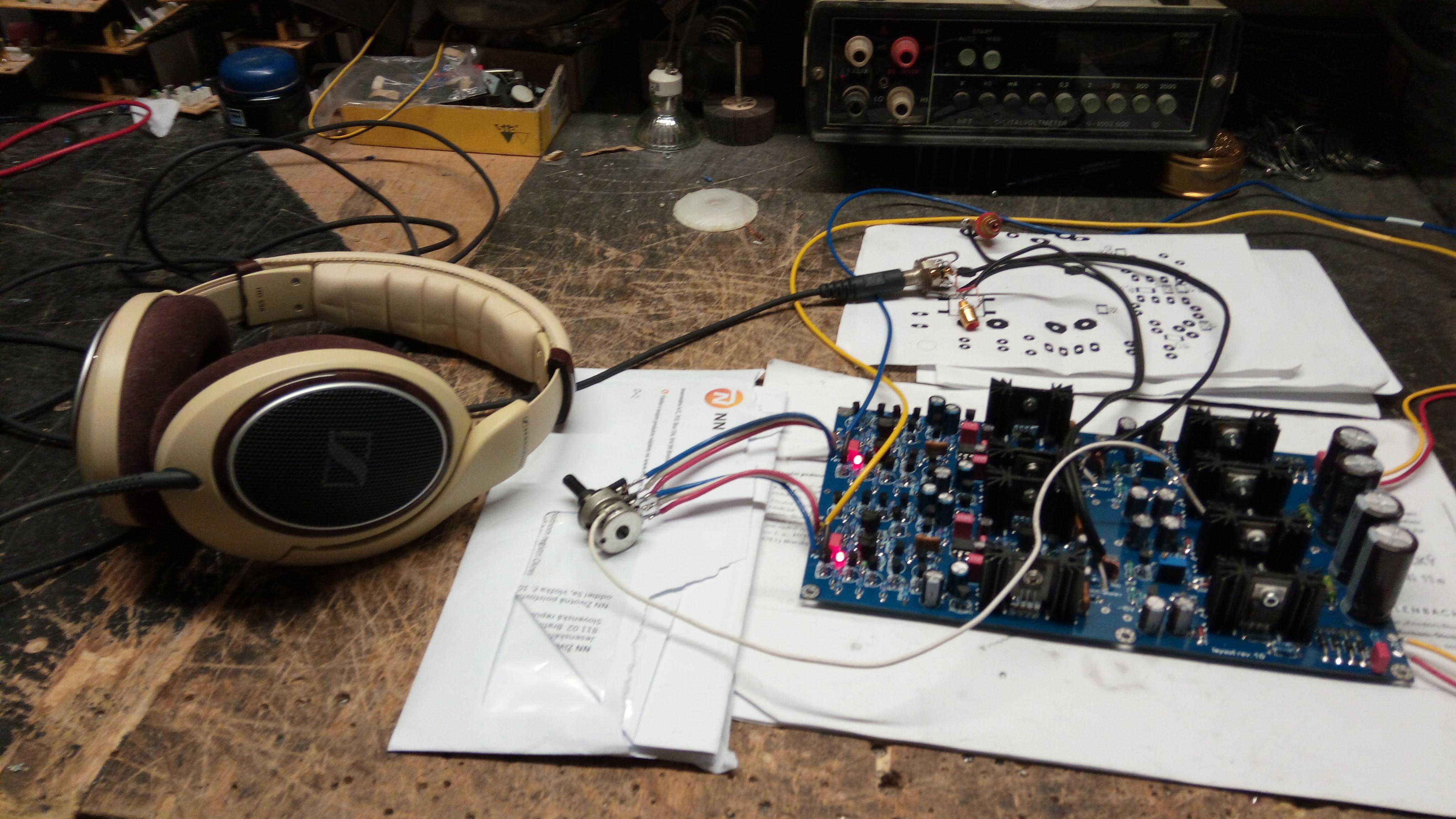

Headphone test.No.1

Awake again, we'll see . Hmmm the sk170 are obsolete but they cost 3.24 € good that i did not buy those when they where available would really pissed me off 70€ for fakes .
From my exp. The cheap transIstors sa1015,sc1815,0,042€bc556b,bc546b looks like diotek bd139,140 cdil
sa970,2240 not fakes but.looks like diotek or cdil.
Peakatlas pro75
Bc550c bc560c onsemi lowest vcesaturation 0.019
Philips genuine silver plated vce sat 0.022
Fairchild 0.022 - 0.024
Cdil 0.027
Fairchild bought from mouser, cdil from reichhelt just to test
Onsemi,philips from 1993 to 1995 from yleiselektroniikka.fi
Looks like onsemi is a winner .
bc33740ta fairchild has low Vce (0.005V) measured with peaktech dca75pro.
