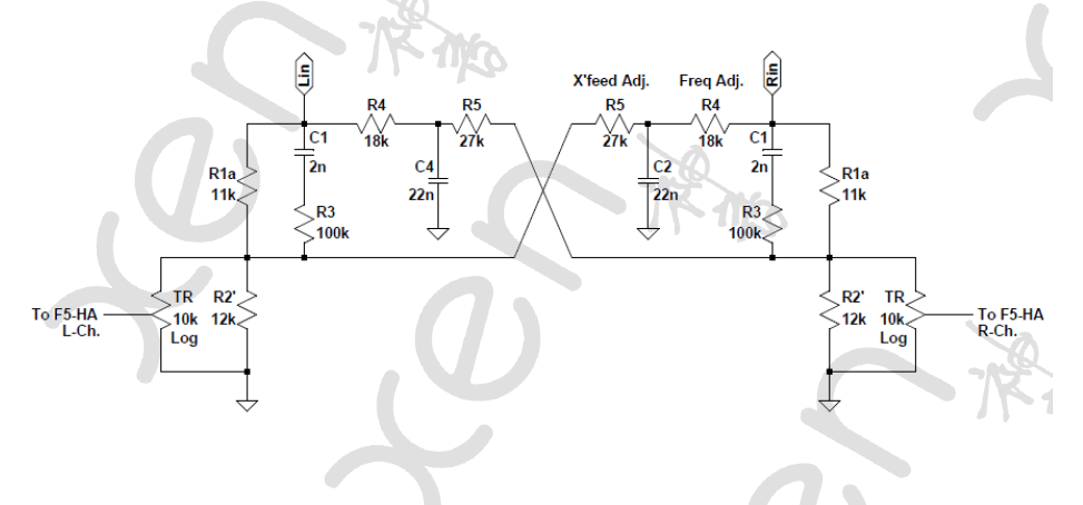

Damir,
I just built an F5 HA with a passive cross-feed filter and volume pot integrated as part of the filter. The cross-feed effect is subtle but makes a huge improvement in sound quality - just sounds more natural. I am not sure if it is because the 10k volume pot is part of the filter, or is it because of the the F5HA's inherently low noise performance (dead silent) but my basic $5 stereo pot (I think it is an Alps, but not sure) is velvety smooth and no gritty or hash sound when changing volume (actually cannot tell it is rotated with no input). I am quite impressed with this volume arrangement. It presents a 5.5k ohm input impedance.
Passive cross feed filter (modified Danyuk/Linkwitz cross-over):
diyAudio

Here is schematic from above attachment:
578294d1478268416-gainwire-mk3-cfa-pre-phone-amp-very-low-distortion-f5ha-cross-feed-filter.png

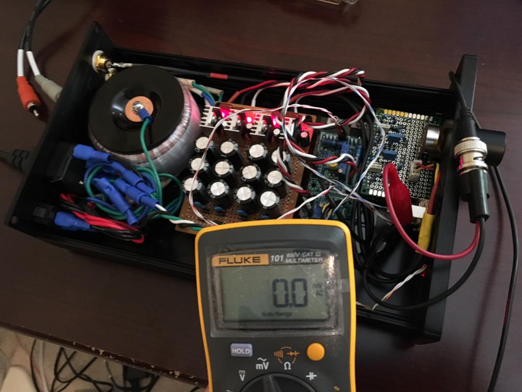

Here it is implemented in my amp - I measure 0.0mV noise on my Fluke with no inputs and volume turned to full on (or anywhere in between):
Anyhow, just thought I would offer this as a cost effective option for others to try. It may require adjustment of the input impedance setting on the front end of the GW Mk3 though to be compatible.

My opinion is that digital potentiometers are not good enough, the GainWire mk3 preamp has much lower distortion, only passive resistors attenuators are good enough, even best dual potentiometers as Alps or other kind have to big differences between tracks.
xrk suggestion is not for this preamp as it's cross feed was meant for headphones only and not for line preamps and this one is manly line preamp with headphones drive capability.
By the way I tried (some time ago) different cross feed network used to get phones sound out of one head, but was satisfied with no one.

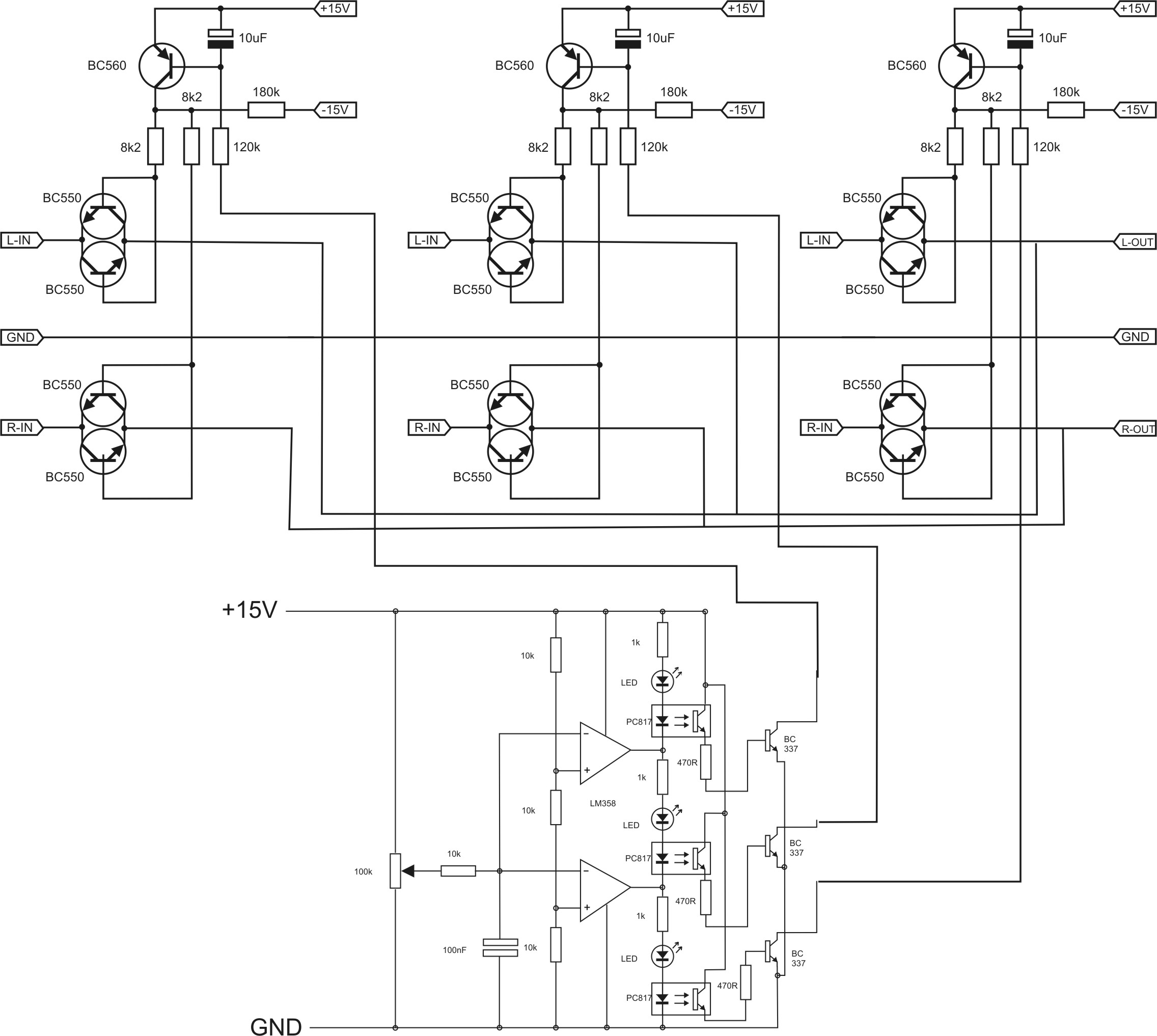

This preamp uses a lot of BC550's - and they are great high fidelity transistors. Could one make a 10 bank parallel analog switch using BC550's as described by Apex Audio, each one provides one "bit" of resistance and you have a 10-bit (1024 steps) digital volume controller that uses at most, 10 parallel paths through a pair of BC550's?
A JFET version could be made as well - I am told a single P channel JFET can do the job of a pair of BJT's.
So expand the above diagram to 10 banks, and use an ADC converter to change an analog voltage from a pot to a binary coded combination to activate the high fidelity analog switches.
You can even get the ADC to do a log conversion for log volume pot or use a log pot on the ADC.
