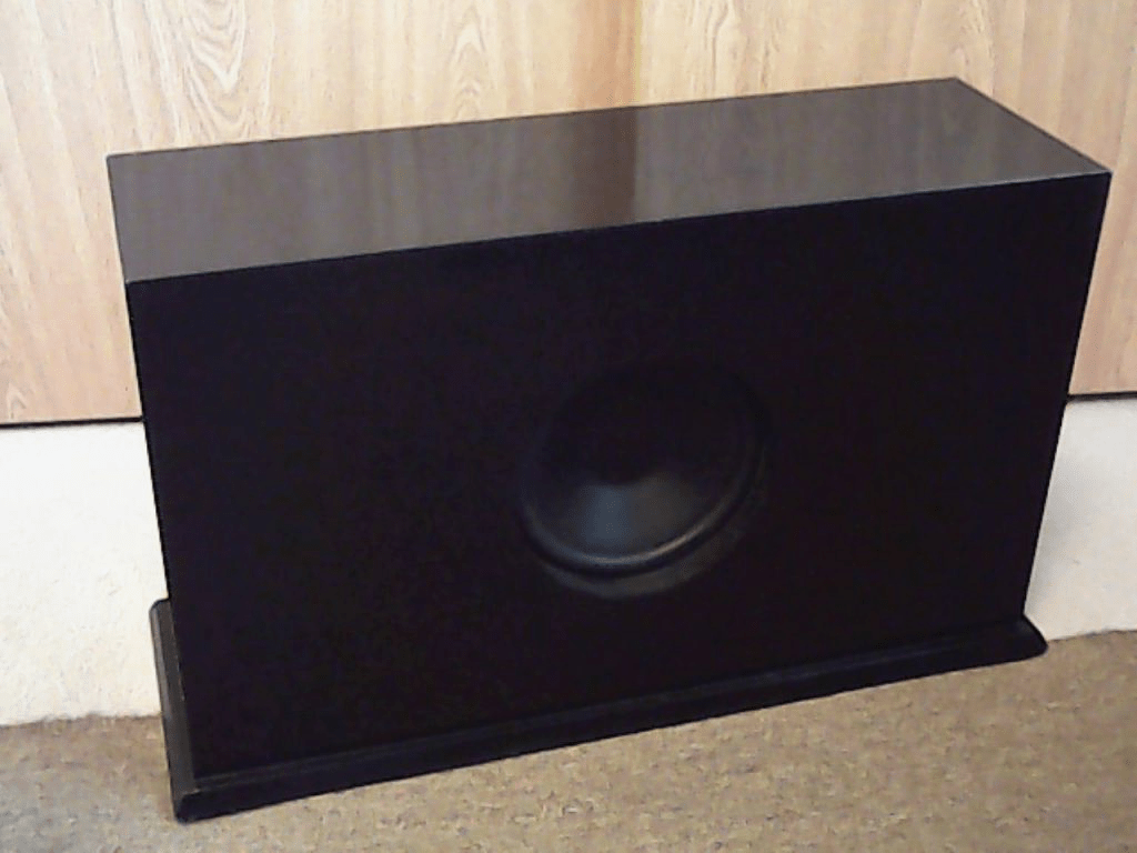

GRS 8SW, 8" Subwoofer
https://projectgallery.parts-express.com/speaker-projects/basic-subwoofer/
1.8 cuft box 5/8" 26"x16.5x9.5 Sealed

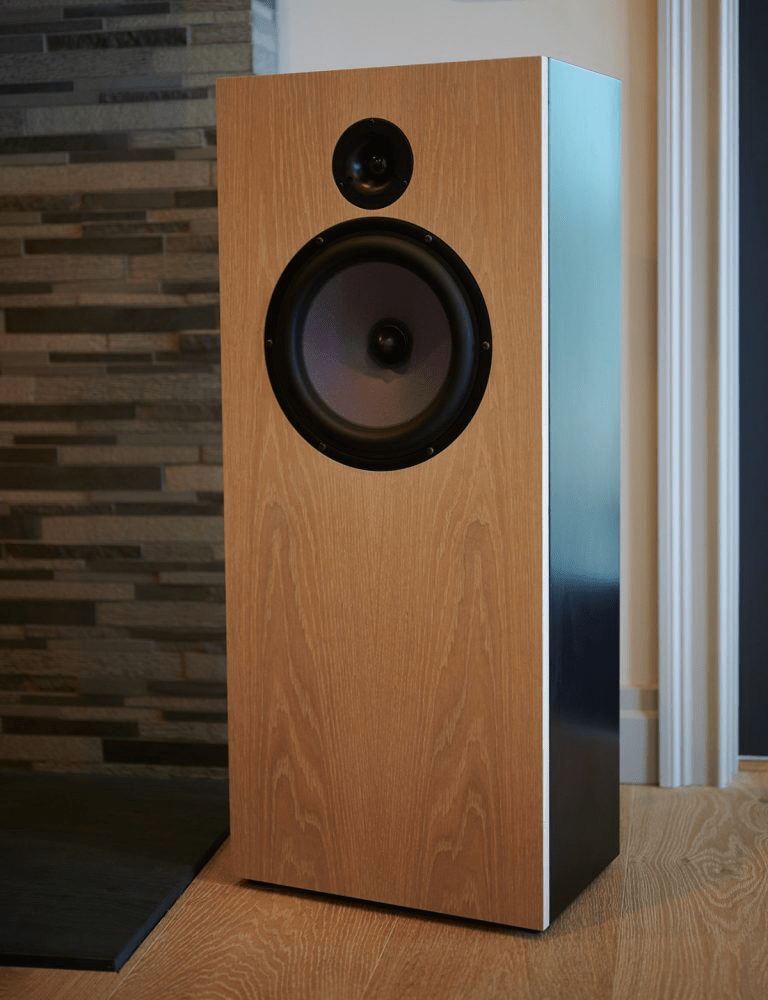

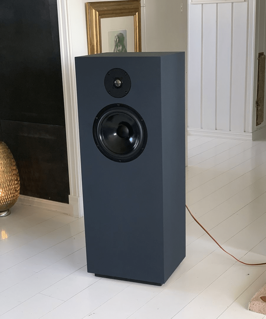

Present day:
Devore Orangutan 0/93 nice plywood baffle
DEvore 0/93 Dimensions: 35.5″h x 15″w x 10″d

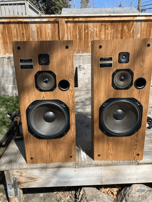

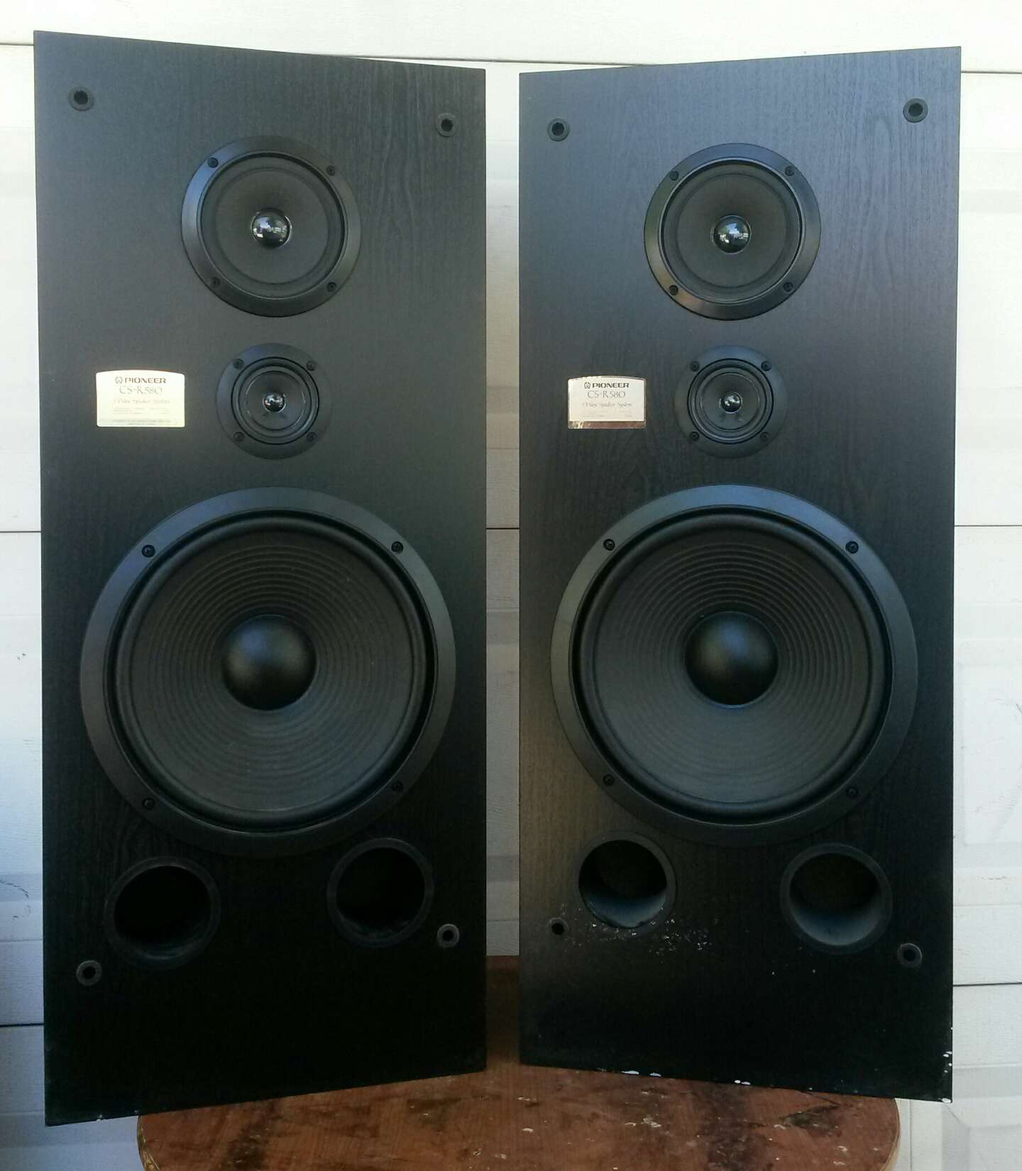

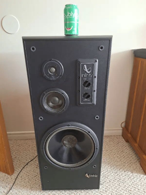

Past days (before Devore)- some floor standing speakers:
Found locally on Kijiji
Coincidentally (?), similar size.
Pioneer CSG7000
35.5"h x 15" w x 11 5/8 d

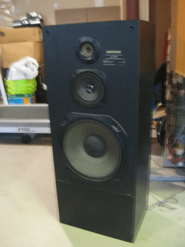

Kenwood Speakers
36" h x 15" w x 11" d
Infinity SM122 Tower speakers
35.5"h x 15" w x 13" d
One could acquire (reuse) an old 35" x 15" x ? speaker. Figure out your box volume requirements. Add braces, damping, stuffing, new front baffle (wood? paint?)
One could even make a 35.5″h x 15″w x 10″d box.
Example of a painted baffle-

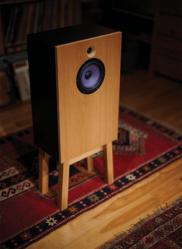

Funny- $1000 pr - Oak Stands (go to the High School woodshop, "Hey kid copy these...." )
Devore Orangutan O/Baby
Dimensions: 35" (889mm) H × 14.75" (375mm) W × 9.75" (248mm) D (including stands).
https://theaudiobeatnik.com/devore-fidelity-orangutan-o-baby-speakers-review/
"Like the O/96s, the O/Baby speakers need stands. They are $5,600 without stands. You can use them with any 12-inch stands, or you can get solid oaks stands from DeVore Fidelity, that is a mix of Japanese and mid-century modern. While these are expensive at $1,000, when combined with the speakers, they make for a very eye-popping look."

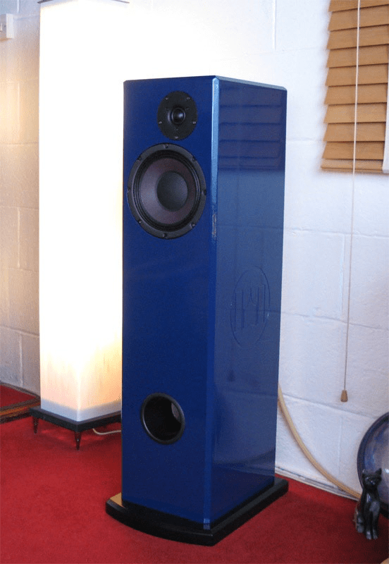

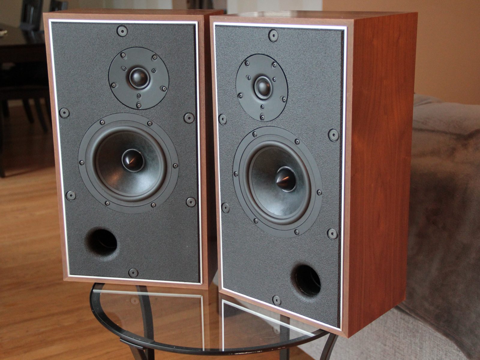

PI Speakers - alternatives.
These speakers have the SAME crossover. 1Pi & 2Pi (woofers are not running full range-Not Clones of Devore)
https://audioroundtable.com/forum/index.php?t=msg&goto=92680&&srch=1+2+pi+crossover+same#msg_92680
per Wayne P. message 92679 , "The one pi and two pi use the same crossover and tweeter, but the midwoofer, box and port are different."

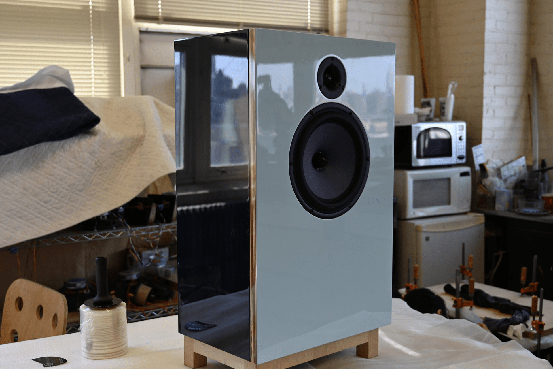

Paint Job
https://audioroundtable.com/forum/index.php?t=msg&goto=50705&&srch=derek+pi+one#msg_50705
Paint job was done with gloss paint and a roller!!!!

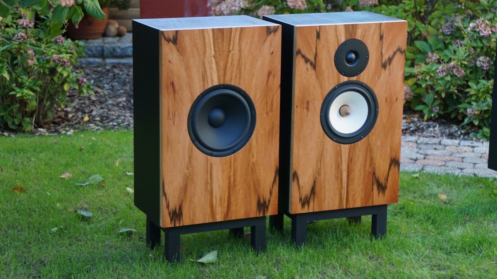

A Wide Body, 7" Seas CA22RNY Kit- looks Nice but no NIce plywood baffle.
https://www.seas.no/images/stories/diykits/aphel/DIY_kit_SEAS_Aphel.pdf
"The enclosure was chosen to be a big 55L box with a wide baffle and a port tuned to 36Hz.
1.95 cuft 55 litres, hwd 860mmx330x280 or @34”x13x11
Port D 70mm x L 60mm

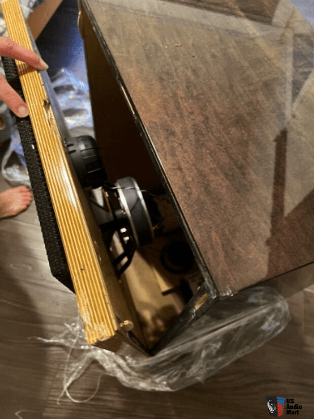

Looking for alternative speaker boxes. For reuse Post #23 & #27
from post #7

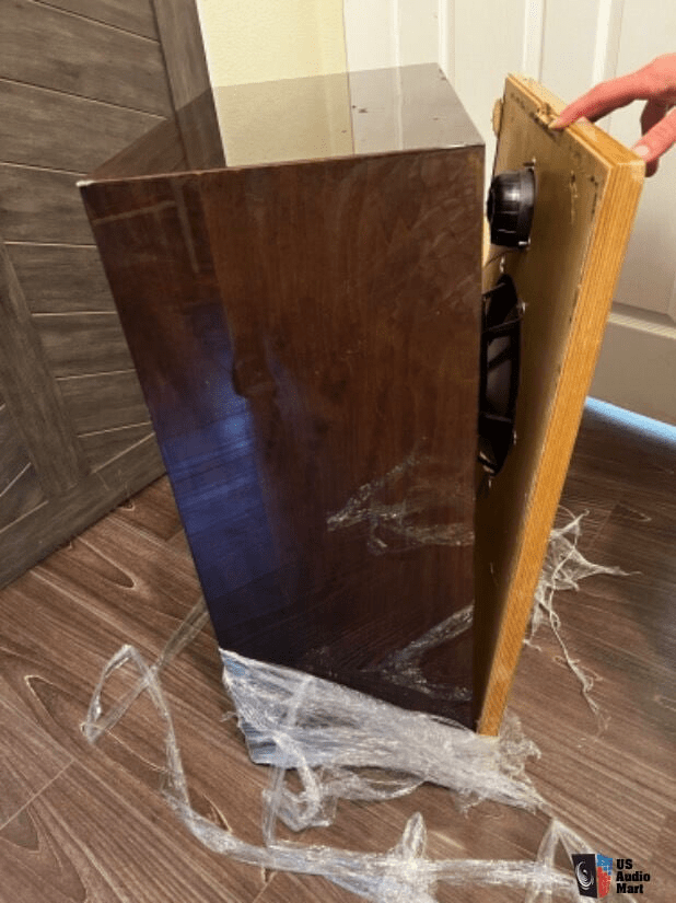

Devore Orangutan 0/96 (short speaker with stands)
$20,975.84 CAD
Dimensions: 35.5″h x 18″w x 12″d including stands
The cabinet measures 28.25" high x18" w x 12" d

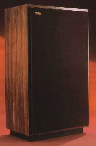

https://www.humanspeakers.com/e/epi-te320.htm
similar size-EPI Time/Energy 320
hwd 29x17x10.5
Devore Orangutan 0/93 (tall speaker- no stands)
$11,635.65 CAD
Dimensions: 35.5″hx15wx10d
Similar size cabinets see Post # 23

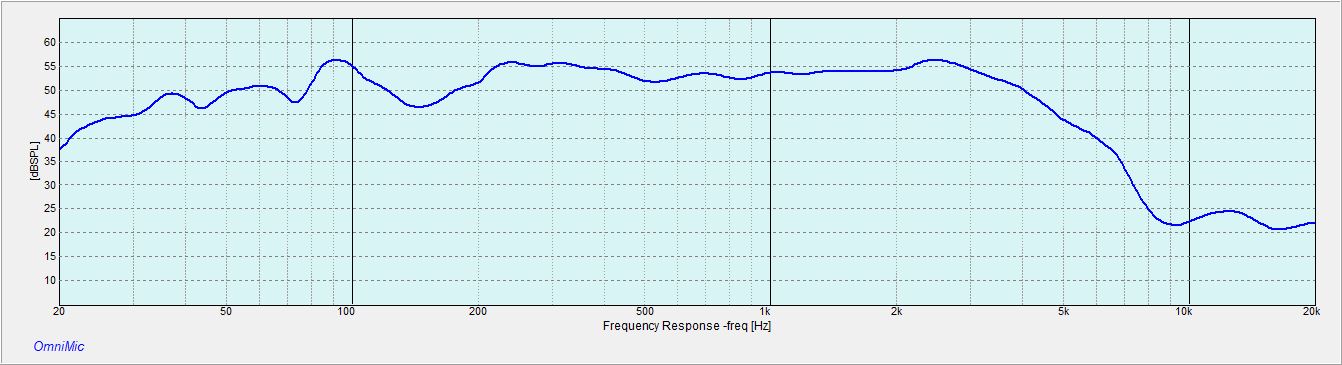

"MCM 55-2960 RAW Frequency Response
Ported Box = 25 liters. Baffle Width = 13.5″
MCM 55-2960 RAW FREQUENCY RESPONSE
May 23, 2018 – Preliminary Listening Test in 25 liters Ported Box. (Port Dia=2″. Length=6.50″)​

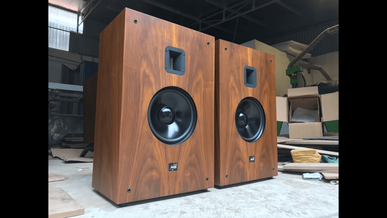

(post 1) Maybelle Audio- Vietnam
(this speaker has a Glossy woofer and a square tweeter- Not a Seas woofer & tweeter)
https://linhkienloadai-vn.translate...uto&_x_tr_tl=en&_x_tr_hl=en-US&_x_tr_pto=wapp

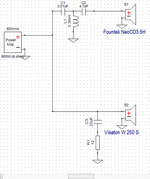

Visaton W250s-8 & Fountek NeoCD3.5H- on stands
https://linhkienloadai.vn/products/loa-bookshelf-maybelle-khong-ten-so-3

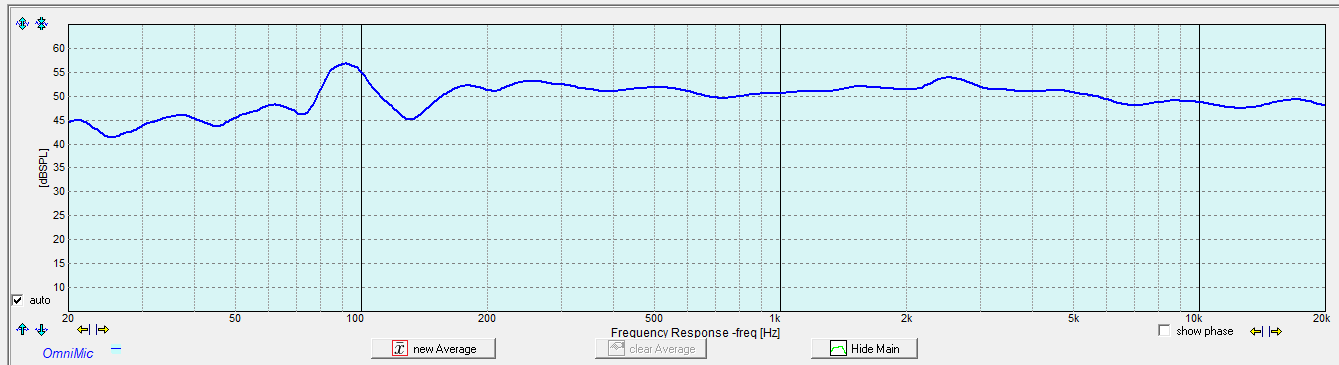

Visaton W250s-8
"The frequency response of the Visaton W250S is quite wide, nearly up to 5000 hz, and low frequency response as deep as 38.5 hz."
frequency response
