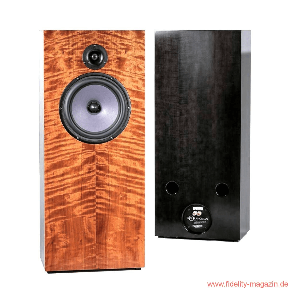

Devore Orangutan 0/96 (short speaker with stands)
$20,975.84 CAD
Frequency Response: 26Hz-31kHz
Sensitivity: 96 dB/W/M
Impedance: 10 ohms
Dimensions: 35.5″h x 18″w x 12″d including stands
The cabinet measures 28.25" high x18" w x 12" d (.75 mfd-2.68 cuft or 76 litres)
Devore Orangutan 0/93 (tall speaker- no stands)
$11,635.65 CAD
Frequency Response: 30Hz-31kHz
Sensitivity: 93 dB/W/M
Impedance: 10 ohms
Dimensions: 35.5″hx15wx10d (.75" material= 2.26 cu ft or 64 litres)
Weight: 21 kg or 46 pounds
run fullrange, no crossover

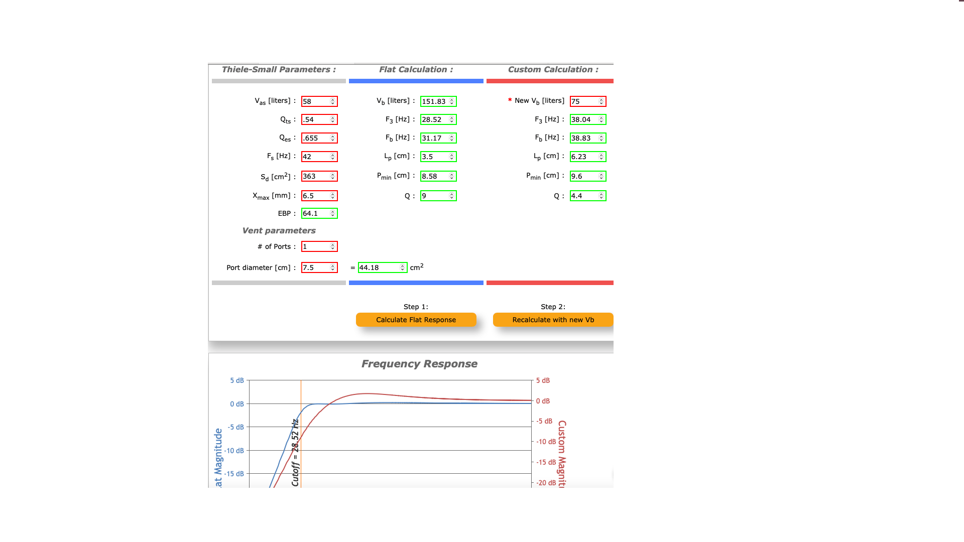

Faital 10fe200
Note fig 1 with no crossover-black line
https://ampslab-spk.com/2021/05/18/10fe200-review
from Mike Chua,
From PartsExpress Q&A
https://www.parts-express.com/FaitalPRO-10FE200-10-Professional-Woofer-8-Ohm-294-1201?quantity=1
I want to use this as a pa vented box woofer can you suggest box size port diameter and port length?
Rajinder S.Feb 24, 2017
Best Answer: I would recommend using this in a 2.5 cubic foot box that is tuned to 50 Hz. Two 3 inch ports that are 2-1/2 inches long would do well here.
(2.5 cuft= Tall hwd "36x16x10) (Short hwd 28"x18x11.5)
or
I want to use this driver in the smallest enclosure possible (ported), reaching ~ 45hz, does anyone have any suggestions?
David MAug 13, 2017
Best Answer: We would suggest this driver as a mid range or mid bass driver used with another woofer below it for the low end. When I model it I get 3 cubic feet for 45 Hz using a 5" port that is 1.5" long, but the driver is limited to about 65 watts RMS before it bottoms out. However, it would work well as a mid with another woofer below it to take up the slack for the low end and allow this driver to play mid bass and midrange frequencies which it would be better suited to produce.
Greg TSTAFFFeb 7, 2019 (3 cuft= hwd 36x16x12")
Visaton W250S
https://www.visaton.de/sites/default/files/dd_product/W 250 S_9034_9035_0.pdf
Volume/Principle
70 litres / Bassreflex; bass reflex 2 x BR 15.34 39 hz
HWD 36"x16X10 = 2.46 cuft @70 litres

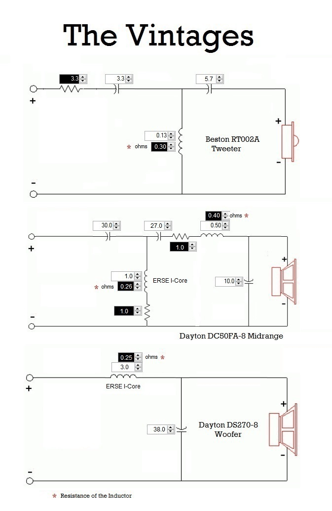

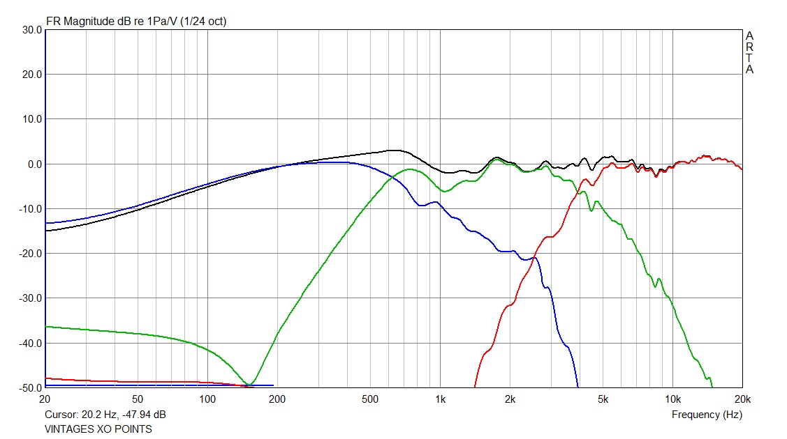

ymmv-another optional tweeter Beston RT002A - square, different look.
https://www.parts-express.com/Beston-RT002A-Ribbon-Tweeter-277-112?quantity=1
https://projectgallery.parts-express.com/pro-audio/the-vintages/
- 2,000 Hz – 40,000 Hz frequency response
- Horn loaded for 92 dB sensitivity

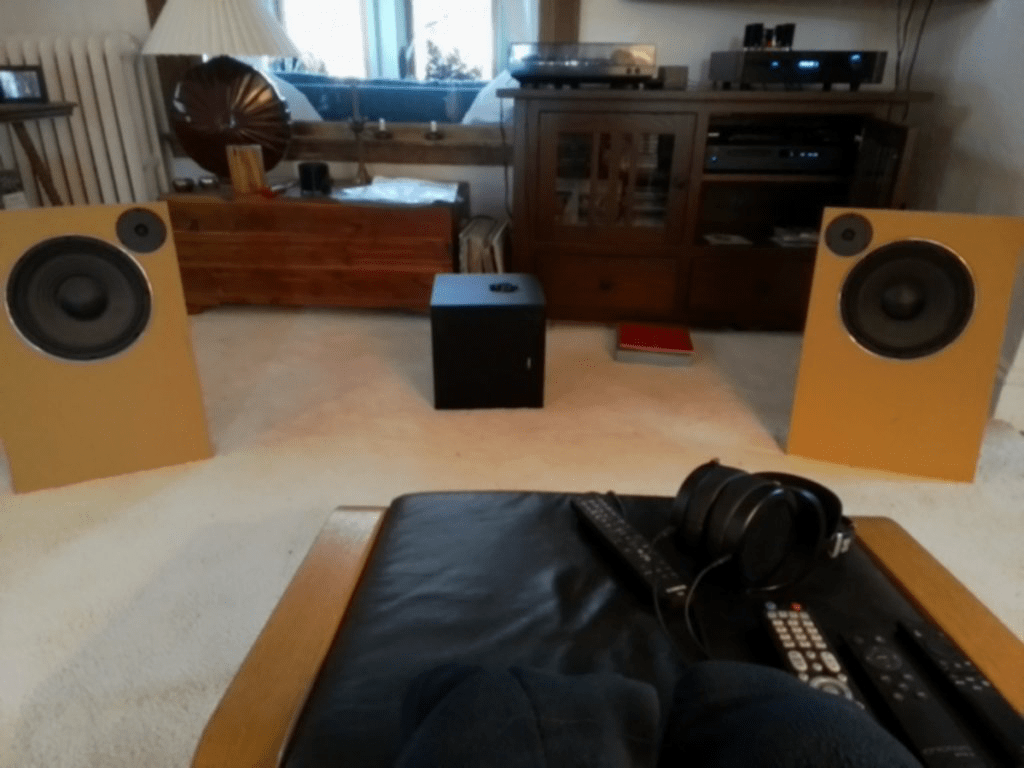

Who said anything about plywood. These aren't clones- no Seas woofer, no Seas Tweeter or no Morel Tweeter. Devore uses mdf box with plywood baffle (he must have some pity on those trees).
Just similar boxes-Alternatives, woofer fullrange. Clones would be exact-including drivers.
Anyone with bookshelf speakers @ the size of Rogers LS3/5A- are you calling them clones?
limono please post your concerns here (people even used plywood to build the boxes (Gasp)-

https://rockfordfosgate.com/support/box-wizard/
HWD 20"x15"x14" (.75 mdf) = 1.81 cuft or 51.25 litres different box (someone out there must have these box dimensions-oops, sorry)
Different drivers Visaton or Faital, Audiopur or Beston VS Seas, Morel
Not a Devore, Seas A26 alternative (definitly not a clone).
Moderator(s) change the title if necessary.

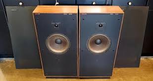

Those looks like Boston Acoustics A100/II speakers
They do.
dave

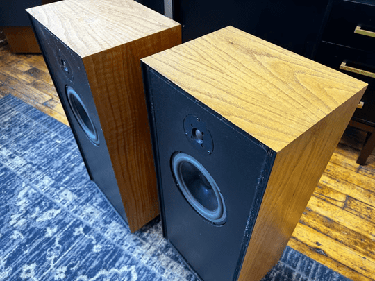

Devore 0/93 (clone nope? I meant to say similar or Alternative) & Boston A100
https://audiokarma.org/forums/index...boston-acoustics-a100.947960/#google_vignette
No clones., wood baffle vs black baffle, square tweeters, dif dimensions,etc.
Devore 0/93 hwd 35.5″ x 15″ x 10″
Boston A100 hwd 32.5" x 16" x 8.4"
Sorry no clone.

"The inductors are Jantzen 18 AWG air core and the Caps are Dayton Audio Polypropylene. I use the Dayton pre etched 2-way PC board number 260-130 which makes a nice finished product. I typically mount them on the baffle back with rubber washers."
L1 = 1.80 mh 18 AWG
C1 = 7.5 uf
L2 = 1.40 mh 18 AWG
C2 = 5.6 uf
https://web.archive.org/web/20211024064727/http://mh-audio.nl/Calculators/BRH.html
