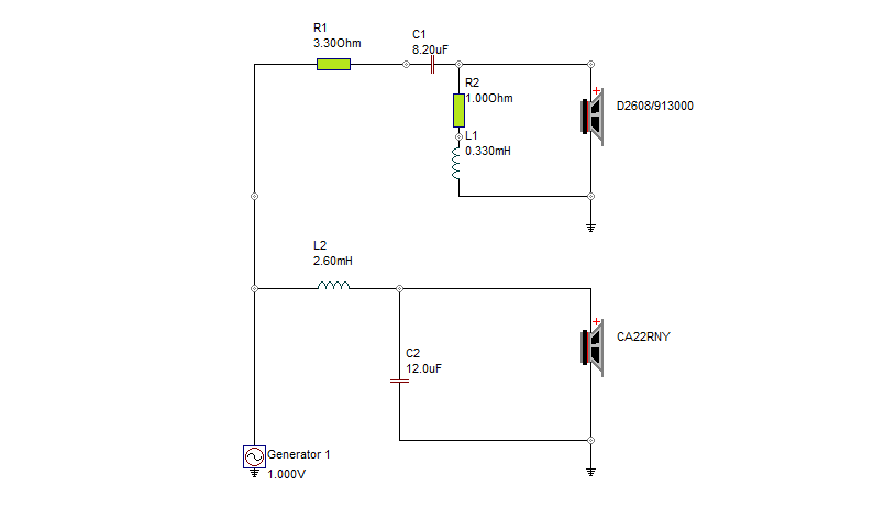

O/Baby SEAS CA22RNY alternative- ScanSpeak Tweeter-No clone:
from Troels-Snell
http://www.troelsgravesen.dk/Snell-E-III.htm
-bottom
"Simulation of similar construction based on -
SEAS CA22RNY and ScanSpeak D2608/913000.
Based on measurement from other construction using these drivers.
4th order crossover, point of crossover 2 kHz.
Use 1.6 mm wire air coil for L2 and 0.8 mm wire for L1.
R1 will have to be adjusted from listening tests.
dZ set to 30 mm for CA22RNY. Makes proper phase integration."

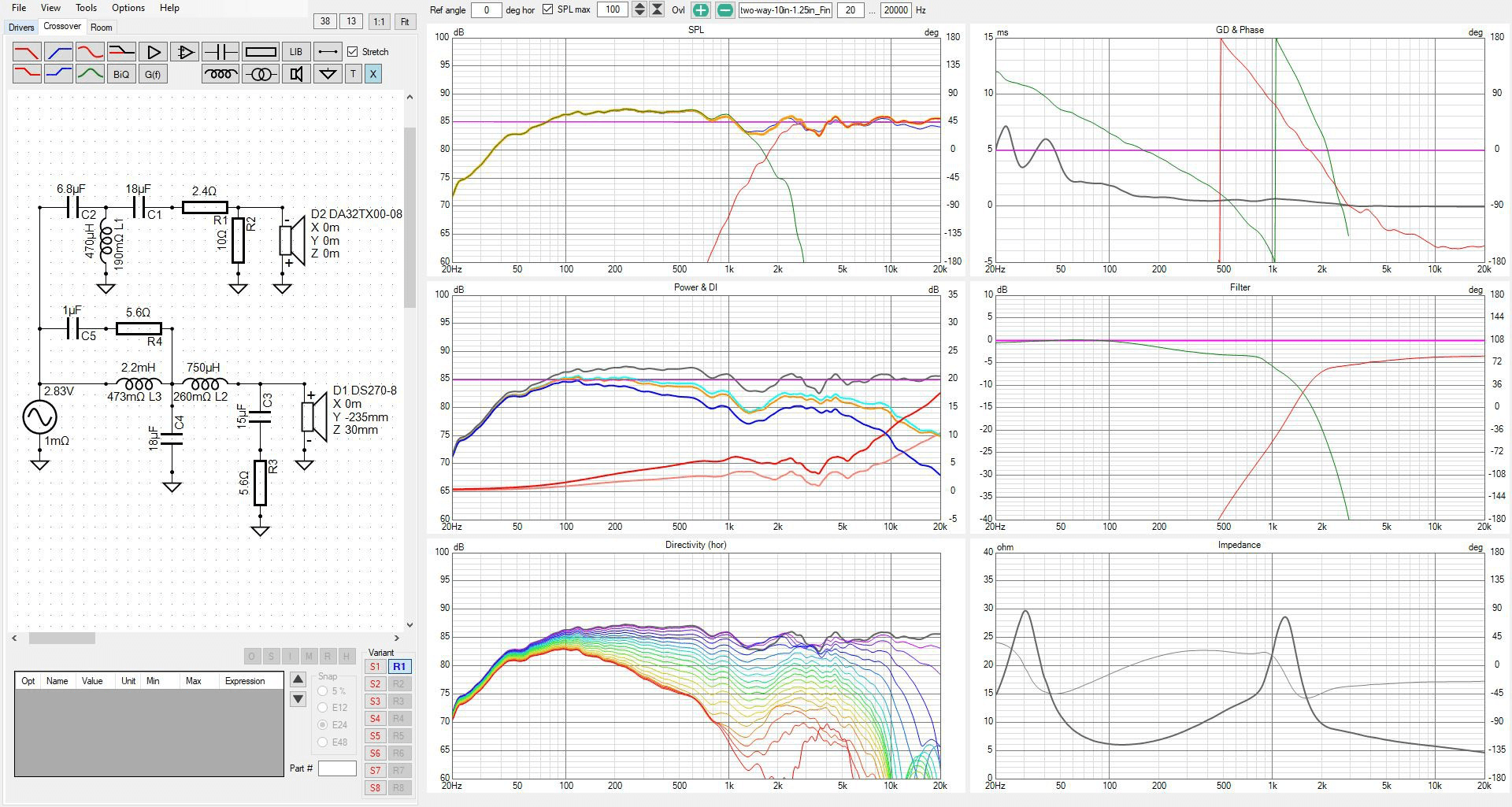

2 way-Dayton DS270-8 10” woofer , Peerless DA32TX00-08 (Note: tweeter is NLA, substitute ?)
https://techtalk.parts-express.com/...on-audio-ds270-8-peerless-da32tx00-08-two-way
Parts Express Staff Recommended Enclosure Volume
Sealed Volume1.3ft³
Sealed F357Hz
Vented Volume2ft³
Vented F338Hz
Could be a all Dayton project by just using RST28A
Fs goes down 700 Hz
Slightly higher than the 630 Hz it substitutes.
Crossover would still be same or possible shown in design.
8" woofer of course could make things easier and tighter
center to center was not done as tight as possible with design shown.
Aside from typical audiophile nitpicking.
In real life im sure they sound rather fine.
Drivers usually speak for themselves
The Daytons have truncated plate option so center to center
to the larger 10" could be very tight.

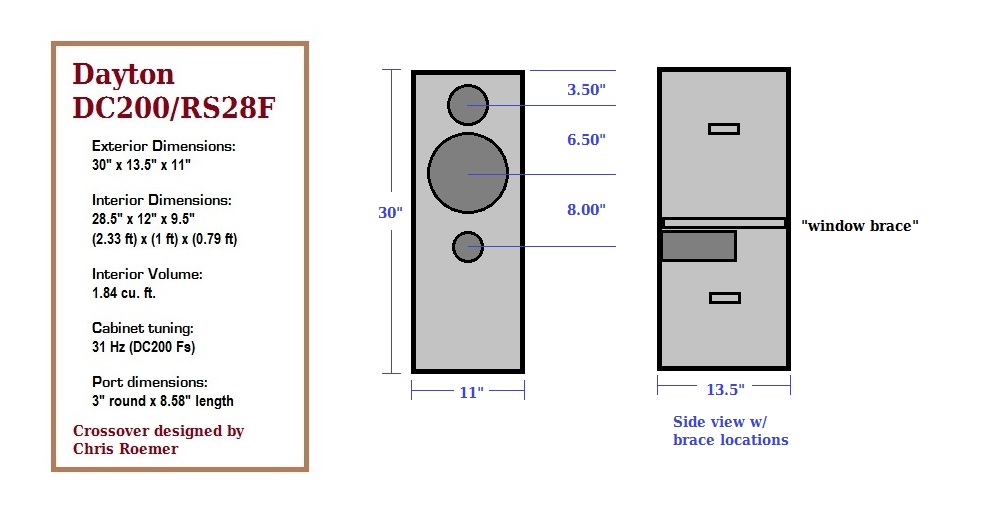

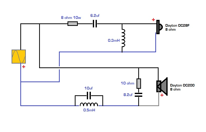

8" for a smaller Widebody type, adjust box size to your liking.
https://techtalk.parts-express.com/forum/tech-talk-forum/41977-dayton-dc200-dc28f-2-way-design
Dayton DC200
https://www.parts-express.com/Dayton-Audio-DC200-8-8-Classic-Woofer-295-310?quantity=1
Parts Express Staff Recommended Enclosure Volume​
Sealed Volume0.4ft³
Sealed F366Hz
Vented Volume1.6ft³
Vented F330Hz
Dayton DC28F
https://www.parts-express.com/Dayton-Audio-DC28F-8-1-1-8-Silk-Dome-Tweeter-275-070?quantity=1
"Chris Roemer
post # 2
02-08-2011, 12:08 PM
see about 1.4 cf. Have you modeled this in WinISD ( www.linearteam.org ) or another box sim? I think that woofer really needs a 3"d vent. Making the box a little bigger lets you make the vent shorter to achieve the same tuning. I'd like to see the box at 1.7 cf (MINE are actually 2.1 cf), but 1.5 is the min. that I'd recommend. Usually you want the tweeters at seated ear level, which is typically 30" to 36". With a 30" tall box, you're looking at about 27".
In a 1.7 cf box, the 3"d vent should be 11" long. You can't really get closer than 2" to the rear wall with the end of the vent, 3" is more typically considered the min. If you absolutely can't go any deeper, then you'll have to use an elbow on the vent, which takes up internal volume making your box effectively even smaller, forcing you to make the vent a tad longer to get the same tuning, taking up a bit more space, forcing you to make the vent a tad longer to get the same tuning, taking up a bit more space, forcing you to make the vent a tad longer to get the same tuning, taking up a bit more space, forcing you to make the vent a tad longer to get the same tuning, taking up a bit more space . . .
Your XO looks good."

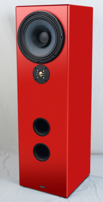

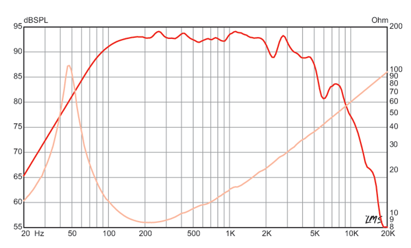

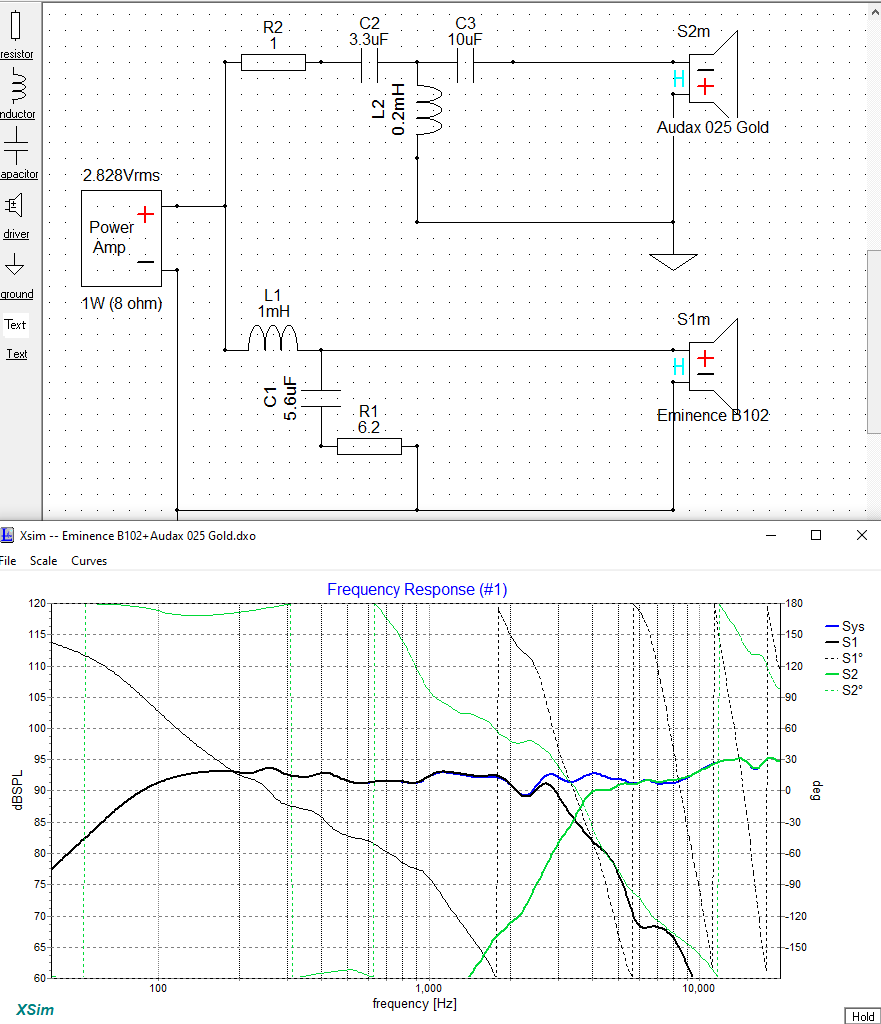

Another 10" woofer- Eminence Legend B102 .
https://eminence.com/products/legend_b102#frequency-response
p.24 Eminence Legend B102 running Fullrange
Klang + Ton 2010-02 pdf
https://kupdf.net/download/klangton-2010-02pdf_599bd0d4dc0d60f97953a200_pdf

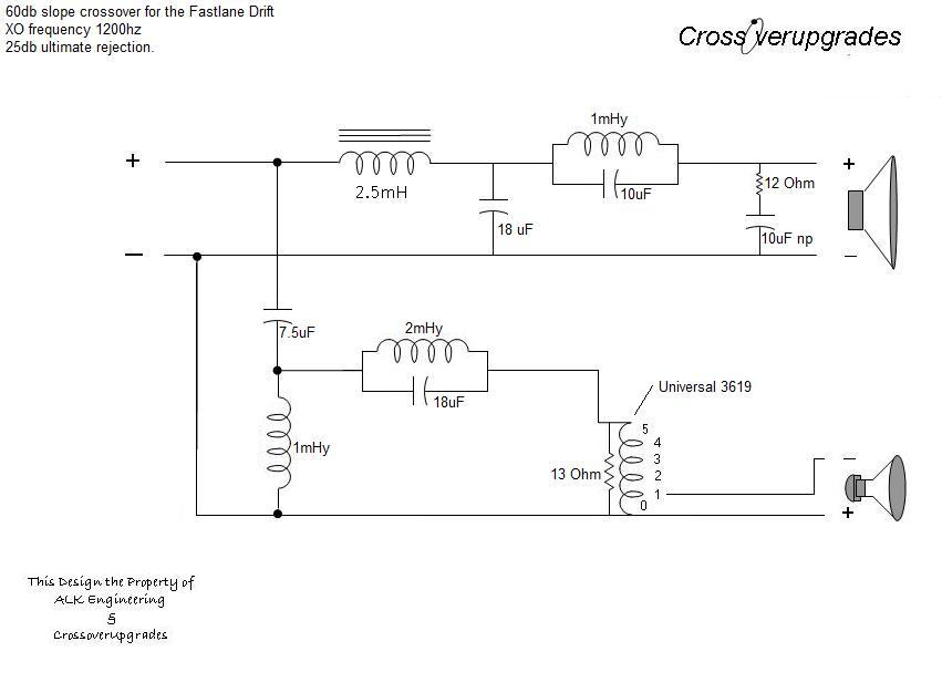

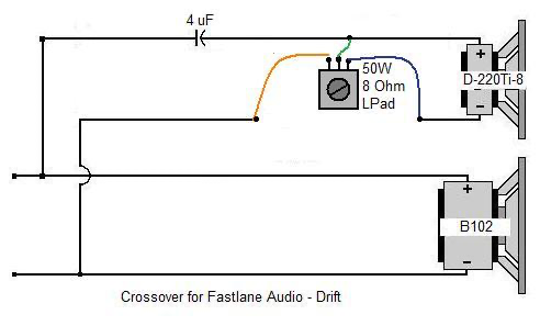

Daves Fast Lane - Drift Recipe
https://web.archive.org/web/20140911183947/http://mysite.verizon.net/res12il11/id119.html
"The Drift is a high performance 2-way speaker capable of reproducing the slightest nuance in in your favorite music, however easily performs good enough to be used as studio monitors, parties etc.
The Drift can be assembled in several shapes and sizes as long as you retain a 2.3 cuft internal box volume with a pair of 2" diameter x 2" long ports.
The woofer for the Drift is the Eminence Legend B-102, this woofer is the heart of the Drift, it is an amazing perfromer. "
With crossover
Tekton Lore
https://www.diyaudio.com/community/threads/tekton-lore-crossover.347177/
post#4
EarlK
Member​
Joined 2006
Using the Eminence B102 woofer and the
Audax TW025A28 1" Gold Dome Tweeter -100mm- 8 ohm- 94.5dB fs 1017 hz,
(along with the previously posted cap values ) one can ascribe these values to a network

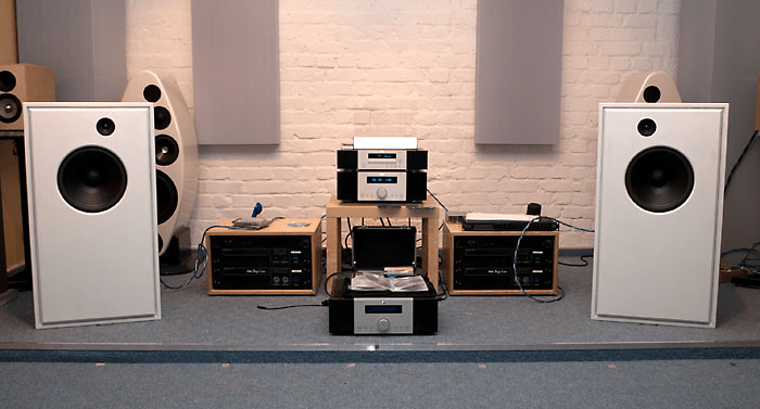

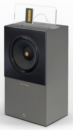

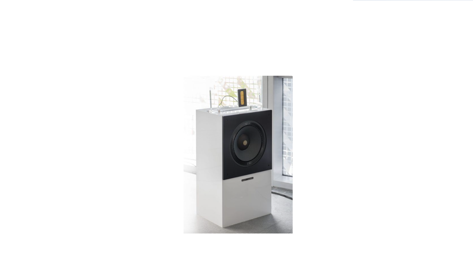

Another wide body speaker
Wolf von Langa
wolf-von-langa-son-edition 95dB 1W 1M WHD 404.874.330mm-beaudiful-standlautsprecher-grau-grey-1.jpg
