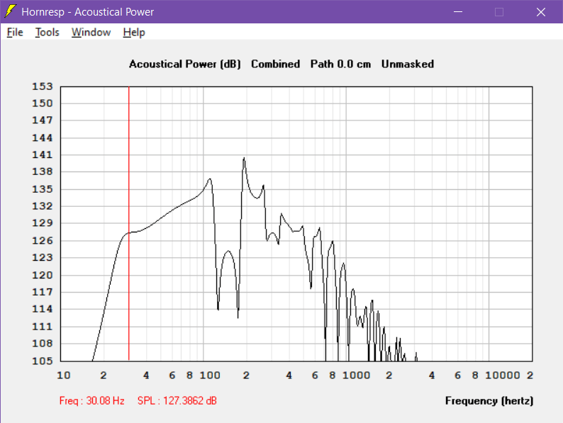

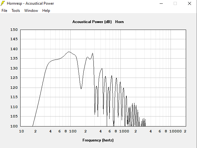

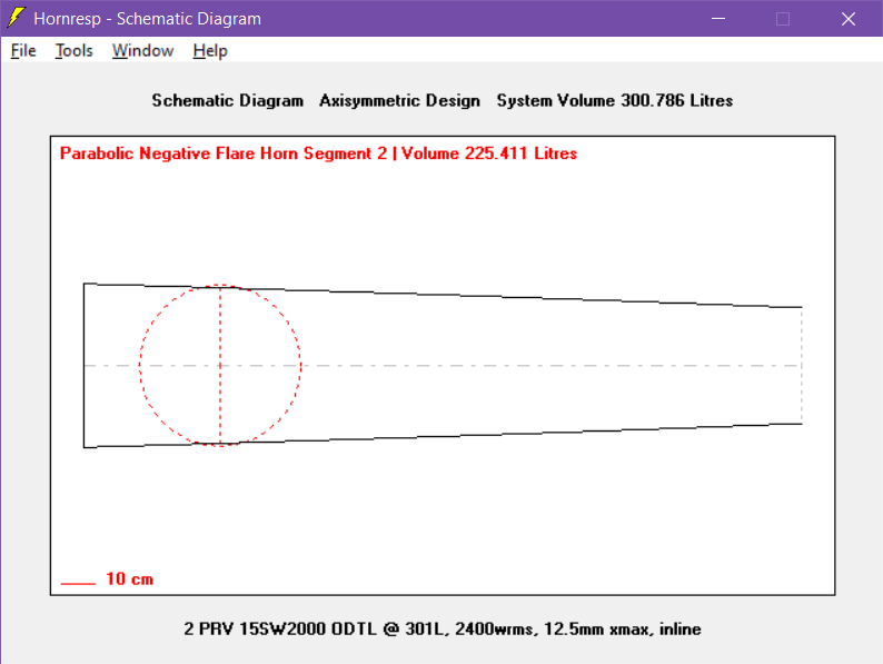

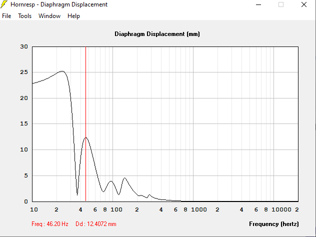

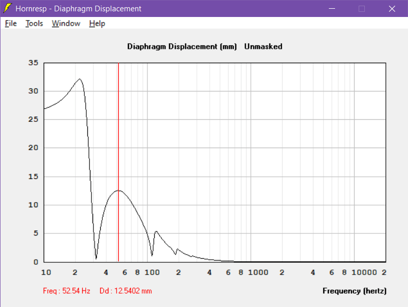

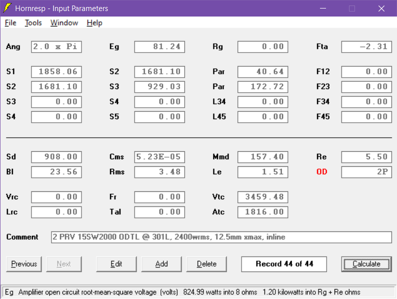

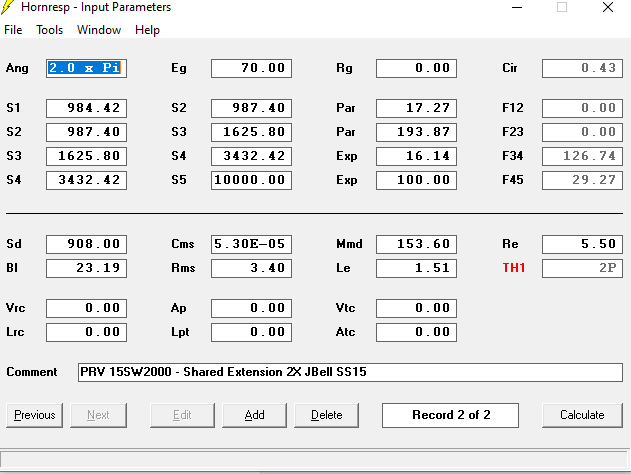

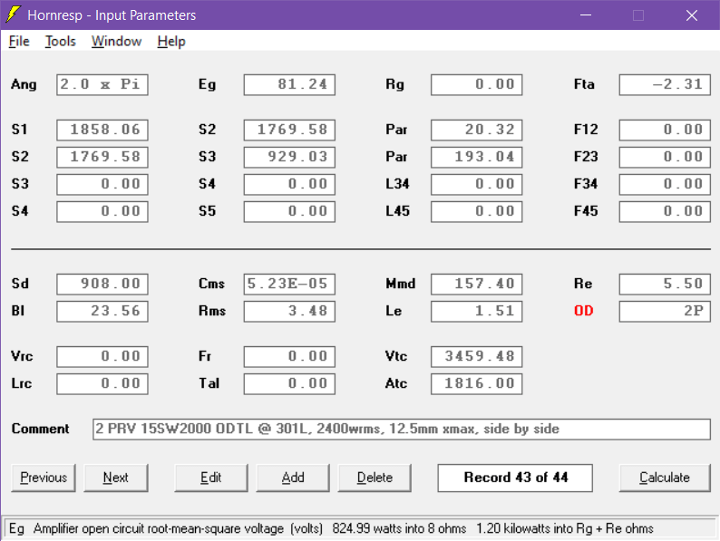

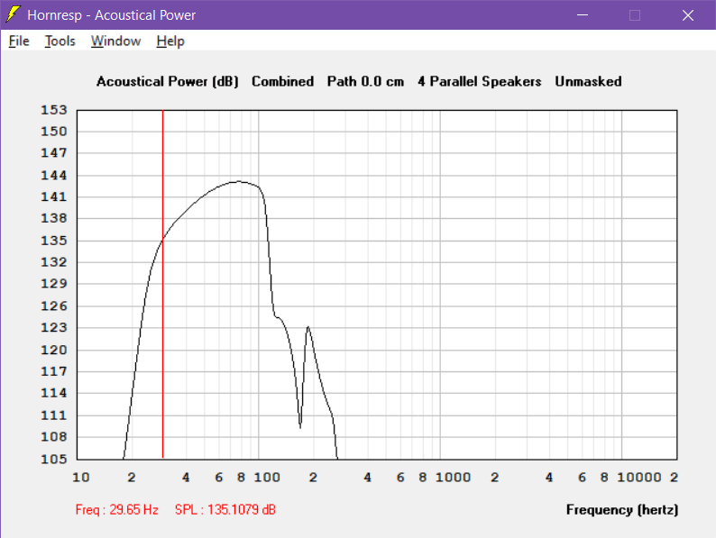

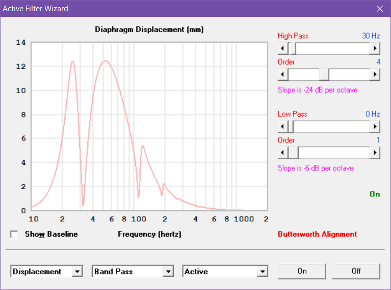

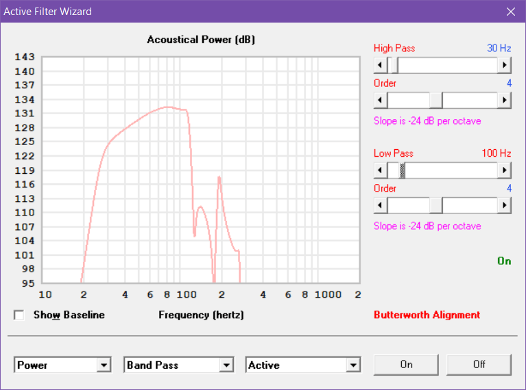

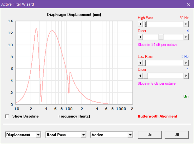

zwiller modified the SS15 for dual drivers, i punched the PRV one
and simulated @80v
heres is the result and Hornrespt TXT
https://www.diyaudio.com/community/threads/single-sheet-th-challenge.170771/page-106
and simulated @80v

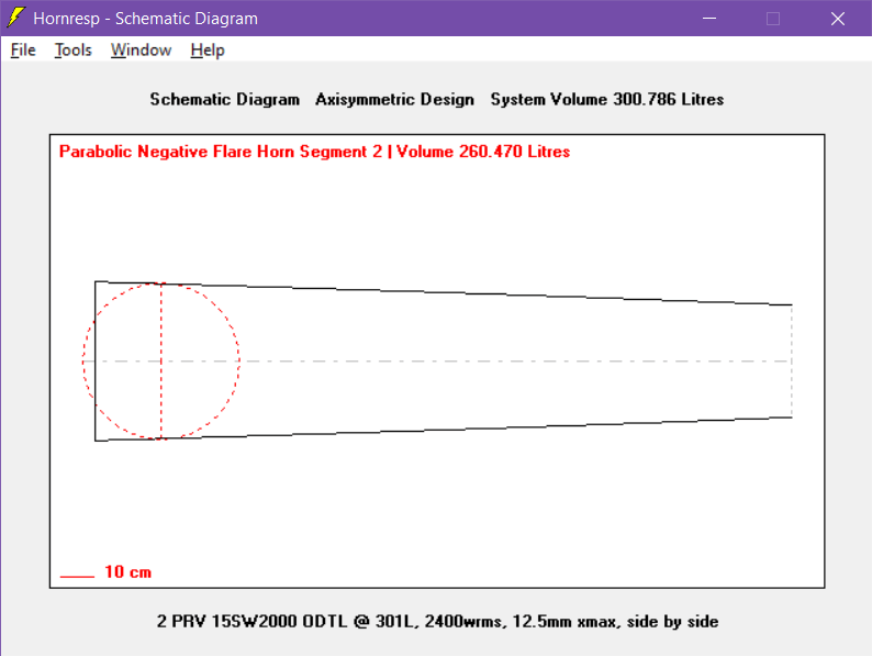

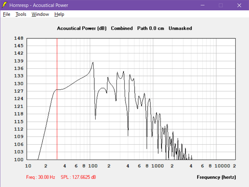

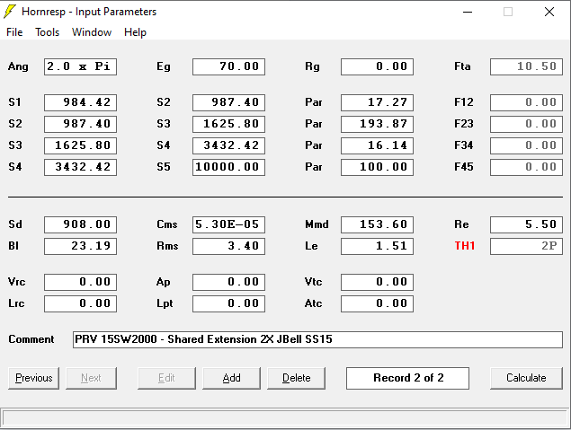

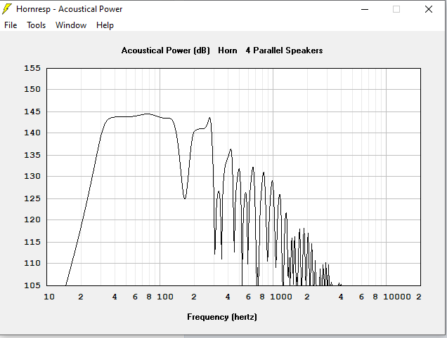

i just pasted the PRD driver in to what was on the hornresp txt from that postYou are not building an exponential horn with a 10,000cm2 mouth.
Use PAR, not EXP.

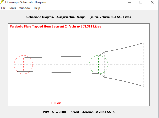

that guy made an flare extension to the cabinet but that was on post 2,112
i made the change to PAR but the S5 value is way off right ?
thats what it was on the horn resp fileYou are NOT going to build a 10,000cm2 (39.37" x 39.37") mouthed enclosure!
i only punched the PRV instead of the 3015 LF

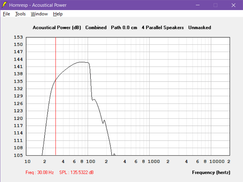

something like art do with his keystones and tops hereWow, I just realized 10,000cm2 = 1m2 or 1 square meter.
Knock yourself out with the bolt on extension. I'd rather use the wood and hardware money for another enclosure.
was just an ideaKnock yourself out with the bolt on extension. I'd rather use the wood and hardware money for another enclosure.
i prefer more cabs that one cab with extensions
Not much difference and much smaller the slim version
The later 😉There shouldn't be. Do you want a 32" x 4.5" or 16" x 9" mouth?

As soon as the person puts the same capable drivers into three or four different types of cabinets, they quickly realize this^^. if the driver is not entering, or the exit isn’t at an odd harmonic interval of the fundamental, then everything is kind of screwed up, no matter what already.
Horn response allows us to see the obvious and it’s even exaggerated but those are red flags already and if you choose to stuff them out or ignore them then you didn’t really fix the issue or don’t understand what you’re doing??
you must align the 1/4 and 3 Fb(1/4) or you pay the price For venting a turd😝(fart: bad/less, sound, misaligned, phase, and every single other issue that stacks on top of that, as you drift further, and further away from it?
