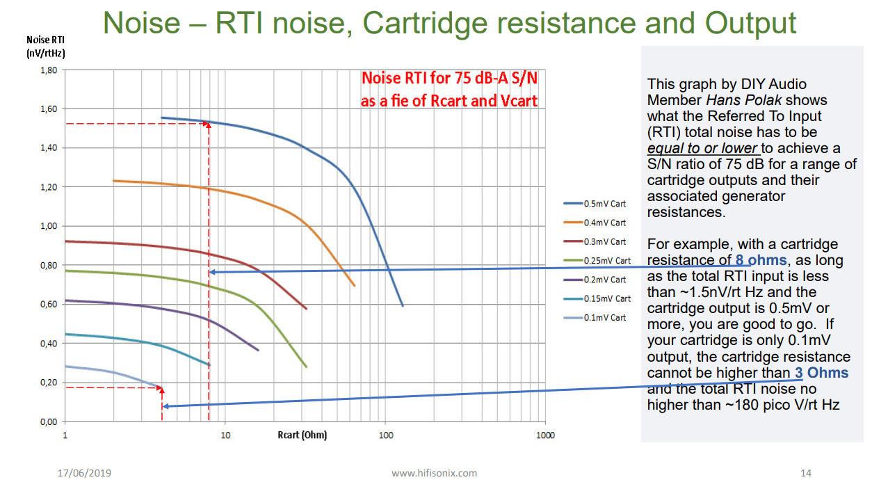

Mind you, a 45R cart produces ca. 0.87nV/rtHz noise.
To have a S/N several dB’s above 70dBA with cart connected, your preamp should have an equivalent input noise below 0.9nV/rtHz, assuming a 0.5mV@1kHz@5cm/sec MC cart.

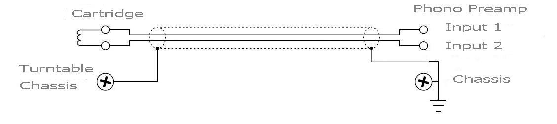

If Input 2 becomes connected to ground and also chassis at the phono preamp end is it still a balanced connection? I can agree that it uses a balanced cable. Grounding input 2 to the chassis neutralizes the effective capacitance between the input 2 signal line and the chassis, being not true of input 1 hence imbalances the characteristic impedances of the two lines along the length. This suggests that to maintain a balanced connection requires equal impedances to ground and the chassis in the phono preamp termination. Don't know if it matters much though, just how it is described.
In the shown cable image the preamp´s chassis and TT chassis are connected to Protective Earth not to analog ground.
Why should Input 2 be connected to analog ground (and not to the chassis) unless you want to compare Diff to SE.
In a balanced connection, to achieve a high CMRR, sender should have equal impedances and so does the receiver.
When connecting input 2 to analog ground, you will have an unbalanced SE connection.

BTW here is Hans's graph of cart output vs cart resistance vs amplifier noise (c.f. from the Richard Lee's MC Pream thread)

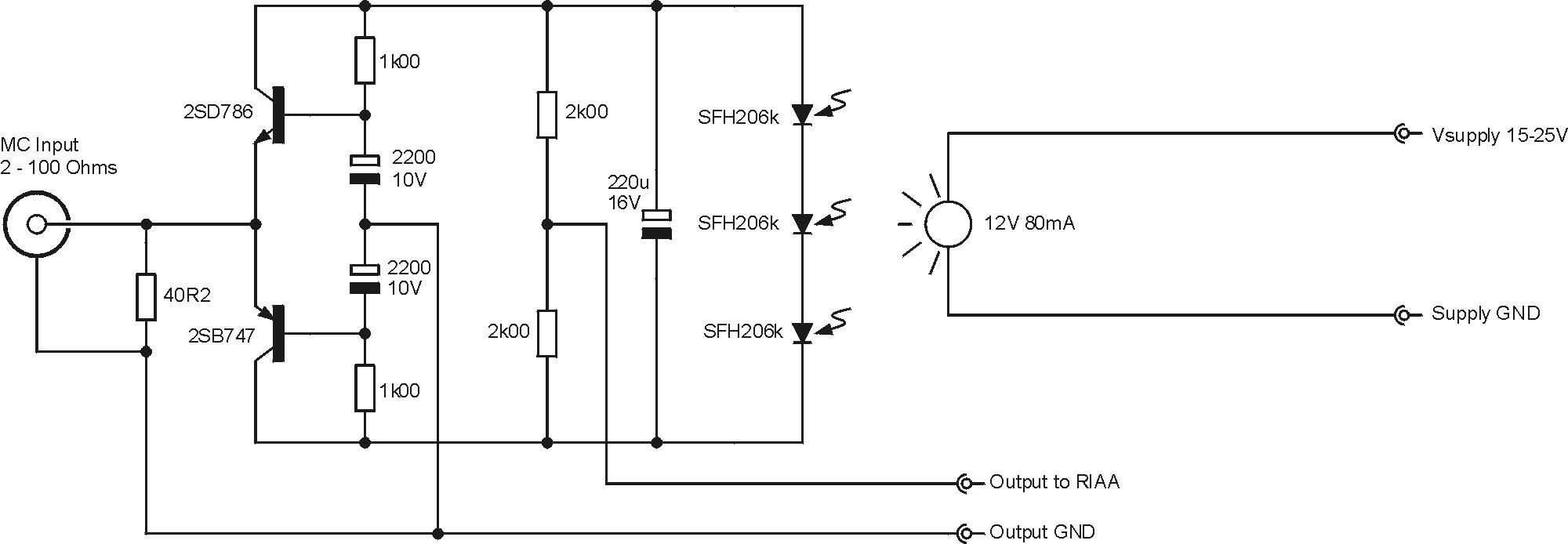

To avoid this ground connection battery or as in next picture, photocell PS is needed, and all is all merry

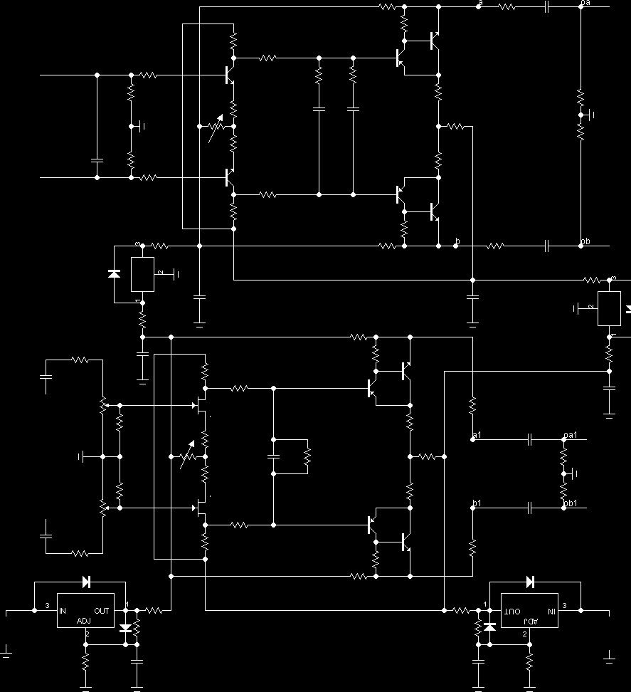

Above picture is just example of MC preamp, it looks like "single ended", but where is says GND, this is not really GND, it is signal return and all is perfect. Floating source in, floating source out if you wish.
Another thing that might confuse in this picture above (as in many diagrams elsewhere) is RCA connector symbol at input. That necessitates connecting grounds (real dirty ones) between devices by return wire, aka shield. 3 pin connector should be there.

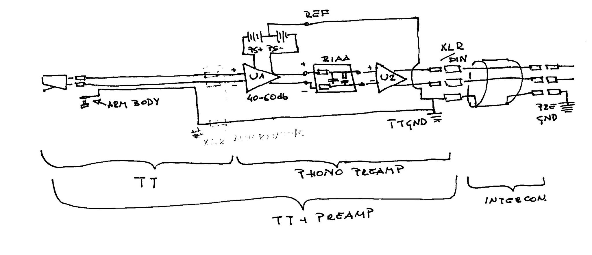

Here I made small sketch also to facilitate. For active devices I used FDA symbol, but it can be also circuit from picture above, As mentioned, GND is not GND if not grounded, it is just return path or - signal.
PS for U1 is battery, I drove symmetrical PS and middle can be taken as reference, effectively transferring floating source to more common differential variety. This can be done also at U2, leaving U1 as floating in, floating out. With battery power this unit is not needed to be ground referenced.
My preference is to put first stage (U1) at least inside the TT, and solder cartridge wiring directly on it, but output can be taken from everywhere, from arm wiring (as most common), after U1, after RIAA, after U2 (making TT an line source). For me it is only important that connection between TT and unit that follows is as drown,;3 wire; (+, - . and shield-ground)

Good point, how quiet preamp actually needs to be ? More quiet than cart noise, enough as one cant delete cart noise.Mind you, a 45R cart produces ca. 0.87nV/rtHz noise.
Apparently my existing preamp (post#32) is quiet enough for my Ruby2 cart, But discussion is good as there are quieter cartridges around...
