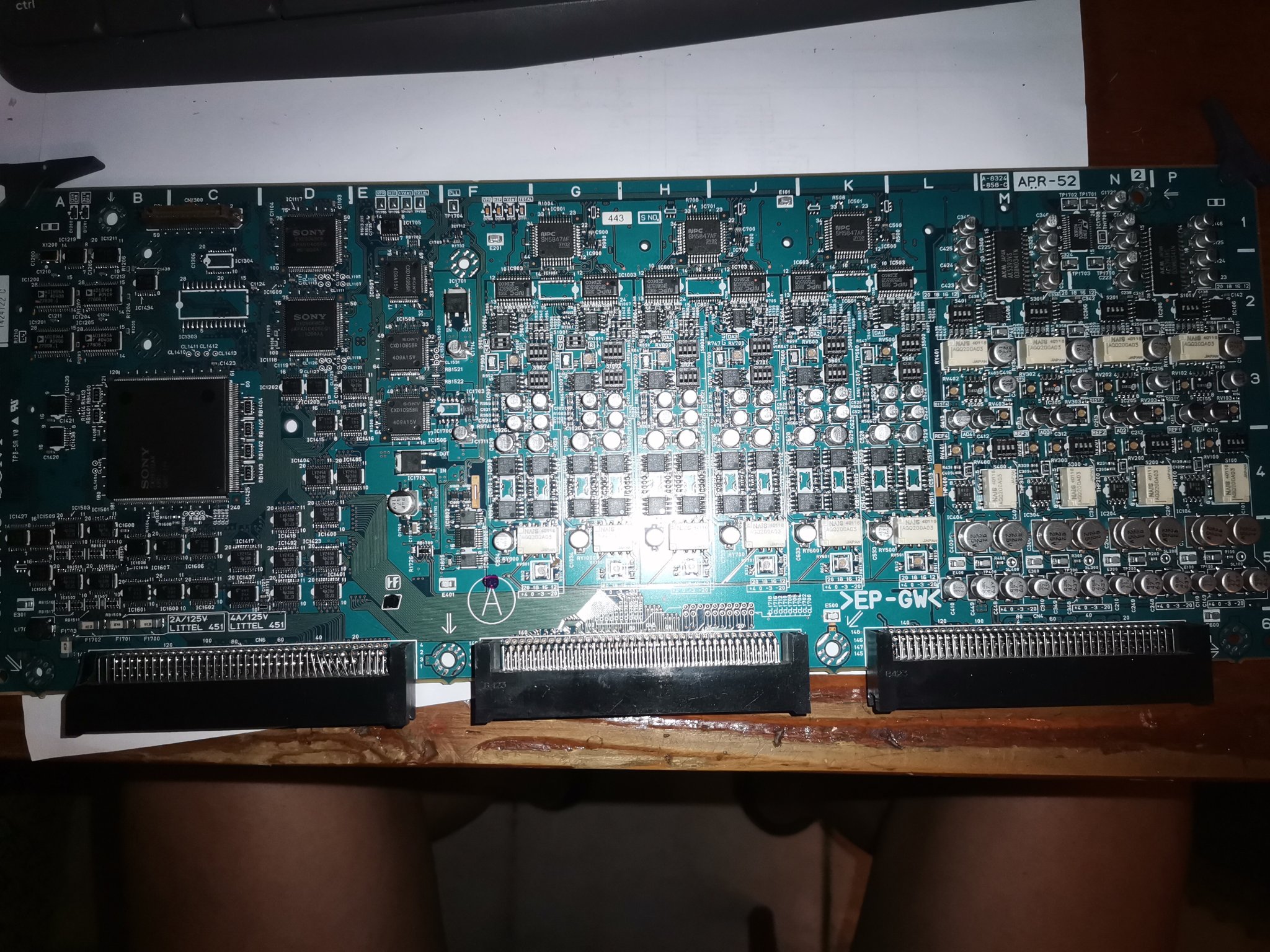

This is a device that I'm working on while enjoining discussions here, It is made in early 2000's and audio signal of most of movies you watch and listen that are made in 2000's went through this (or just few similar) board for monitoring purposes, as mentioned somewhere before , these signals were never released to public in analog form. . The complete device costed new about 78000 US$, this is just monitor out and analog in board with DSP . Go and figure grounding scheme here. Only thing that is for sure, all analog signals on this are fully differential, not just balanced. Pls wait another 25 years for Topping and SMLS to get to this, even I think that they make very good products also today, but for very simple use. Politely I think we should end soon 🙂

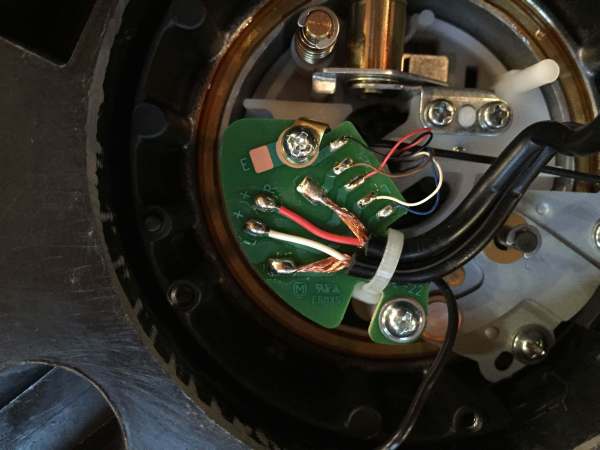

To put it simply almost all carts are floating generators. Whether the interconnection is balanced depends on how it is terminated.
Some MM carts have an internal link which ground one channel's "-" connection to an internal shield. Others have a removable link. I have an AT which is like the former and Stantons like the later which have external links. Internally-grounded shields do imbalance one channel, usually the right, somewhat slightly.
Here's a diagram I originally provided for Lathe Trolls which shows several shield connection options depending on the turntable and cart case ground. Ideally the shield(s) telescope all the way from the male XLR back to the wand and headshell with the TT frame ground separate leading back to a the preamp case ground. The telescoped shields, which drop off at the TT, carry no current unless they are linked.
An SL-1200 is super-simple to mod. Here's a photo of the arm base with stock RCA cables. The RCA cables get replaced with shielded twisted pair. The STP shields tie to point "E"; the ""-" signal leads tie to the points where the RCA's shields originally connected.

Most of my boards go to mastering facilities who cut vinyl. The primary playback turntable is the lathe itself: The RAW preamp output is usually RIAA-EQ'd in analog and is used for acetate and test pressing QC. I also provide a large number for restoration/transfer or consumer use where RIAA EQ is applied in DSP.
