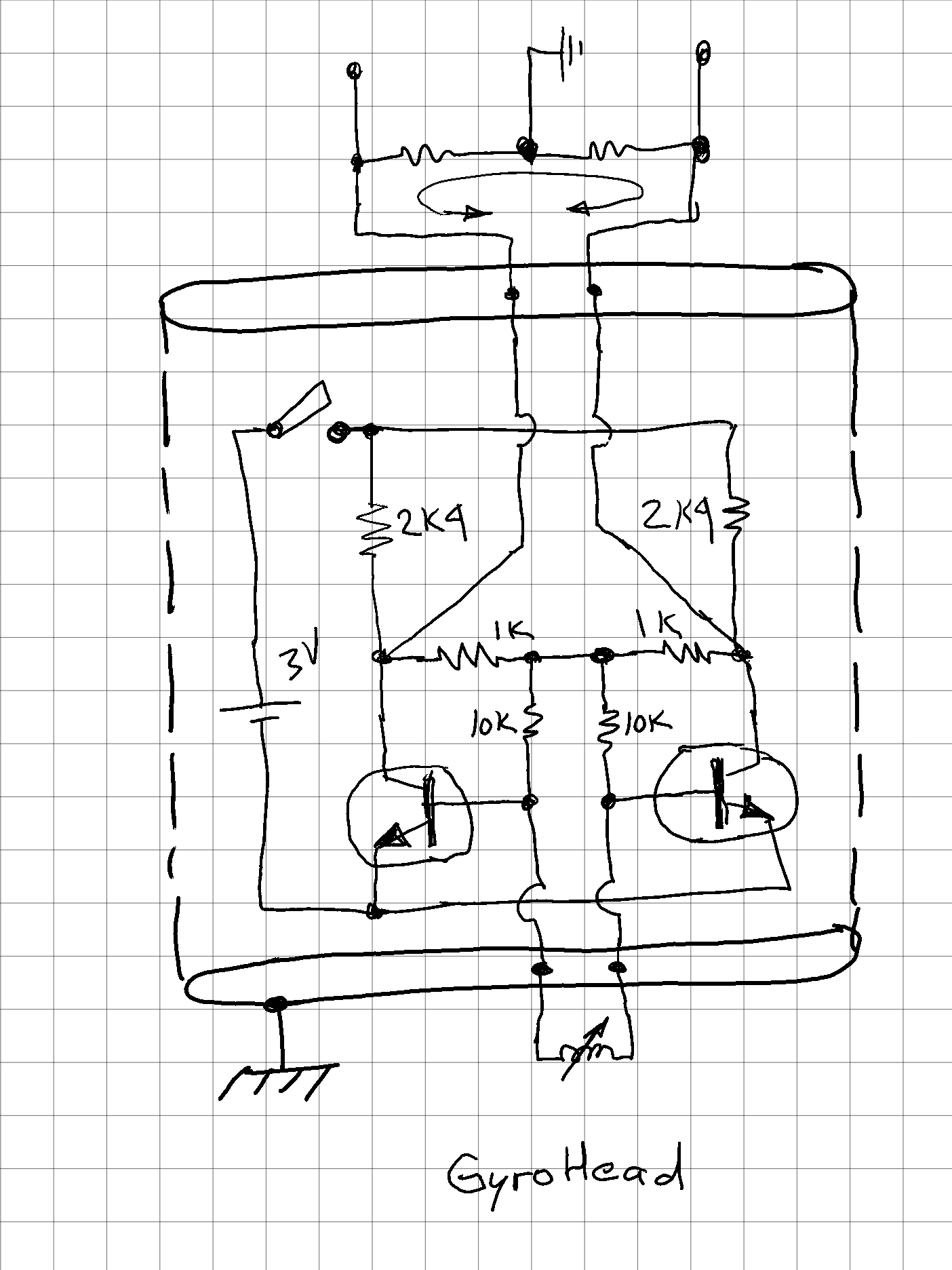

This is how the original GyroHead pre-preamp can be viewed wired, whereupon the network can be perceived as battery powered floating amplifier inside the shield (actually consisting of a small die-cast box) on the right half of your image. A 5 pin din cable was created to connect to the base of a Linn tonearm with dual shielded twisted pairs feeding XLR's at the GyroHead input end, seemingly in like manner to what you have indicated.
The original pre-preamp was configured as a voltage gain amplifier using low noise Zetex devices with XLR in and out. Because the network is floating an XLR to RCA adaptor can (and was) connected to the output that shorts ground pin1 to the -ve signal pin3 on the XLR output. This creates an SE output for RCA stages in lieu of going balanced.
The diagram shows the manner of connection for symmetric balanced drive. Because the amplifier only deals with low level signals inside a shielded environment and appears almost as simplistic as it can get, the network can be easily constructed on a small vero-board. As a result it seems ideally suited for the more inexperienced diyer's to construct. In examining the link from the above, some matched pairs of ZTX851 can be purchased (albeit at $25 per matched pair) that could be ideally suited to this network.

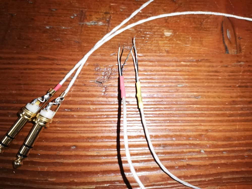

Figured that for this project I will need better scope probes than what I had before, so used piece of silver cable (2 twisted in shield) . This was not audio shop crazy cable, but lab equipment issue. I will solder end of wires to DUT, other end is TRS as this is what my soundcard accepts...

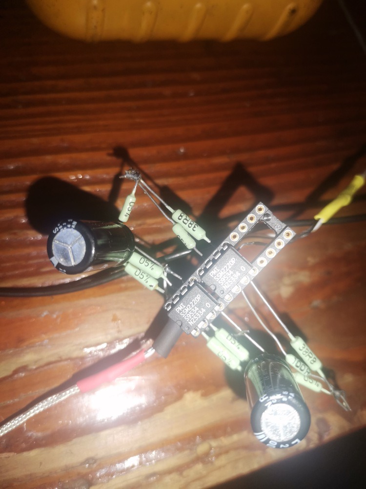

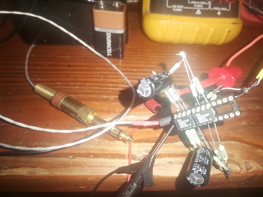

Spared 1 and half hour today and quickly put head amp as my post#1, courtesy of tubecad.com together. Today I just managed to check few DC points; hefty 50mA current draw for all 4 transistors, DC voltage points ok left and right, seems it works. Tomorrow I will try to measure more.
Reason I put it together is that nobody commented on this, there is no simulation (I mentioned before, SPICE and me are not good friends, this is how I do simulation for simple things, complicated ones I torture friends and volunteers to do).
Than I had all parts (check the manufacturer on SSm2220 , I actually bought these new, you can guess my age then 🙂)
And, I need to do little practice how to actually measure so low R, V,, eN things. So far I only measured power and speakers.
Please note this is practice mini project, not idea for final design...
Managed to make first steps before I need to put kid in bed 🙂
But I did not analyze anything yet. Good thing is amp works from first, nice sines and squares, I will not publish that as its trivial.

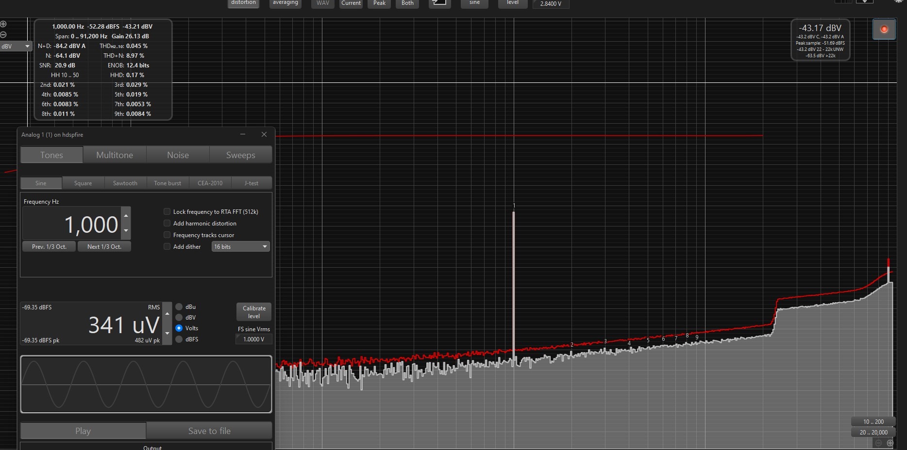

RTA 0,34 mV digital input 1000Hz

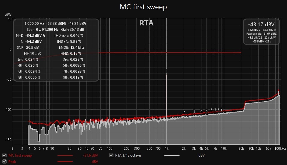

Sweep:

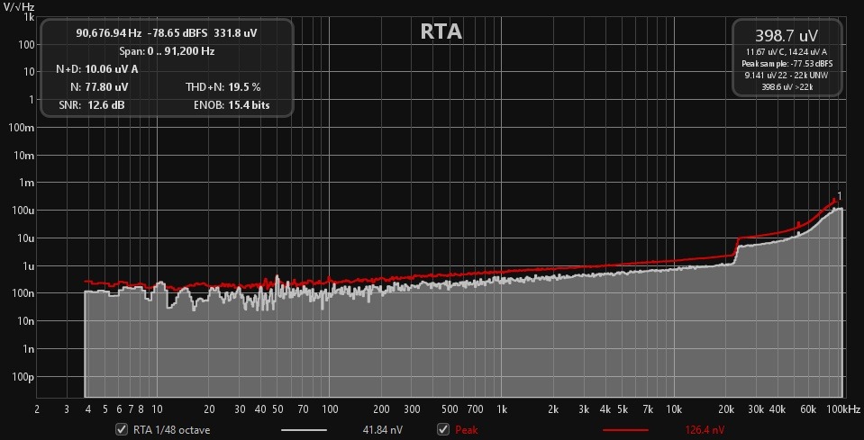

Noise, no input
As said, did not look in details, this is just wild first check, but looks promising to dig into it bit deeper 🙂
