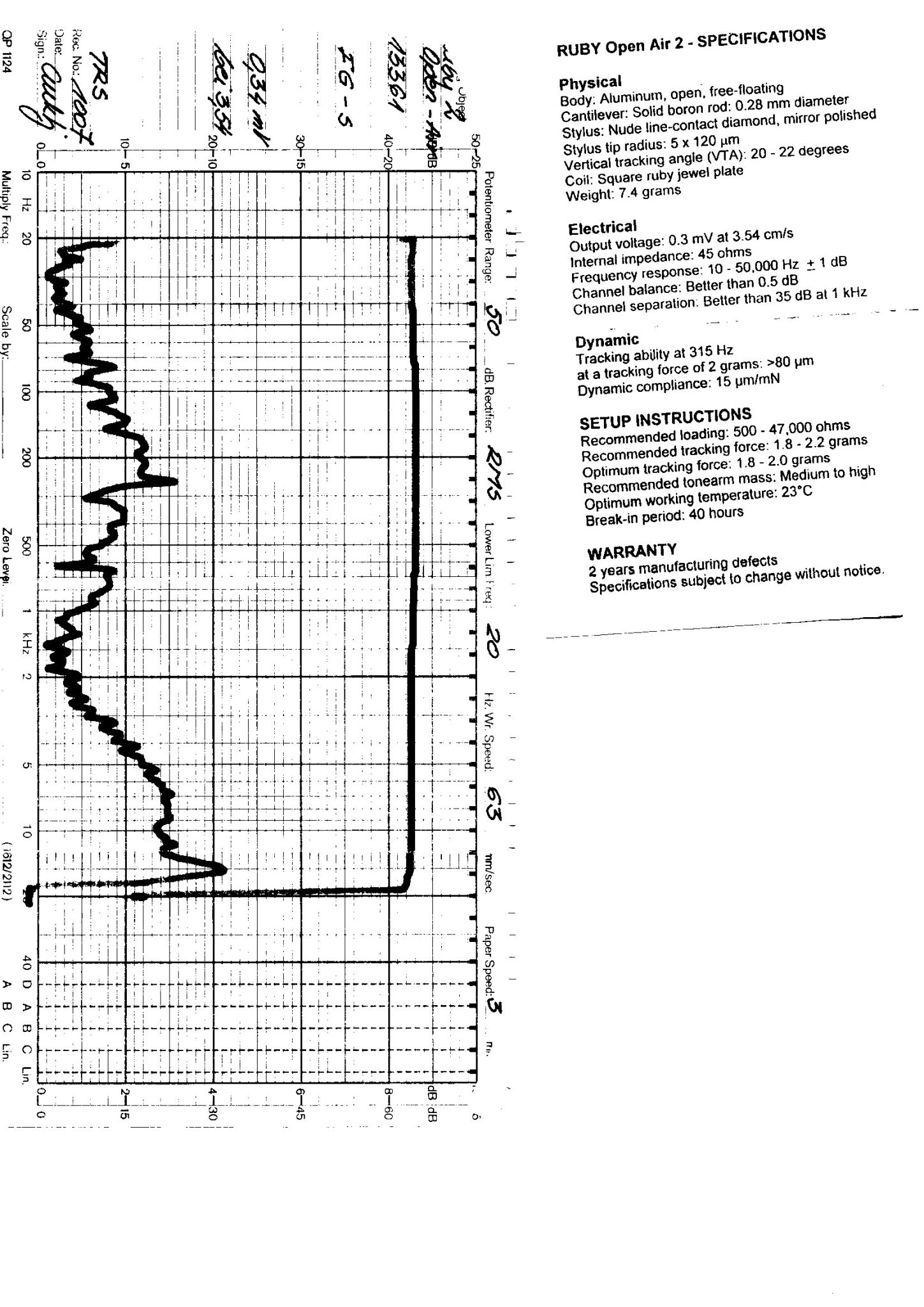

My mistake, I did not mention before that I'm using Ruby 2 naked cartridge. Benz Micro recommends ideal load at 1kohm, not usual 100ohm.
Looking at Dicks test setup, input Z is close to nothing, would this mess up the cartridge? Or you had LTP circuit in mind?

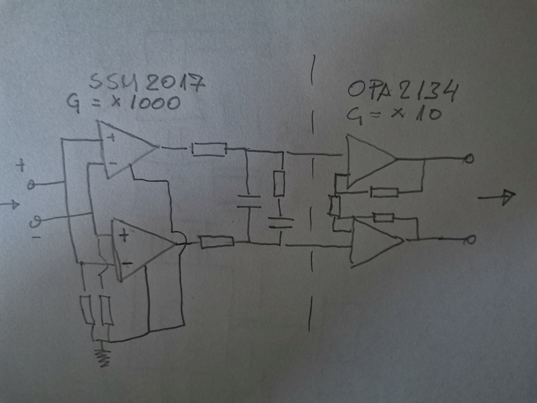

Thanks Bonsai! Pity you did not finished it. If you wish you can continue here and help me and might be others. I will surely build one soon.
I am just discovering these ZTX transistors, seems like gem, not only ultra low noise, but also high Ic and Vcbo, this could be used as VAS stage for mosfet outputs too. But another time......
See couple of comments "if balanced is worth effort". Well, one DIYer will hardly spend 150€ on any material for whatever RIAA preamp (unless buying unobtainable and /or snake oil). My cart cost me 1,500 Euro, (today similar ones are over 3000) That makes my preamp 10% cost of cartridge.
If I add turntable in worth of 4000 - 5000, my preamp is 2% of value, now add 200 new LP's and preamp is 1% of TT fun cost. My pure business management logic tells me that it is worth to invest in preamp whatever it takes (within common sense and diy).

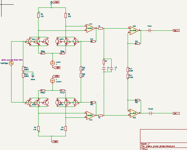

Dears, here is roughly one layout, just as playground.
It is fully differential, but if one draws GNDA line from where it is to the right and left, and deletes everything below it, then it is single ended.
The PCB in the end can be made a) balanced as is below, or b) stereo if one ground line is added.
Please comment if you wish to participate, cross, delete or change whatever you see fit:
Here are my thoughts when drafting this, pls challenge at will:
Looking forward!
- LTP input instead of current as we are not sure of cart impedance. I'm not even sure what my Ruby 2 has, but they recommend 1k load.
- Q1, longish list: ZTX, BCm53, 2sk1541 just mentioned, I can add MAT + SSM matched pairs (if they still exists). Both NPN and PNP can work here (with turn around diagram). Q1A and Q1B must be matched as bunch.
- As example I put 2mA current per device as it seems to fit.
- U1 will see very low input impedance, so no need for jfets, as example I installed LM4562 here as quite standard opamp
- RIAA network; R1, R2, C1, C2. For C I think Polystyrene is right way
- U2 will see R1 as source resistance, so I put JFET OPA828. RMS signal here will be nominal 34mV, so I guess its input noise will not be of big issue here.
- For above to work good, most of the resistors need to be 0.01% or carefully matched pairs

JFET's for Q1?? probably more difficult to match than BJT's ?
Unless expensive matched pairs are used.... To contradiction of my own words in post #25; I'm not sure that approx 120 Euro for 12 LSK matched pairs is worth it???

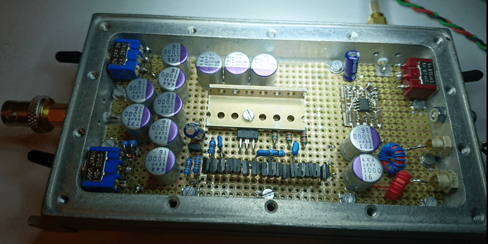

Build the ribbon mic preamp from Art Of Electronics ed3. (book by Hill /Horowitz)
70 pV/rtHz , works as promised. I have built a single ended version
with 1/4 the number of transistors and a whole bank of input capacitors.
Most interesting signals are NOT centered around 0V.
No need to match transistors. That seems to be an audio boy fetish.

Here is spec of my cartridge as example; 45 ohm source resistance, inductance not specified :-(

Your Ruby cart has quite a high internal resistance. I am using a DL103 with my X-Altra MC/MM with the cart test certificate showing 390uV output and I measured the pickup coil resistance at 30 Ohms.
