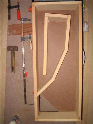

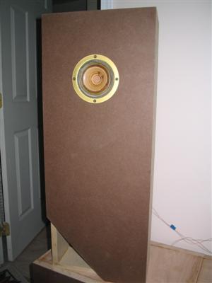

Had these 16 ohm monarch 3-1/2",alnico,steel frame round holes in basket.
Due to the shape of the material I had, designed the horn this shape. 12" wide X 30-1/2" high X6-1/4" deep; inside baffles are 4-3/16" wide.
They don't go down to far but a very enjoyable and cohesive sound. Will get some other opinions to fully comment later

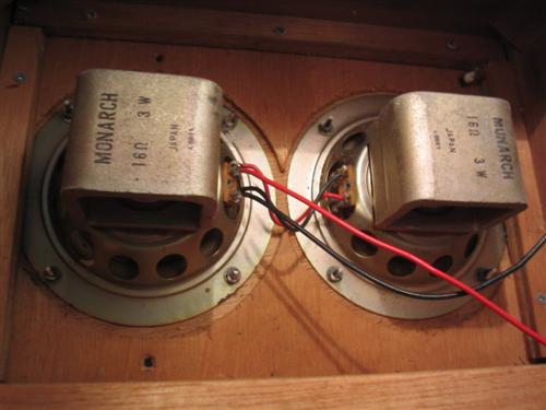

There were 2 in one box; I tried them before in that enclosure and was not impressed! I will have to demo these to Cal W. I did see the ones he had in his 3-way as a mid.
I'm not sure if I have the other box... I looked but there is so much stuff to get organized. cheers
Yep... that's how they come (there is an 8 ohm version that comes in Sony TC500 Tapecorders (along with a REALLY nice pair of EL84/6V6/6AQ5 SE OPT (probably Tamura)
he had in his 3-way
Actually 4-ways.
Never ran across anyone who actually had a pair. Cal & Woody found singles. I found singles a couple years apart. maybe Bill F had a pair since i think he sold off 4. If you have 4 that is a grand total of 16 drivers i've heard of....

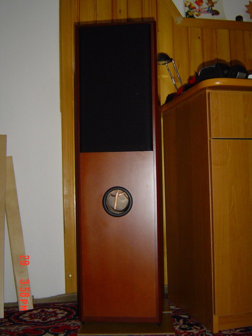

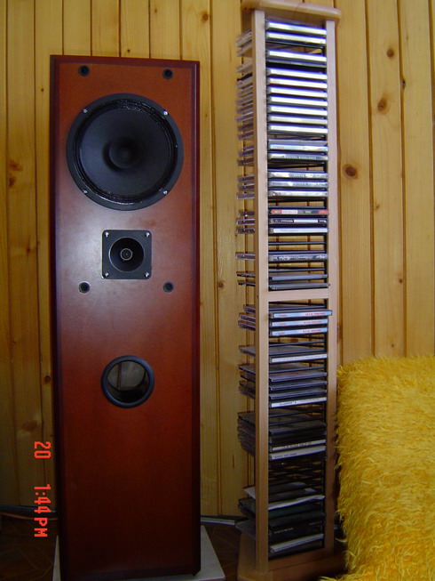

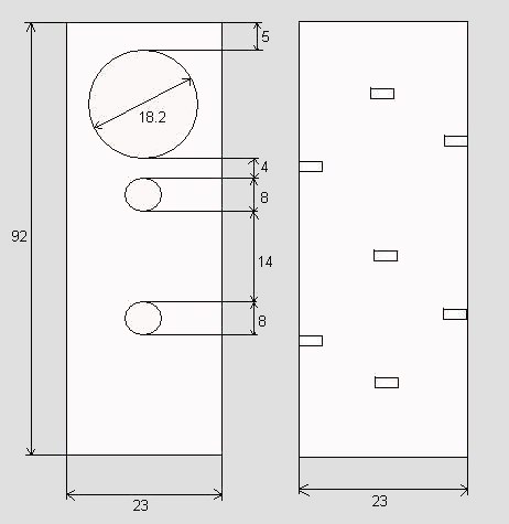

Hi all,
Here is my MLTL speaker using Monacor SP-200X fullrangers and Eminence APT80 tweeters. I designed it using Martin King's tool. I can hardly imagine something better for the price (you can get those monacors for 25 euro in my country...). Here is some pictures.
