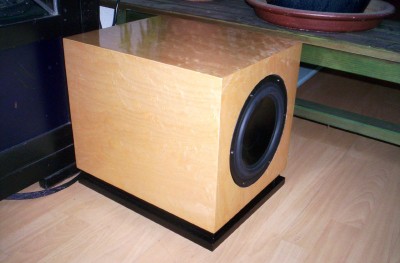

And the woofer...

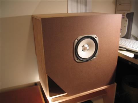

hi all;
Just wanted to show some pic.s No fancy cab, just something I built of material I had on hand. I would call it a blh. I made the horn mouth large so I could reduce the size easily. What worked best was the horn mouth covered with dense insulation; that brought the bass out. using a test cd, the output was very good in the40-60 hz area.Front and back panels are 1-1/4" thick. Outside demensions are 20x20x13". The horn exits out 2 cutouts.🙂
