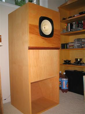

this is a picture of my beloved Bicors; I was offered an old pair of enclosures that I refurbished using an electric sander and two coats of primer. They still need the finishing coats, but I cannot decide on the colour.
Drivers are Lowther PM6Cs, modified by Mr Stamm (former Loth-X). They sound truly excellent IMHO, lacking most of that infamous "shout". No tweeter needed either.
These are modified Buschhorns (smaller CC, additional bracing). Unfortunately they are not perfect, as they are made from 12mm MDF (wrong thickness/material) and resonate at times. With the right music, they simply disappear. I just have to build them again with 19mm plywood, which I'm going to do this winter. It seems my GF loves these speakers even more than I do. Strange.

Same speaker, same story in my house 😉 My girlf is very happy with them. From an aesthetic point of view they are proportionally just about perfect I think, that was one of the big factors in my choosing to build a pair. Of course, let's not forget they sound superb too and offer great versatility. Coredump, those look very impressive in red now!

My wife also loves the B'horns, (must be something genetic no?)
A tad more bass would be nice at times, but their ability to disappear, combined with their size, makes 'em a winner Chez Moi!

Thanks! And, as expected, it was a real PITA to get there. Red seems to be one of the colours that need more coats than others until it's solid. Nine in my case, with a good (and careful) sanding between every coat. This alone is a strong enough argument for me to use real wood with my next enclosures. ;-)

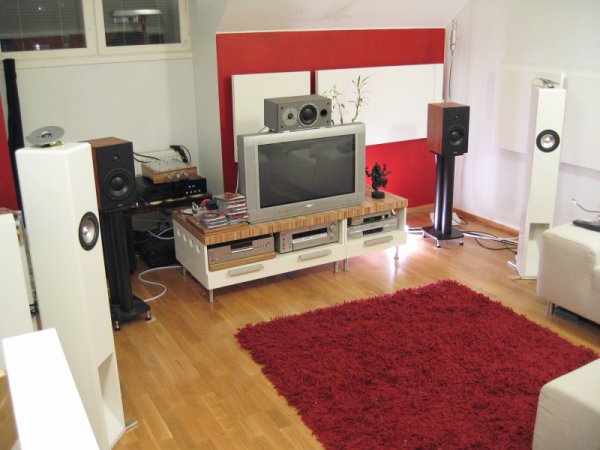

Jordan JX92S in GM's ML-TL box (not as wide as original). (Dynaudio Audience 52 and 42C in the background)
Listening distance is 290 cm (60 degree triangle). At the moment the speakers have been placed with their axes crossing atleast 100 cm in front of the listener. This way the side wall reflections decrease conciderably. Also the upper frequencies roll off rapidly. I have added high quality tweeters on top of the speakers and aimed them upwards. The cut off frequency is about 12 kHz, but I intend to raise it a few kHz.
The sound stage is now incredibly accurate (too accurate with some recordings). High frequency response is airy and sweet. There is no more sibilance and hardness in the sound.
I recommend trying this kind of configuration. Doesn't cost a dime if you have a few tweeters and caps laying around

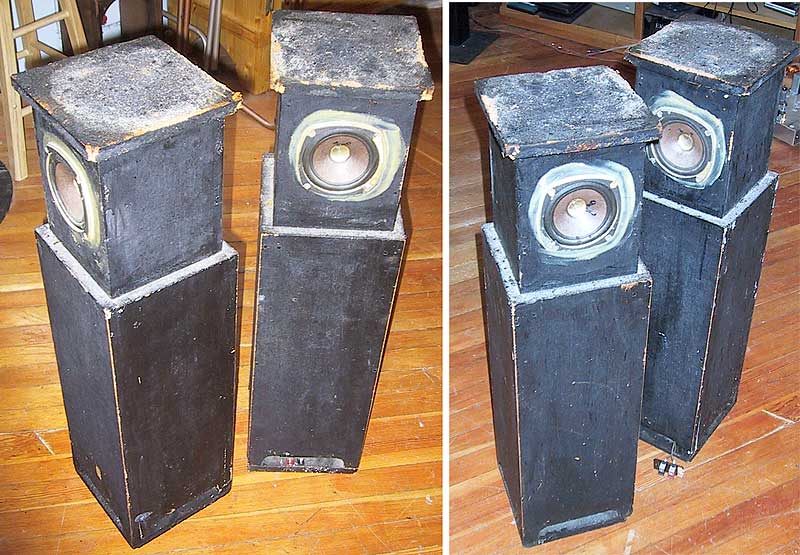

Fall 1974. Christmas present for my brother. They came back this summer.
Today we'd call this a bipolar alphaTL. Back then we called it an EPI MicroTower clone.
Seems they are back to the future. Been a long ways between them & here. The latest off the drawing board are amazingly similar.
Soft on the top off axis, but quite surprising.

A lot of older designs are good. No reason why they cannot be revived.

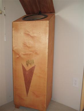

Here is a design I built which I made use of for a few years; used a full range 12" from a Baldwin tone cab.A modified "ace"design with an angled top face. This worked excellent with the 2a3 tube amps I was using at the time.🙂
