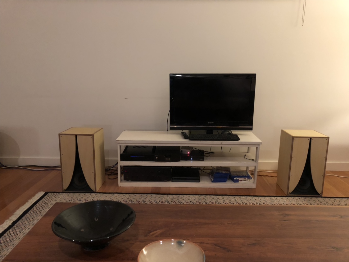

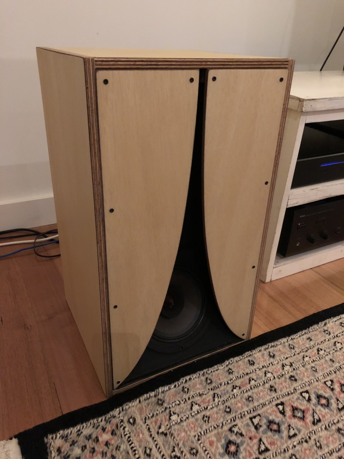

Karlsonator 6 with Dayton Audio ps180 drivers. View attachment 758868View attachment 758869
These boxes are LOUD. They throw a soundstage out and up.
They also do great job taming the ragged highs of the wizzered drivers. I don’t know why that happens but I like it a lot.

I first tried these drivers on an open baffle crossed to a woofer, where they sounded terrible. Like needles head on and buried under a blanket everywhere else. The k-slot works wonders to disperse the treble.
There are lots of threads on other sites with disparaging comments about the negative effects of the slot on the response. So they might not be HiFi, but I don't care since they sound so engaging. I've made a few boxes and baffles for full range drivers before but these are the first I felt I needed to comment on. Music fairly leaps out of them.

Amp is a Denon POA-2800 plenty of power too much for these. Not corner loaded, I just was in a hurry to try them out they wound up next to my main speakers. The side walls not in the picture, are bout 5 foot away from the speaker, and its about 5 foot to the back wall. They are very shouty, I am currently reading about baffle step correction.
Do you think placement in the room will help with this much?
Any advice appreciated.
Thank you Dave
So far this has been a very fun build(winter project), planning to veneer them.
That driver, that horn, you really want to have the mouth near corners to get sufficient bass gain.
The drivers are also designed for highish output impedance amps, which i strongly suspect yours is not. You can see what working to fix that does by either using a series resistance or real skinny speaker wire.

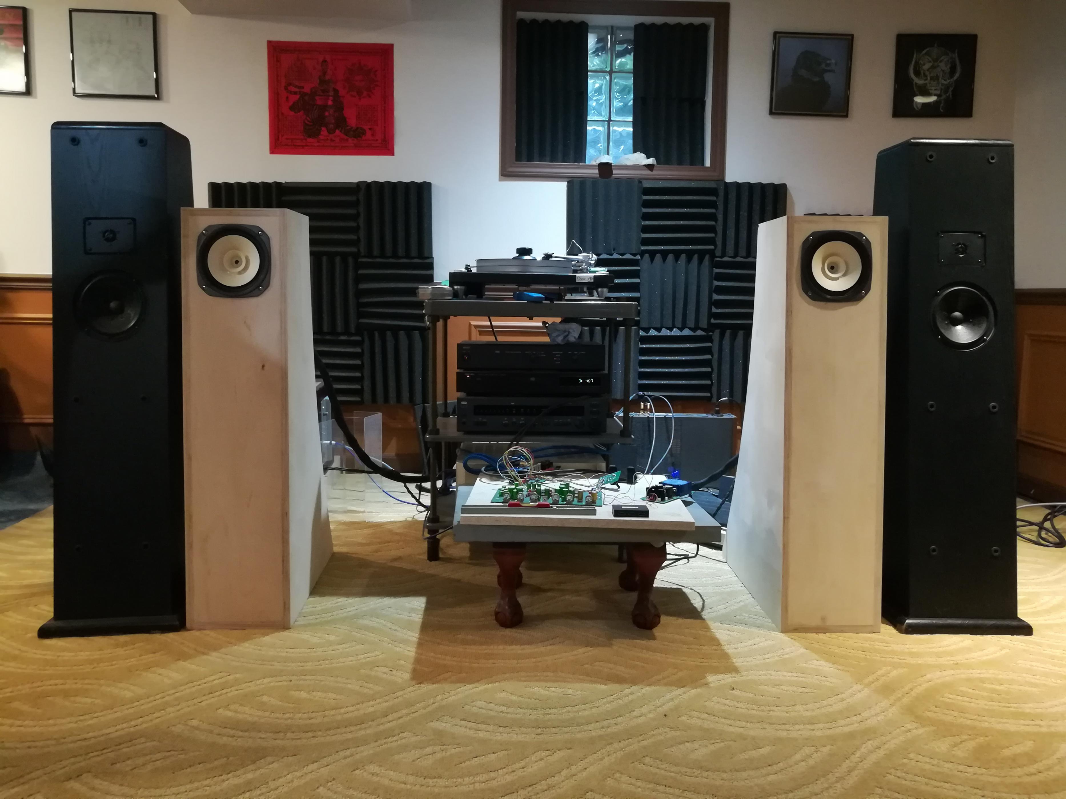

Im now building a pair of floortanders for them. Modelled with winisd. Cab came out pretty huge. But i managed to shrink it down a little for what i think is the compromise. Will post update in 2-3 weeks time. As im busy with Real world Responsibilities🙂🙂🙂:any updates ?
