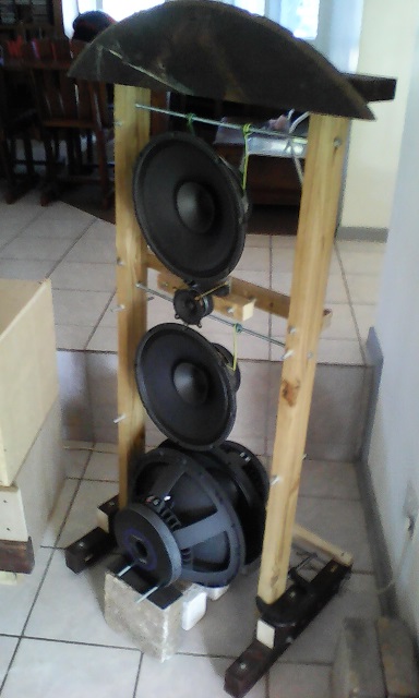

Another take on Vic's (Trans-Fi Audio) build. Prototype loosely based on the Bastanis Mandala (twin widebanders) and coupled dipole on Vic's arrangement. Celestion did this moons ago with the SL6000.
Woofers are sitting on bricks but will be hung in a separate frame which will slide into the main frame, thus completely isolating them from the other drivers. Frames are simply pine brandering.

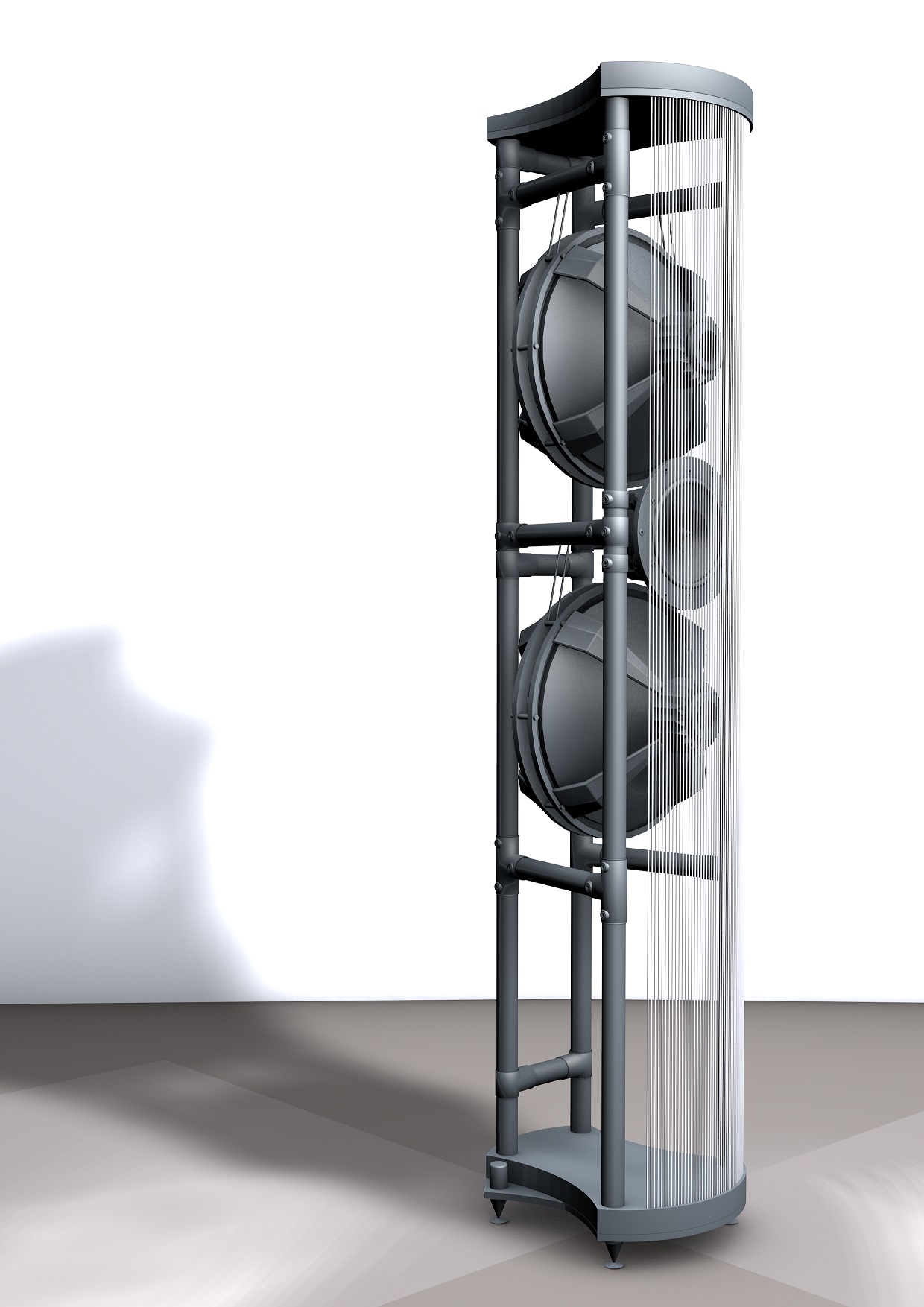

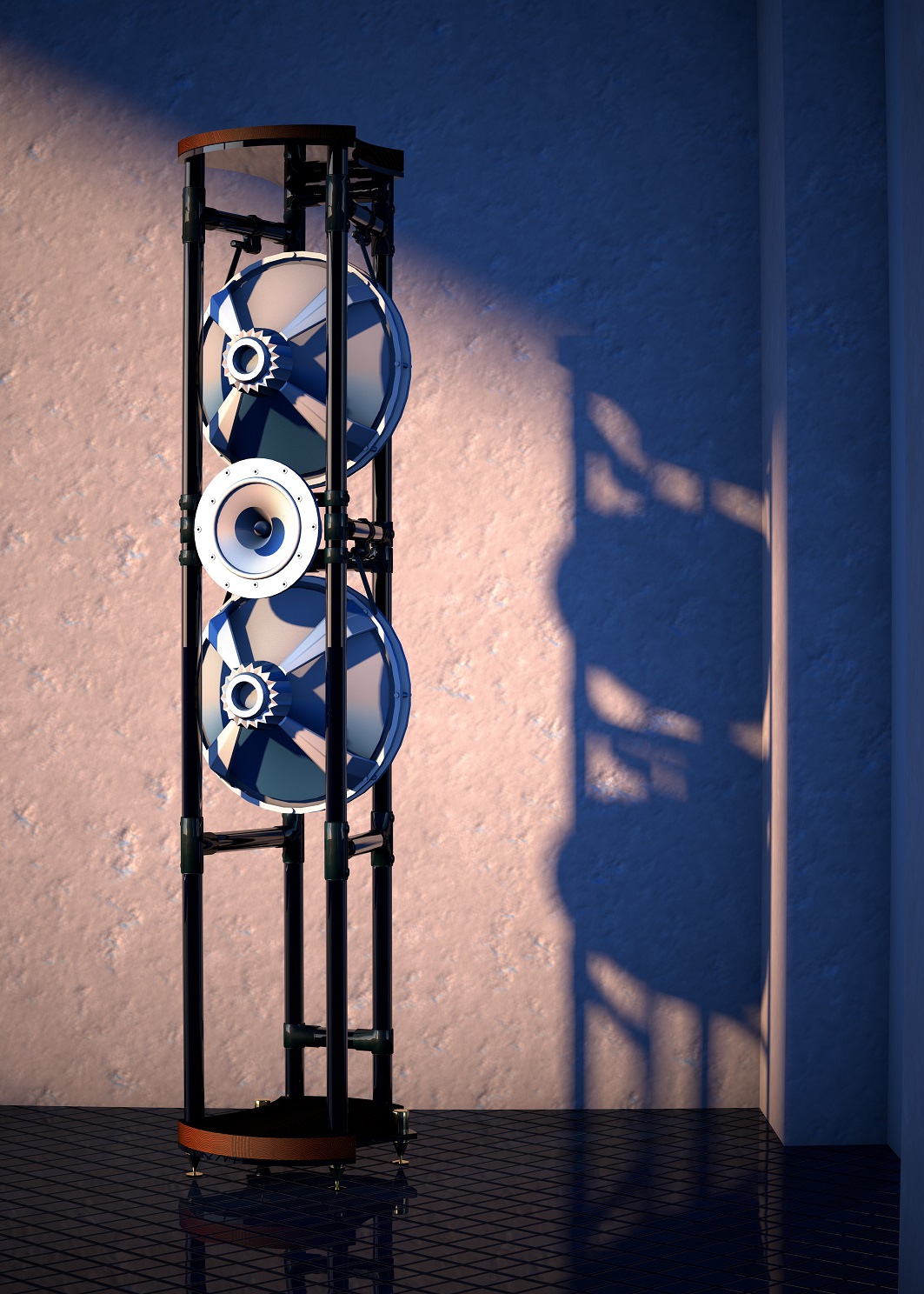

The phantom baffle - coming soon
Hi all,
Yes this project is inspired by Viktor's TransFi system. Although none of the ''scientists'' have not confirmed that it can work, I believe it will be.

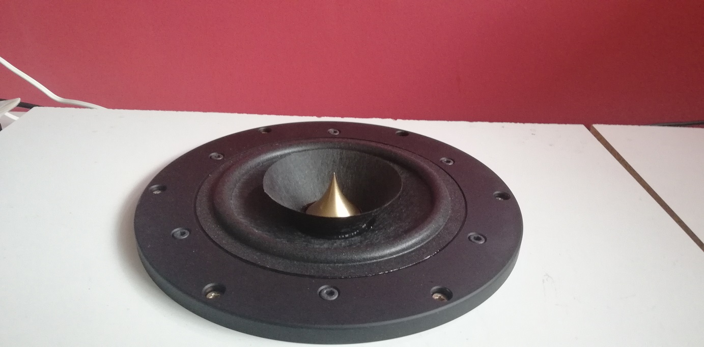

The full range drivers are SAL SAL 08C08, you know. Frank made them for me as the last pair in the world maibe. Special edition with golden phase plug.
Woofers are audiophile-grade 15” open baffle woofers, OB-A15Neo, were designed and manufactured specifically for Open Baffle and for PureAudioProject.
The strings in front of the speaker are textile braided hat rubber from haberdashery. It's not my idea. First used by Sonus Faber, today uses Gryfon Audio. I don't know yet if I'll use it.
