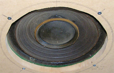

Front view, showing enlarged tweeter cone with foam damping ring to reduce edge resonance, and 3" dust cap. Cloth surrounds treated with bitumous "stuff" I treated the cones, as advised by Norm.
The mods were carried out 27 years ago, by Norm Edge, Melbourne Australia. Including 8 ohm vc. and spider. They are now 40 years old.
Still working extreamly well.
Mounted on a test baffle/ corner enclosure.

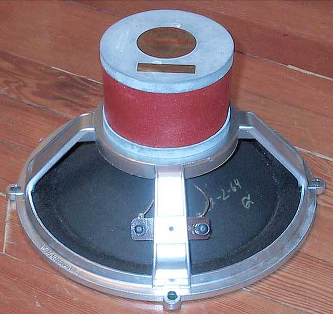

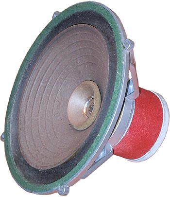

err, yeah, they are a bit rough n ready. They were in cupboards for about 15 years, I was in a hurry to make some nice sounds. And my new landlady said I could play my records as loud as I like!
They should really be in 3.5 cub ft enclosures, or TLs, which is where they look like heading, once I learn a bit more about them.
On that, Wharfedales should be mounted on the rear, unless you want to machine the baffle to suit, or as I have on my other set, 1/4 lb of silastic! The rear of the rim is not flush. That's why they have the green felt gasket on the front.
Has anyone tried these in QWTLs?
Geoff H said:The rear of the rim is not flush. That's why they have the green felt gasket on the front.
I've had a few thru here. It wouldn't take much to front mount them....
dave
My other pair are 64's, like yours. My Father bought them, I scrounged them of him when he went B&O. They then went into new cabinets and presented to my mother in law. When I realised what I had done, I went out and hunted down a pair for me. The Alincos became my daughters when MIL passed away, now I have them back.
There have been many other drivers come and go, including Richard Allen, Philips, Peerless, Foster, Altec Lansing, but still have the Wharfies (and some 411-8As that need foam)
I never thought of them as being pretty, the alincos are I spose.
edit: Have you ever weighed them? I know many people say the Alnico's sound better (not just Wharfedales either). They both have 16000 lines in the gap. I think mass may come into it. I never a-b ed mine before the mods.
Geoff H said:edit: Have you ever weighed them?
After they were packed. Can't recall what they weighed. I do have a couple less than perfect ones downstairs (ceramic) i could put on the scale.
dave

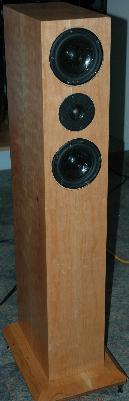

Proac Ultima
My rendition of a special PROAC.
It sounds great but I would like to know how I can tweak the isolation inside to make it perfect !

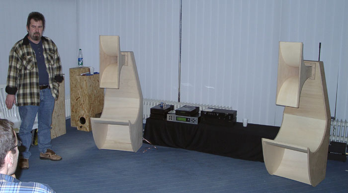

FE127 in a Horn
more you found here: http://www.hornlautsprecher.net/Index/FE127-Horn-01.htm
The mounting of the Fronthorn take effect of directionality. Sorry, my english isnt good.
Have a good listening!
Peter
Peter

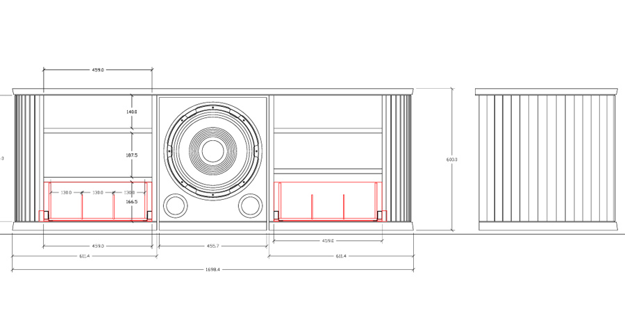

Here`s my latest project.
A rack with an integrated subwoofer to go with the BryLar Lowther speakers.
Here`s a link to how I made it:
http://www.diyaudio.com/forums/showthread.php?s=&threadid=91206
Lars
Lars
