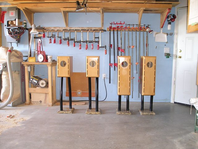

My whole fonken family
I guess I better send out photo of my fonken family. This is a shot I took last week in the shop. I have done some driver mods and have the fonkens hooked in the living room right now. The Bifonkens will be set up later. The intent is to also make a pair of fonken subs with Extremis drivers.
Right now I am driving theFonkens with a Mini A and am very happy with the sound. I use a sub crossed over at 80 htz and things sound real good to me.
Enjoy
Enjoy

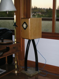

Re: My whole fonken family
I love the 'walking' stands - are those DIY too?
Stands
Hello Ropie:
Yes the stands are DIY. I have been branching out and working with new materials. The legs and top of the stands are aluminium and the bases are polished granite.
It is fun to work with a mixture of materials. Both the aluminium and stone were salvaged and re purposed.
Hello Ropie:

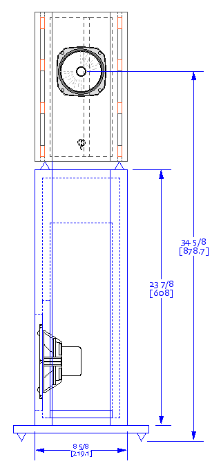

This won't be an onken... it is just a FonkenWoof... 22 litres tuned to 27 Hz, should be good to 20 Hz with room lift.
Preliminary sketch attached. Vent is 19" long.
Since the miniOnken box is the same size, this is also the add-on woofer to your miniOnkens to make a RAW HT3 or HTFR on steriods.... Al has a very simple passive XO for the Extremis to the FR. Don't know if he is willing to share.
We have all the parts here or on their way. Lots of other things in the queue ahead of them thou.
dave
vinylkid58 said:You won't like the numbers for the Extremis 6.8 in the Onken xls calculator.
dave
