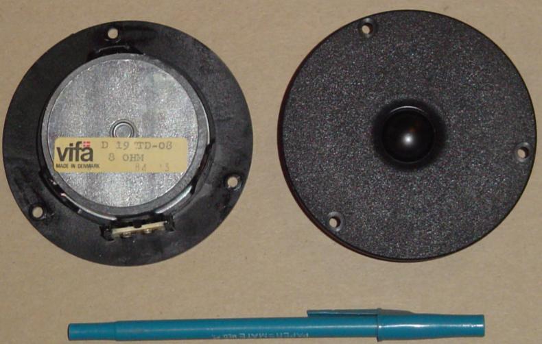

3/4 " tweeter..
Dave,
salvaged 3/4" Mission "700 Series HF"
Not sure who Mission used at the time. The tweeter has a custom face plate w/Mission on it (most likely Vifa or Seas). They do sound nice and with the salvaged X-overs from the old Wharfedale Denton lls , they sound great. The whole baffle "sucked" until I added the tweeter. The J10s had a nasal quality about them. I believe a better "fullranger" would be the answer, "but dammit Jim", they're so nice to listen to, I don't want to change a thing not even '🙂' take em apart to finish.

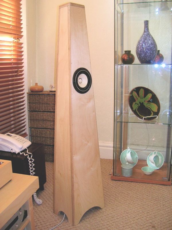

Here is my little Metronome speaker using the Fostex full range FE108 Sigma driver
helped out at the bottom end by an MJ Acoustics Pro 50 Active sub.
It's a quadratic tapered mass loaded quarter wave resonator enclosure.
The mass loading was designed by Scott Lingren with Dave Dlugos of Planet10
Arty birch ply quarter wave cabinet by me.
