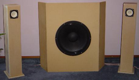

FE127E Sealed Bi-pole
Attached is a picture of my most recent pair of speakers. They are a pair of sealed bi-poles (23L) using the Fostex FE127E and built from MDF. Many thanks go out to Mark of www.mach5audio.com who did most of the woodworking. The wife pleaser in the middle is an experiment of his. A 20" sub in an open baffle. See the Mach 5 Audio Testbed for more details.
Initial impressions were very positive. The FE127E goes much higher than we both expected. Good imaging with a very strong mid-range. With the sealed enclosure, you get excellent cone control, great mid-range and the ability to develop moderate to high SPL. The mid-range is much better than that of my BD-Pipes and the FE127E is more extended than the Radio Shack 40-1197.
The test setup was Luxman pre, Beringer DCX, Luxman power. Cross over points between 90 and 120Hz were tried. 90-100Hz worked well with the 20" sub. It was tough trying to place the speakers as we found the 20" sub was often in the way of the music. Very pleased thus far and we expect even better results with a tube amp.
Overall, I am very pleased with the results from this very simple project. I will get a webpage with enclosure plan posted soon.
Gio.

Geek said:Hi GG,
Very well done aesthetically 🙂
What finish you have planned?
Thanks, I like the long sleek look. I was thinking of painting them a cream/banana color similar to the cone. However, I am open to suggestions. I don't think I am ready to try something like a veneer at this point.
Gio.

I like the fullrange concept very much though some recent experimenting showed me how better a fullrange driver could work if not used "fullrange" but "extended range", i.E between 150Hz and 6kHz. I think it's the way to go to get big, coherent and refined sound.
I am coming to the same conclusion. The smallish full-range drivers seem to sound best when they are not subjected to the lower frequency range. With their tiny Xmax, they often run out gas as low as 80Hz even at relatively low SPL!
Keeping the bass away from these little full-rangers results in a much improved mid-range and you can get moderate SPL from them.
Gio.

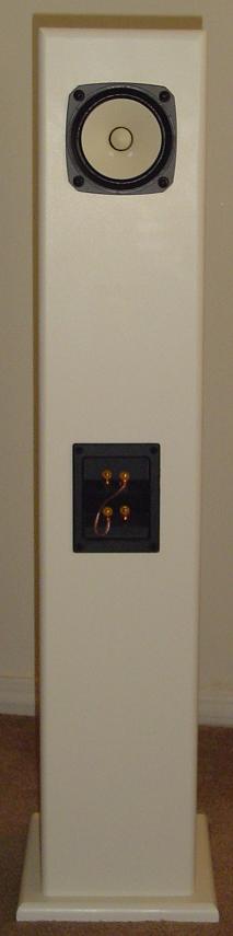

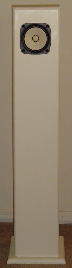

FE127 Sealed Bipole - Finished
I got a finish on my FE127E sealed bipole project. Two coats of a sealing primer and two coats of a cream paint. They turned out pretty good. Did a fair bit of patching and sanding and there are still a few blemishes. Getting a near perfect finish would require a lot more skill and patience. However, I am very pleased with the results.
The FE127E is very revealing and you most definately want to match it with a good amp.

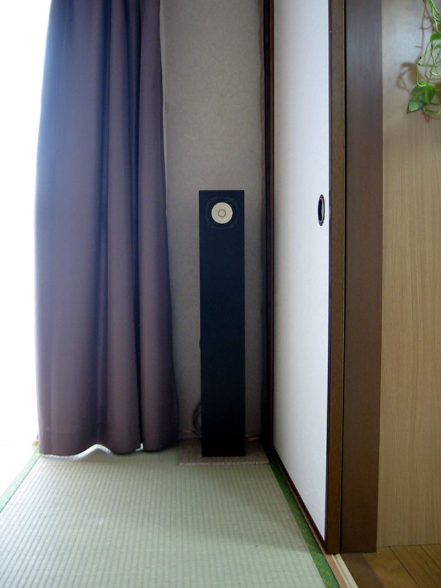

FE107 BR for Tatami-room.
Hello,
This is a project I recently finished. My design intent was to create a speaker that would fit into my Japanese-style tatami-room, and offer a decent soundstage when the listener is seated on the floor. The focus was on clarity at low volume levels, rahter than bass output, as the walls here in Tokyo are wafer-thin.
I used the Fostex FE107 and created a slim box out of plywood. Internally, I created a volume by using a PVC-pipe, and filled the remaining void between box and pipe with fine-grain sand. The results are very pleasing, altough this driver offers a rather narrow soundstage, perhaps something an upgrade to the FE108sigma would rectify?

Re: FE107 BR for Tatami-room.
If they are living in the pictured relationship to the side wall, i'd gues it is more like a placement issue... FE107s should image like crazy.
dave
Bonicon said:The results are very pleasing, altough this driver offers a rather narrow soundstage
dave
A cheap and cheerful test is to toe them in so they cross at a point about 25% the distance from the listener to the speakers. The technique's popped up in some of the British mags. I recall Jordan also recommends it. An FR driver's narrow dispersion at high frequencies will work to your advantage in reducing the side wall reflection. Those drapes will also be your friends.
Yes, I have been playing around with toe-in, but there is more tweaking needed...I have less than 8 hours of listening to them at this point, so I guess there will be improvements. Initially I was going for the FE108 sigmas due to their stunning looks and performance, but I decided to keep this project relatively low-cost, and settled for the FE107...maybe that is what haunting me. Oh well, there is always the next project.
I checked out the Frugel Horn last night, that one looks very good considering the circumstances I live under now (a mold problem in my last place forced a move to less...representative quarters), and from what I understand it mates real well with the sigmas.
However, the first priority will be a SACD-player, I'll head over to Akihabara on Friday and rummage through some back-alley audio-shops, maybe I can find something some reasonably priced used gear.
