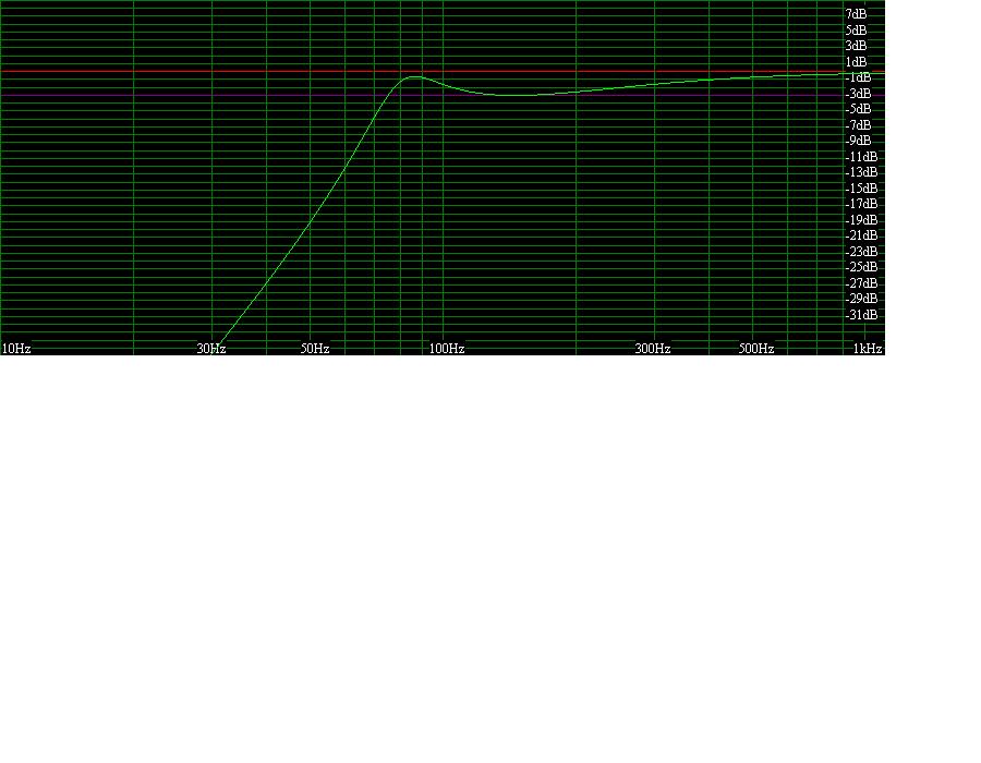

No they are FE126e in a 11.65 litre BR cabinet.The frequency response is 55hz-25khz.I wasn't sure these low QTS drivers would have any bass in a BR but surprisingly they do.I picked the 126e over the 127 solely on the higher sensitivity.These definately don't need a tweeter at all and the bass is very satisfying to me.

Hello Dave in the photo I hadn't drilled out the port hole but I have done it now and it is in the front with a 2" diameter and is 4-1/2" long.
one1speed said:Did you find that the port helped things at all?
No not really if anything the speaker seems less effecient.The bass may go a taaaaadddddd lower but it isn't as defined as sealed.The speaker some how sounded louder sealed.I ordered another set of baffles to A/B which way sounds best in my room.The port is tuned to 60hz but in room I can get bass in the middle 50hz range.I also mounted the driver too high up the baffle which cause the Fe126e frame to get in the way with the speaker grill frames.I will mount the driver a little lower so I can use the grills.

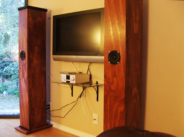

Nice! Care to share details? Driver, etc?
gychang said:surprisingly great sound, including the base from $11/each speaker. plywood and hardibacker cost more.
