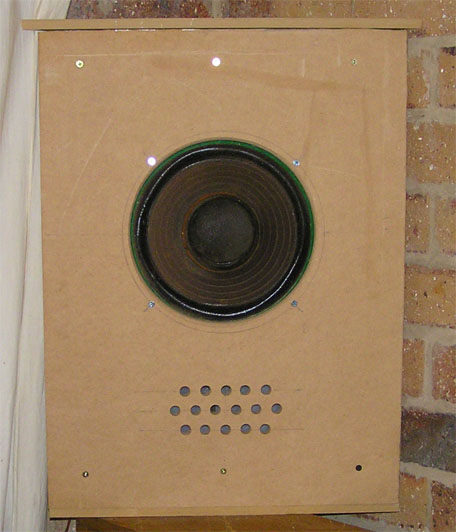

Some one say aperiodic. Got to the baffles on my Wharfedales today.
Radius on the cutout, and 16 1/2" holes. (based on a 2" dia port to tune to 38Hz) This is only 1 cubic ft of enclosure.
Better bottom end than my bass helper which is now collecting dust.
The idea of venting the cabs was to relieve the back pressure on the cone. Did that all right, and a bonus, now true full range, and higher SPL.
No measurements as yet other than SPL on music. High 90s at 3.5 metres (where I sit) with no sign of stress.
Back to the music,
Geoff

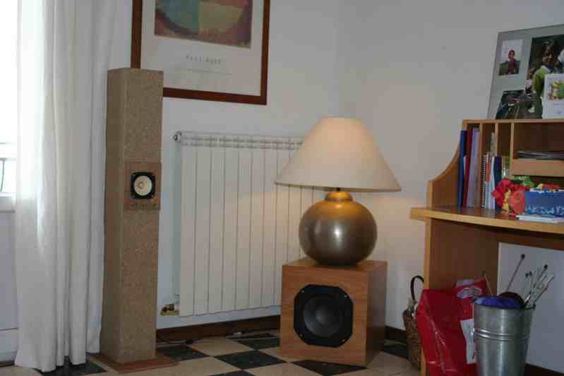

My test-bib
Well, my first shot at the BIBs...
Just a test model: 125 high, Fostex 127e, Smouth as per Zilla's pages (The smaller one)
I'm gonna make some new ones, in MDF, with the larger Smouth.
Pity MDF comes in 122cm sheets, not 125.... But I'll find something.
I'll feneer them like I did the sub in the corner (10" el cheapo LT0ed thinggy)
Cheers, Bibster

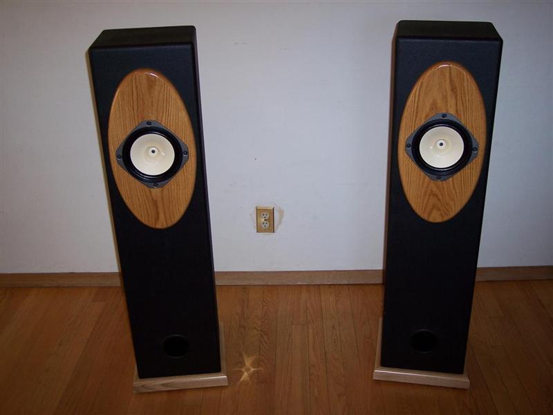

FT-1600 MKII
I finally finished my FT-1600 MKIIs. Bought the plans from Bob Brines. They sound great. I still need to get the BSC on there. Partsexpress is back ordered on the inductors. 😡 I am very please with how they turned out.
