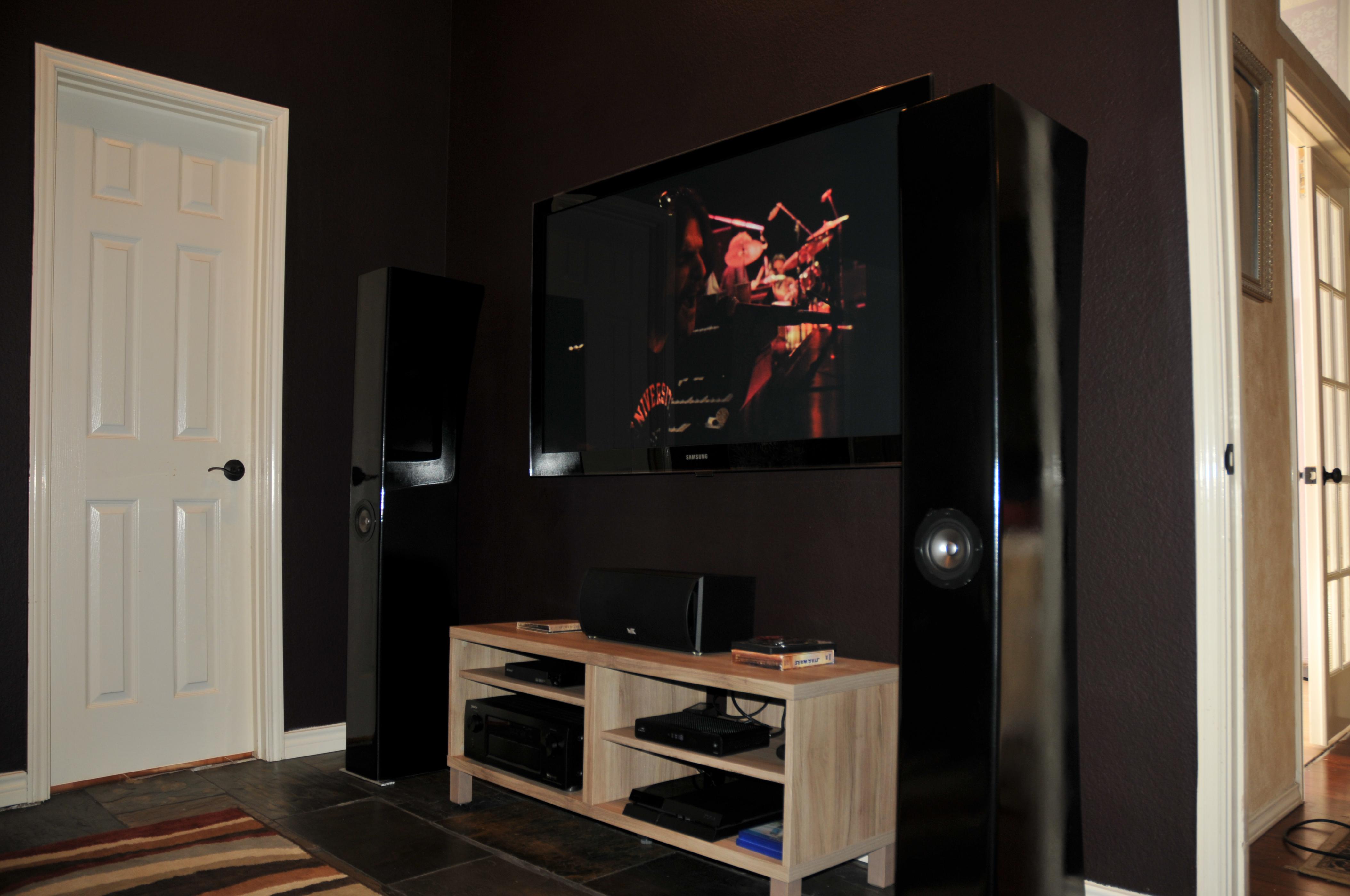

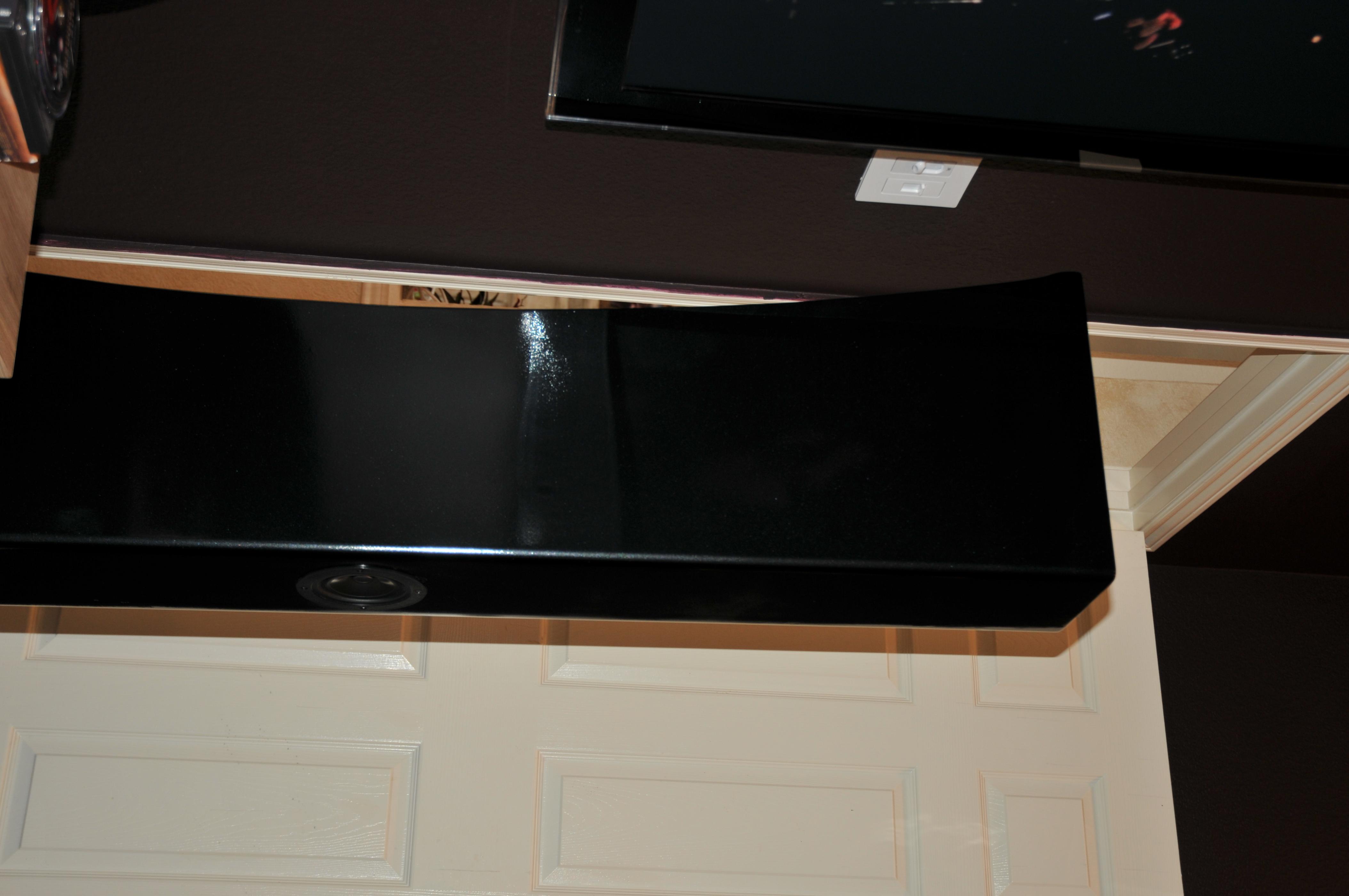

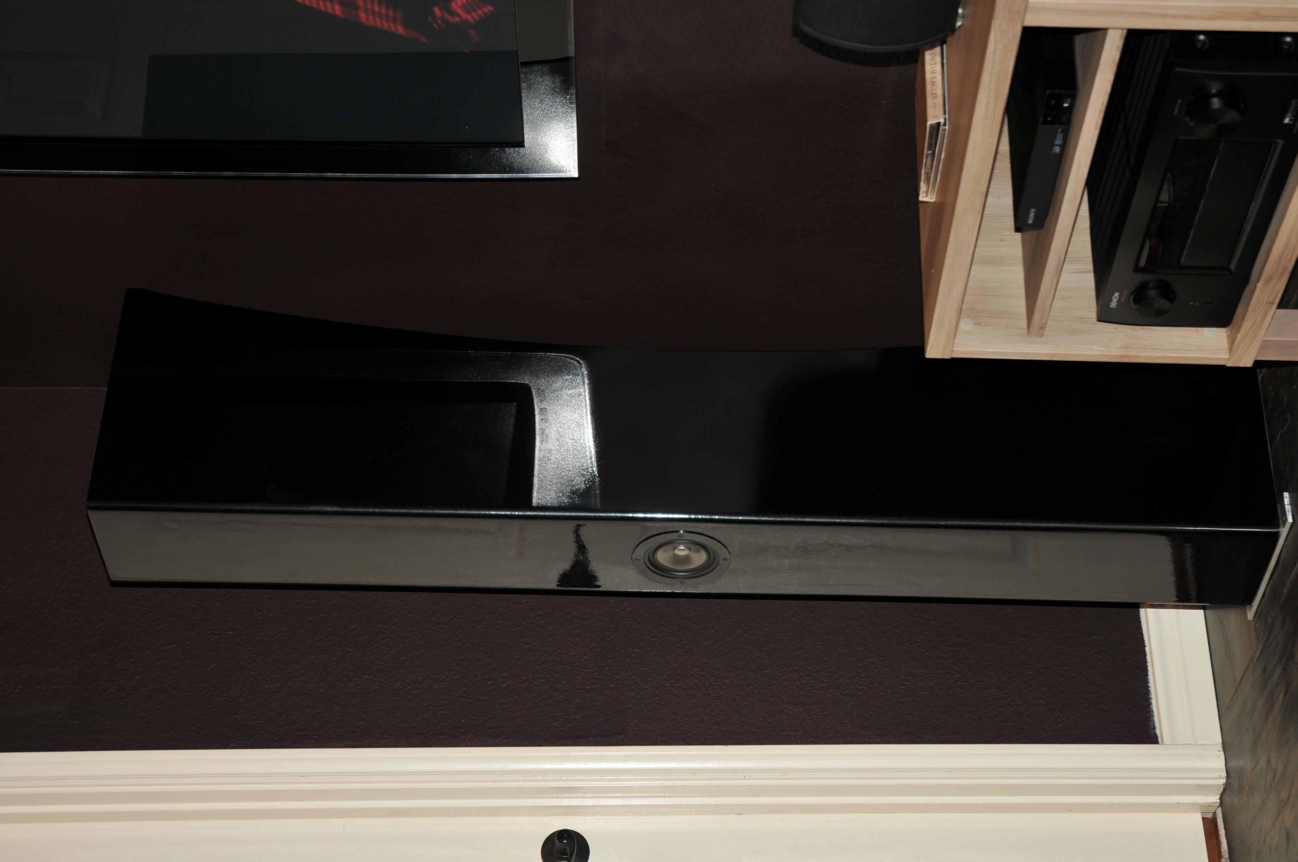

My Maeshowe Horns
I just finished these today and am listening to the "History of the Eagles" Blu ray. They sounded out of balance and flat before Audyssey was ran, but after they sound great. I finished them using auto paint and an HVLP sprayer. I wet sanded after the first coat and then waxed and buffed them twice after the second. They turned out pretty good, I am a perfectionist when it comes to this sort of thing so I have picked out all the flaws! These took quite some time because when you spray them and try to get an automobile type finish the body has to be perfectly prepared. I went through 4 cycles of priming,filling and sanding. The color was a gray/black metallic pearl single stage paint from "The Coatings Store" which is an online retailer.

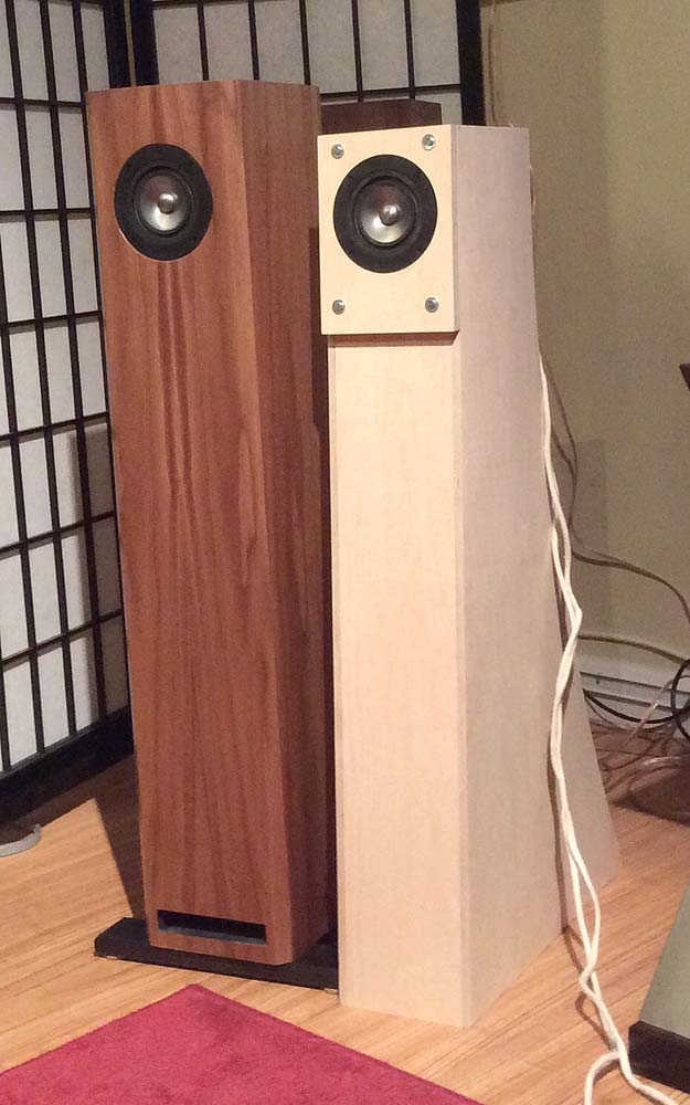

Just sat down to a short comparative listening session to the new Mark Audio Alpair 5.2- FH- lite (raw 1/2" ply), and an MLTL by Dr Lindgren (black walnut veneer)
No conclusion yet as to preference

Oh, btw - in the meantime, I think I have reached a conclusion

Shiny!
Ray21
Please, I would like to know your comments about any issue placing the speakers in a room layout like yours, regarding stereo image, not bass, sub turnned off. Left speaker is near a closed corner while the right one is near a open corridor.
Thanks for comments and sharing good woodworking.
Both cases are showing the left hand enclosure in or very near a corner. Whenever possible I try for symmetrical placement in relation to side wall boundaries - but life has a way of getting in the way of your plans
I'd be inclined to try and pull the rear mouth horns out from the wall to give at least half a meter clearance while listening at least.
I thought the same thing when I saw the picture. Good advice!
Best Regards,
TerryO
Thanks chrisb. As you have mentioned rear mouth what if the horn is front mouth?
BTW that is yet a second crucial question to me, why designers choose front or back mouth?
Again thanks for clarification.
Back mouth allows you to use the boundary as part of the horn, allowing lower horn action with the same size mouth. But it is now dependent on that boundary being there.
dave
While near side wall boundary reinforcement will generally occur with non-dipole designs, something else that can happen with tall, double front mouth designs - such as several by the same designer as the FH3 and Maeshowe - is that a minimum listening distance is required for full integration of what can essentially be considered an MTM configuration.

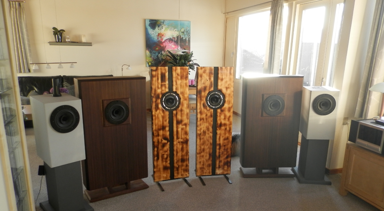

This is some off my speaker builds. Vented, horn and open baffle.
They all look very nice! The driver seems to be a favorite... which driver am I looking at?
R.
Very nice! I really like the dark brown with the wide baffle. Sweet 🙂
