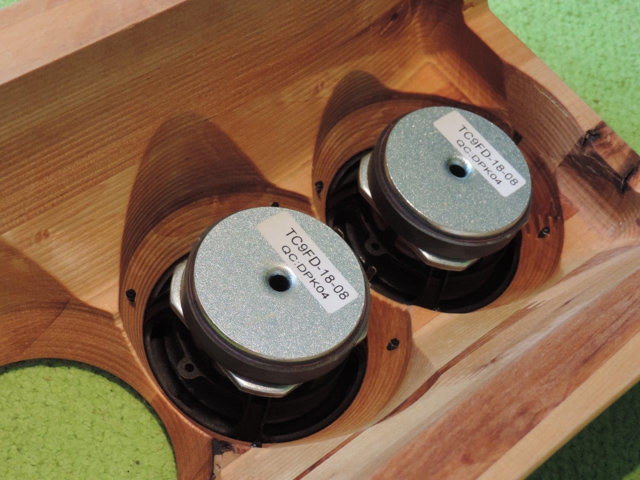

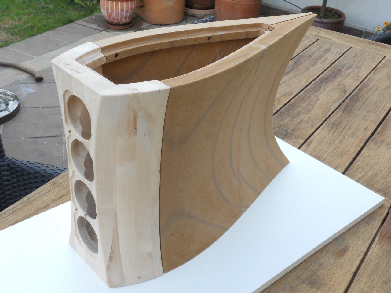

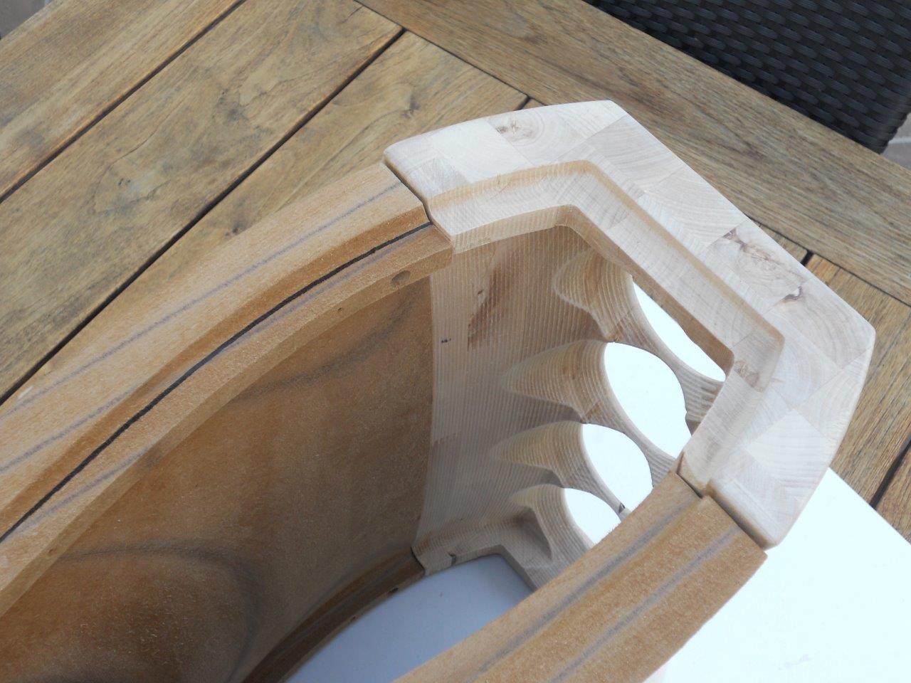

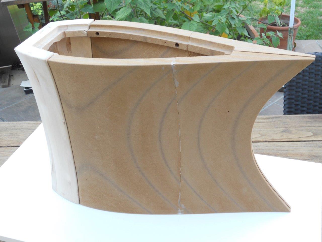

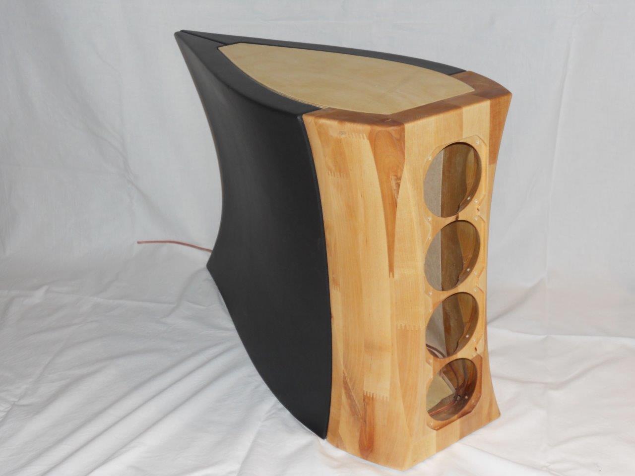

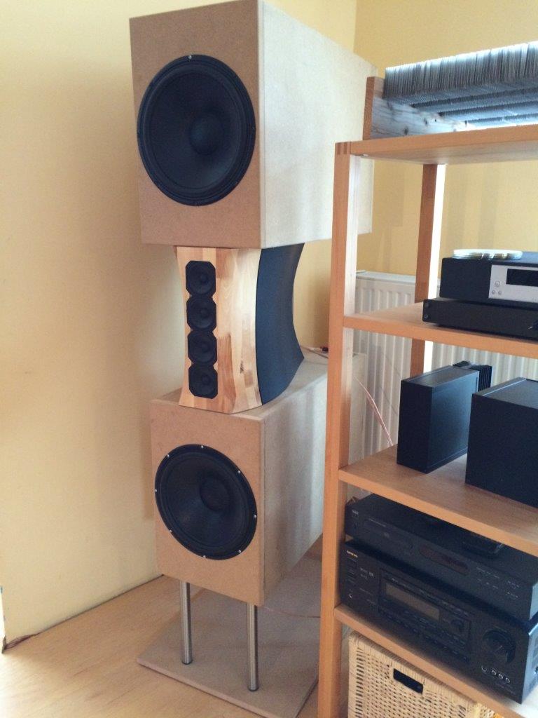

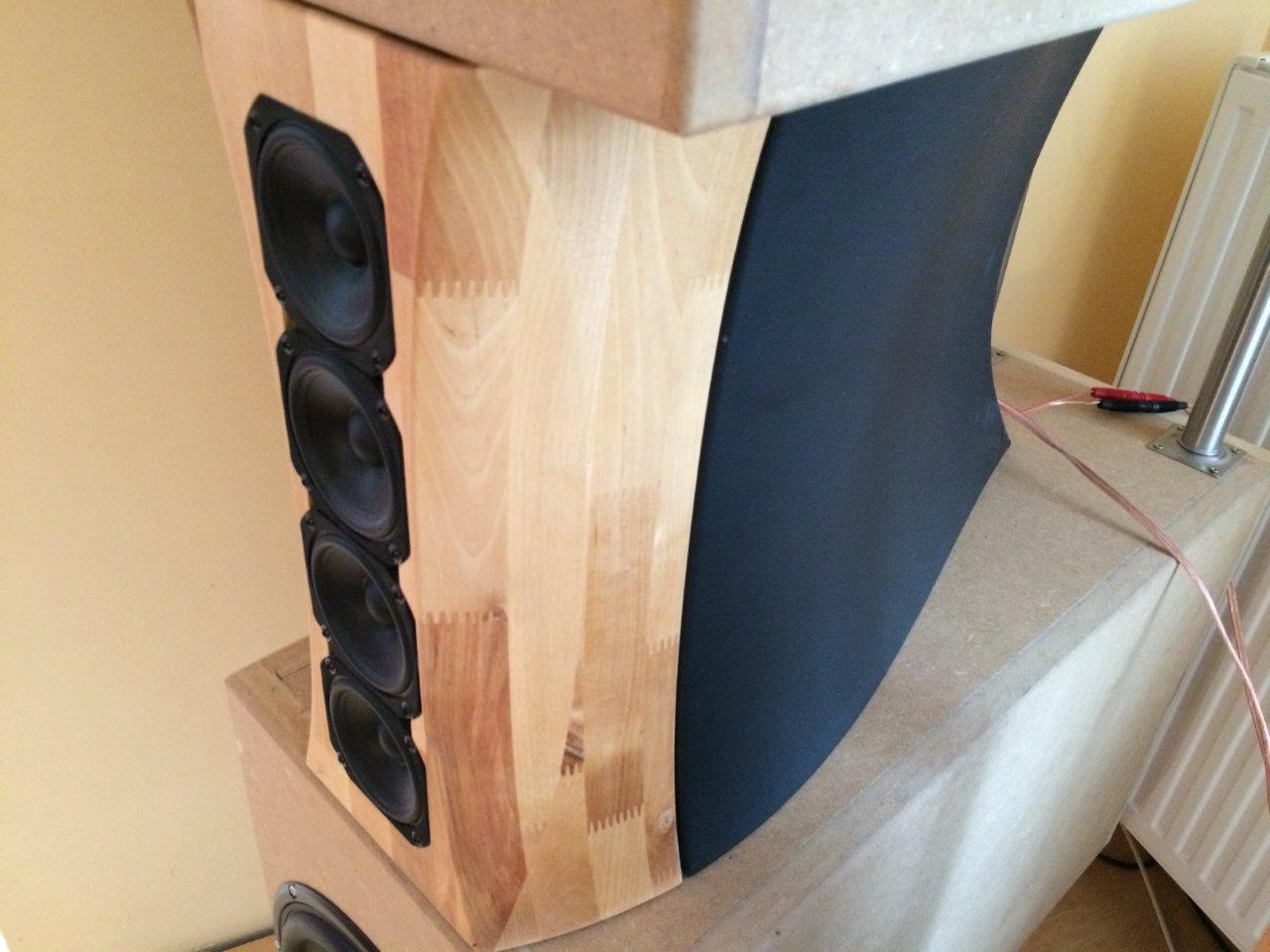

3D organic shape linearray
Building speakers using plane panels was no longer satisfying to me.
So I built my own CNC mill.
Here is my first 3D organic shaped design:
Front is solid birch.
Rear is MDF covered with black leather.
Chasis are PEERLESS TC9FD-18-08 wired two parallel and then in series.
The shape follows the B&W Nautilus idea:
Narrow baffle prevents early reflections.
Tappered sidewalls guides the rear membrane energy into something like an acoustic trap.
The result is an almost flat response from 200Hz to 16kHz without any equalization or filter. Between the chasis and my Aleph-X is only the wire.
OK, I use active crossover (Thel Audio) at 200Hz.
Another design feature is the linearray arrangement. This reduces the reflections from bottom and ceiling.
Sitting at the sweet spot is like entering the holo deck in terms of 3-dimensional soundstaging.
You will find some videos here showing my progress on CNC and milling this enclosure:
https://www.youtube.com/channel/UCfz4LGcU-UtLWpBZuPdCNgA
Hope you like my design.
Any comments are welcome.
Very nice shape. Marvelous. Bravo!!!
Sorta ruined by sandwiching it between the 2 monkey coffin bass boxes … there is your next project.
I wouldn't have used MDF, and they probably deserve a better driver than the TC9, our pr were quite disappointing. But if you are happy that is all that counts.
dave
I'd have used quality plywood… MDF has too much energy storage, emitting a time delayed ooz that masks low level detail.
Here it has the advantages of easy maching and it looks like a sort of plywood made with thick plies of MDF was used, plus the TC9 does not have very good DDR and since that detail is already missing, the MDF is not as likely to be a big deal.
