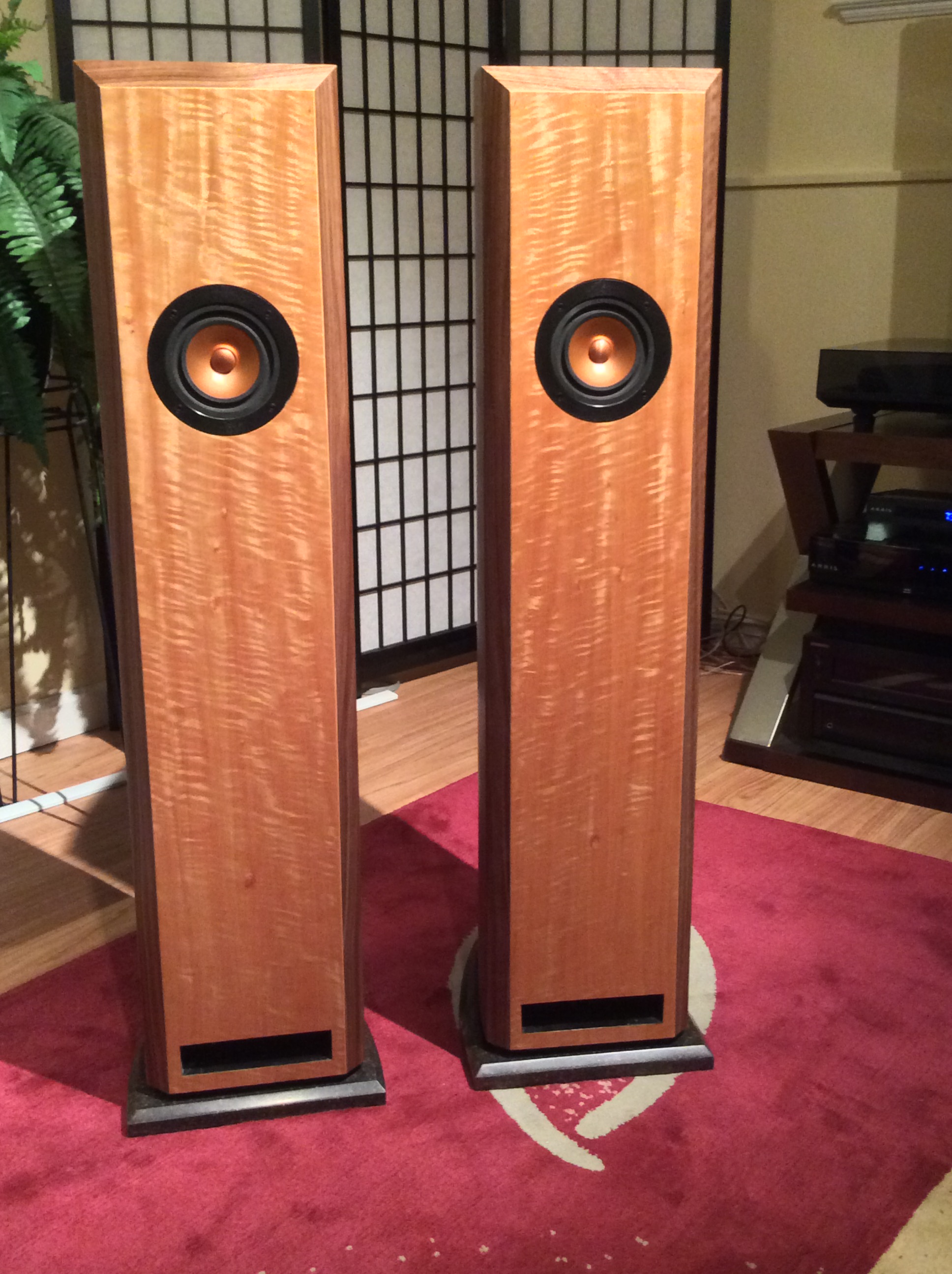

thnx Mario - they turned out OK, I could live with them - if it wasn't for the 8 or 9 other pairs in the back room

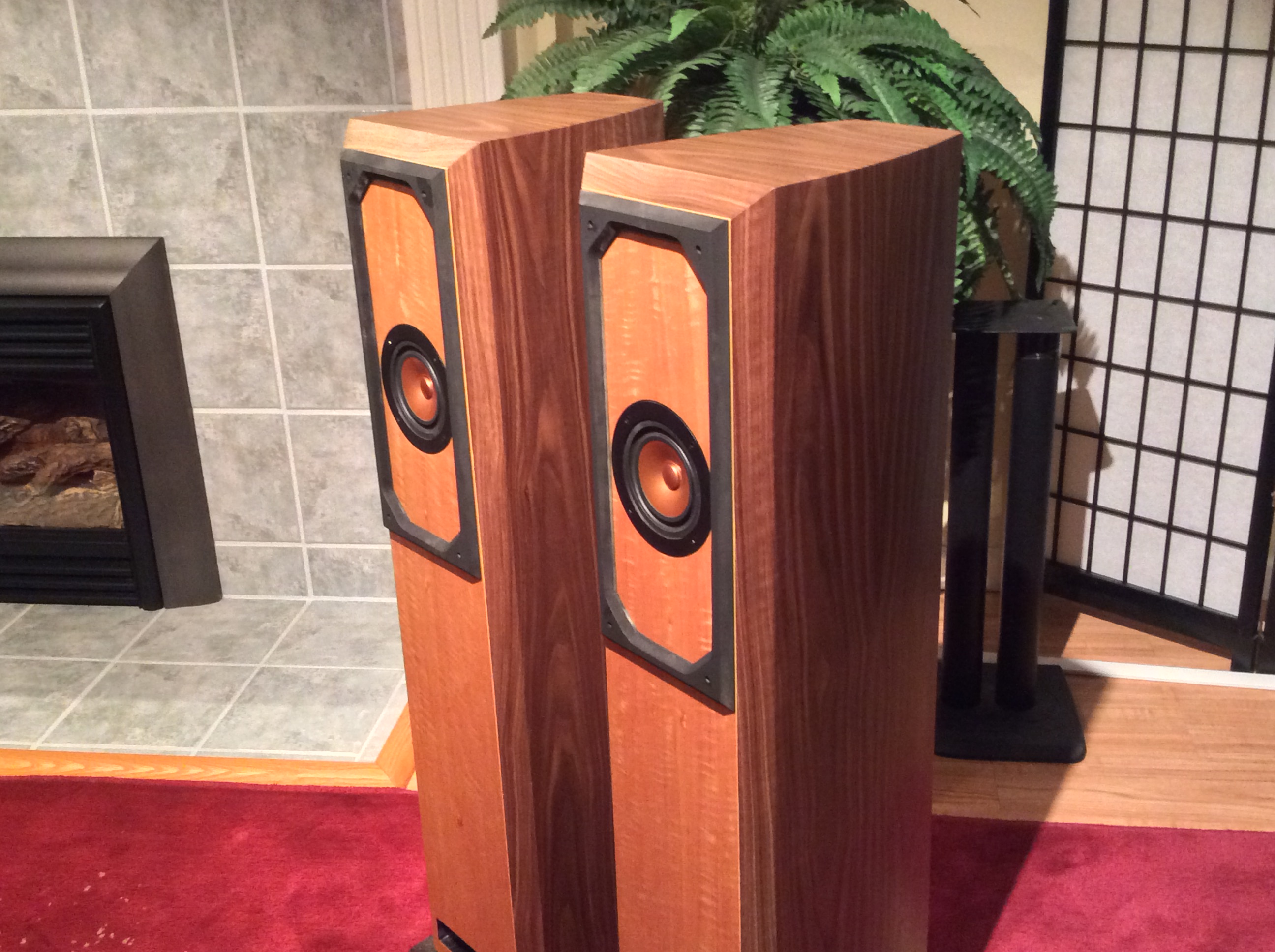

Stunning! I like how the colors of the drivers and the cabinets are matched. Do you use magnets to keep the covers in place?
yup, little 1/4" x 1/4" neo "rods" buried under the veneer - at a total of 16pcs or more per speaker pair, quite a bit more costly than velcro or hedlocks, etc that I've used in the past, but much more elegant, and they never break

Nice. Do you know if magnets would be possible if not using veneer? Say, if I use birchply and drill holes from the backside to put the magnets in. Or will the distance become too far for the magnets?
Also, now that 3d-printing is becoming more available, imagine 3d-printing grille cloth frames in plastic. That would greatly recude the weight compared to MDF and require less magnets.
Yes, the magnets can be loaded into the back, but it will likely be much tricker to get them to line up.

Perhaps that can be handled by making a pilot 0.8mm hole from the front and then drilling the magnet holding hole from the back using that pilot hole. Putty or veneer + glue would take care of the pilot hole if that is deemed necessary.
that'd work well enough, but the result would not likely be completely invisible
to answer Rullknufs - getting both the precise alignment and depth of holes for rear mounting would be tricky for sure, even if using a brad point (forstner) bit.
