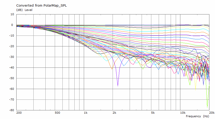

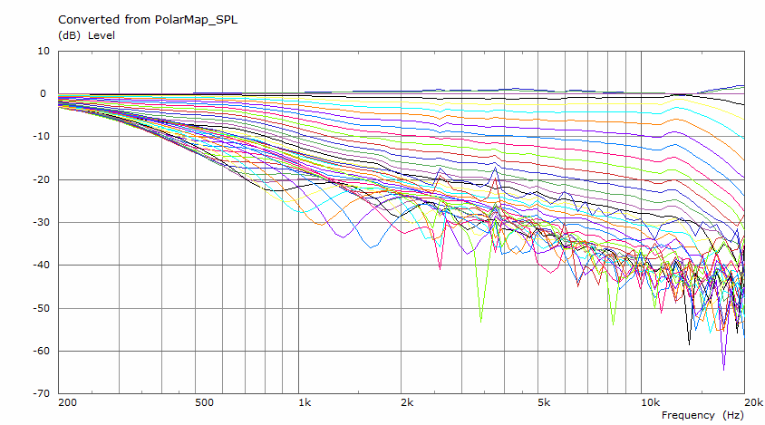

I ran one more case of the round over waveguide, continuing back in a cylinder to enclose the mid drivers, and then finally in this case, terminating in a baffle.
These look pretty much the same as in the earlier post so I'm satisfied there is no issue with bringing the waveguide+cylinder close to the woofer baffle.

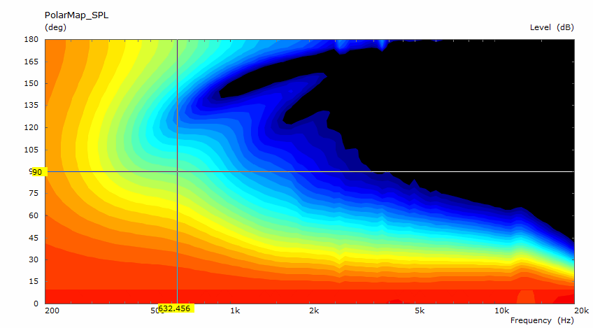

Looking at a larger waveguide opened up that can of worms about the HF performance of a waveguide vs its throat diameter, that is being looked at in the ATH thread. And going larger is the wrong direction, so let's look at a smaller waveguide, one with a 1" diameter throat.

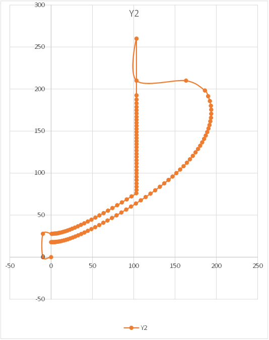

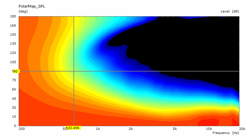

I used ATH to create a 300 mm diameter axisymmetric waveguide and liked the very first result that popped up
The benefit of the smaller CD exit diameter is immediately obvious: very little narrowing of pattern at HF.
Note that the pattern starts widening from +/- 30 degrees very gradually at about 2 khz but doesn't exceed +/-45 degrees until about 500 Hz.

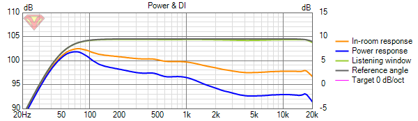

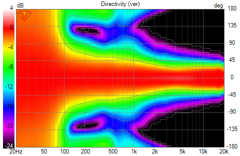

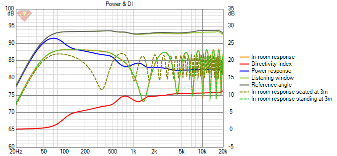

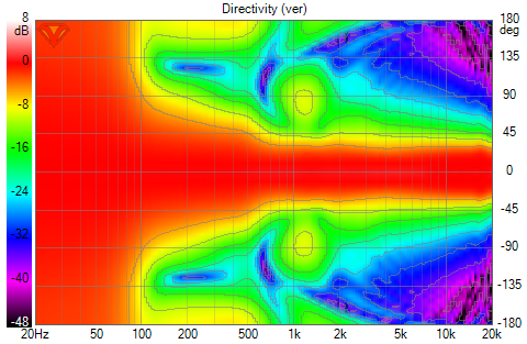

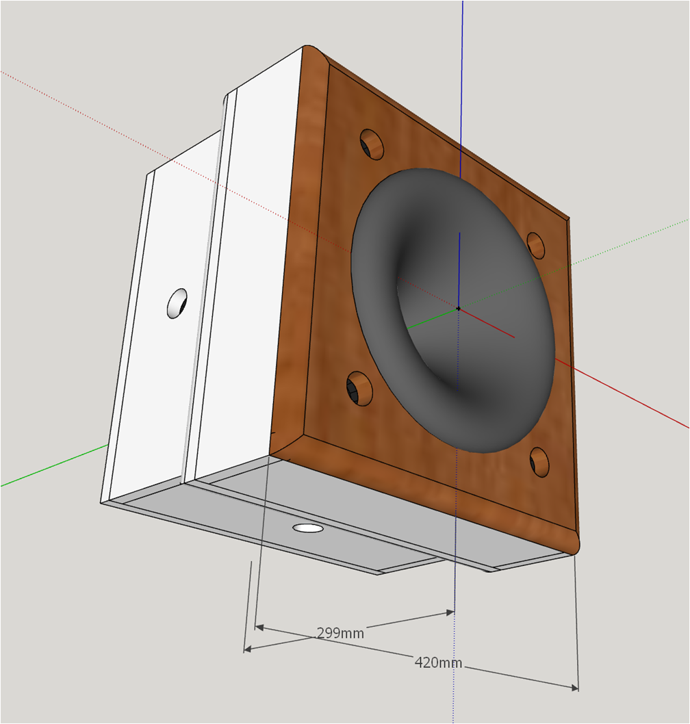

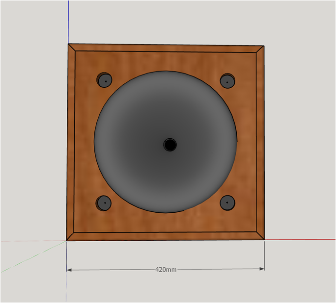

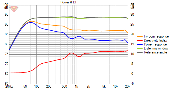

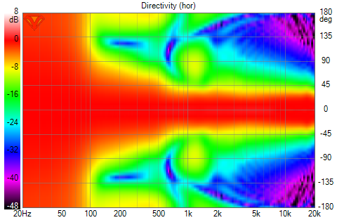

What I tried to do was to get cardioid-like response in 3 dimensions by putting side woofers on all 4 sides of the enclosure:
By lucky accident/mistake, front woofers moved away from the waveguide rim. That worked so well, I kept them there.
Directivity is very smooth and controlled with a gradually widening pattern below about 600 Hz.
although Vituix displayed them differently, V and H patterns are the same as you would expect from the symmetry.
Crossover frequency in range of 900-1100 Hz and slope affect not only directivity but also power response and DI. In optimizing directivity, I see I've ended up with larger ripples in power response and DI than I like so this certainly isn't the last XO.
Finally I have a design that won't break my back. The one drawback to it is it does have a floor bounce null. OTOH, its got the best standing height response I've seen!
Reference angle and listening window curves in the above graph are for standing height.

Shame about the depression between 2 and 8K, you should be able to get rid of that and have it look more like the one above in that region.I used ATH to create a 300 mm diameter axisymmetric waveguide and liked the very first result that popped up
Interesting layout, it's always annoying when you get a smooth polar a funky DI. I've been considering a 12" and 1" combination myself.Crossover frequency in range of 900-1100 Hz and slope affect not only directivity but also power response and DI. In optimizing directivity, I see I've ended up with larger ripples in power response and DI than I like so this certainly isn't the last XO.
I've never been able to run a full 3D simulation with rolled back waveguides using only an external subdomain. The interface was always difficult to get right, when really it shouldn't have such an effect making it difficult to compare against the circsym options.
I wonder if having the rollback end on a flat baffle is better than just having the curve meet the baffle as smoothly as it can.
I think the depression between 2 and 8 khz was in the last graph, which was showing response for standing height. It goes away when I lower the mic. At seated height it isn't there, just +/- 0.4db peak before and depression after 1 khz that I inserted in reference angle response to make PIR and power response look better.
So far, the best simulation has come from using a larger (large enough to get the same pattern control without rim drivers) 1" throat waveguide and assuming it has been synergized. That ignores the effect of the mid-woofer ports on the pattern but gives nicely smooth power response and DI. I'm having very little luck reducing the DI peak of the rim driver system near 770 Hz but the corresponding dip in the PIR is very small so I wonder if it matters.
I have greater trouble with full 3D simulation than you because I'm still struggling with Fusion360, although making progress. Modifying the nodes file helps in the meantime. That trick should work for modelling a roundover smoothly blending into the baffle, albeit a round one. My impression from the few cases I've run is that it almost doesn't matter what is behind the waveguide if it has a full 180 degree round over.

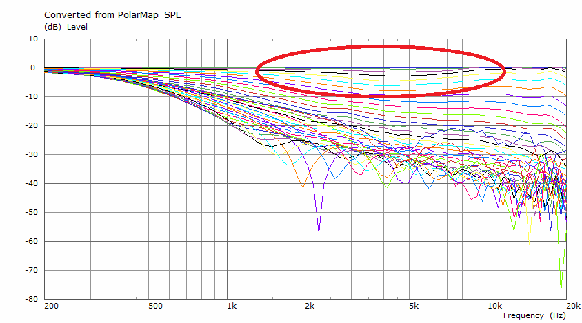

I was talking about the ABEC sim circled here, the previous ABEC graph with a bigger waveguide didn't show that tendency.I think the depression between 2 and 8 khz was in the last graph, which was showing response for standing height. It goes away when I lower the mic.
Some of mabat's earlier simulations showed differences, the rollback is definitely more tolerant of close surfaces but I don't know if the baffle right at the rollback junction violates that in any way.My impression from the few cases I've run is that it almost doesn't matter what is behind the waveguide if it has a full 180 degree round over.
why I think rim drivers are rarely used and probably a bad idea

^^if i remember this kind of feature in ATH response was due to the depth parameter being off from optimal.
nc535, I think the DI/Power ripple can be adjusted smoother by adjusting the xo frequencies, slopes and delay (on the mids), look at the phase plot for cues what to adjust. At least this is the process how I got smoother results over the xo region.
A lower crossover (600LR4) seems to be the cure for the 770 Hz ripples in the power response and DI:
If I could get mabat to run my cfg file through his optimizer, I bet that droop would go away!

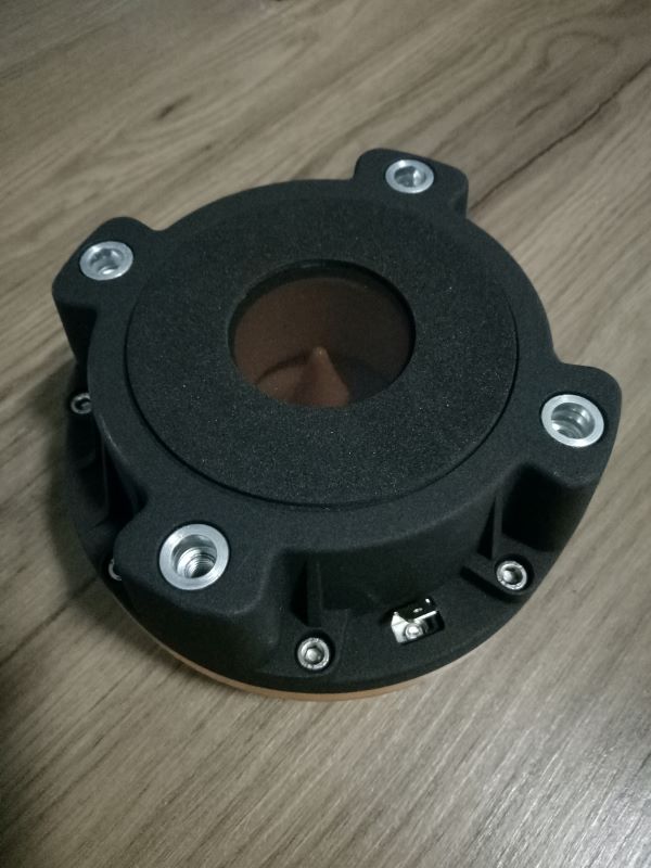

I'd be curious about the solution with a driver like the HF1440, on a bigger waveguide made to suit this driver.
What's not to like if one can forgo the rim drivers completely? I'd guess the HF1440 can extend low enough to make it possible.
https://faitalpro.com/en/products/HF_Drivers/product_details/datasheet.php?id=502020185
** at least for a Home Audio solution **
That was my thinking I hope I will find out at some point 🙂I'd be curious about the solution with a driver like the HF1440, on a bigger waveguide made to suit this driver.
