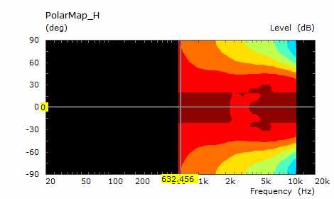

The mesh has the normals reversed which makes it inside out, that will not solve properly or at all, also the square on the front and the back is going to cause problems and there needs to be an interface between the inside of the waveguide and the infinite baffle.
That STL has to be modified in some way to have any hope of it working. If you want to attach the stl I can see if it can be saved or is a lost cause

I revised the STL file hoping to fix that rectangle in back. abec is taking a long time meshing it. Here it is if you want to look at it or try it.

On a quick look the normals are reversed in the STL, you could probably fix that easier in sketchup by changing the normals of the faces. Fusion uses different colours to show the front and back side of a face, maybe sketchup can do the same.

I gave it a try but I couldn't do much with it. I could remove the odd square sections as they had their own tags but I couldn't reverse the normals easily as it was one way or the other and the ports have them the right way already. The meshing with the STL seems OK but control over the tags is difficult, which is less of a problem if the parts have the normals correct in the CAD program.
Maybe you could export the layers separately after meshing? Meshmixer sees the layers in the STL so it should be possible.

to have a normal, the shape must enclose a volume. Mine doesn't; I've left the sides off, as they should be since its a quad. If I join 4 quads, then the shape will enclose a volume. Should I do that and then cut that stl down to a quad?
despite normals the simulation seems to work; now looking at redefining SPL nodes to get the 5 or 10 degree directivity for Vituix. the bem solving took 25 miniutes. redoing the observation is just a few seconds

I have no idea what you mean but the normals are extremely important

In the BEM normals are playing an important role, because it is through the normals how the solver knows about the enclosed volume. In general, the BEM produces a field only for the volume, which is surrounded by the boundary. In case of radiation into open space, one of the boundaries is at infinity assuming a Sommerfeld radiation-condition, hence the volume is in this case the open space. Outside the boundary the result of the Helmholtz-Integral should yield zero pressure. For Direct-Sound-Analysis normals are of no importance.
Normals should point always into the domain, which the element belongs to. For an exterior domain this volume is the outer space extending to infinity. An exterior domain is specified by ElType = BE_Exterior of section Subdomain_Properties or of section Elements.
I have no idea what you solved in what conditions so I can't really comment on it.
I don't disagree about normals being important. What I meant is that inside vs outside is arbitrary unless the shape encloses a volume. The shape I created STL for didn't enclose a volume; it was just a quadrant of a waveguide's zero thickness surface, with mid ports that did have an obvious inside (which is why they had normals right). By joining 4 quads I enclose a volume and there is an obvious inside vs outside. Any export from joined quads should have the normals right. I'm testing that hypothesis now by rerunning abec; Its not quite done yet; I didn't start it right away but its going faster than the prev run
It is about the boundary that ABEC is simulating, the boundary has to be closed whether in the model or by the infinite baffle. Even though there is only the front waveguide surface it is enclosed by the IB with an interface in between. The port is the same it could be it's own subdomain with the volume of air in the port separated from the volume of air in the waveguide, but that doesn't actually help much to do.I don't disagree about normals being important. What I meant is that inside vs outside is arbitrary unless the shape encloses a volume. The shape I created STL for didn't enclose a volume; it was just a quadrant of a waveguide's zero thickness surface, with mid ports that did have an obvious inside (which is why they had normals right).

Type "sketchup reverse normal" into google and there seems to be plenty of information on how to do it.I see that normals are indeed reversed.
I don't see anything I can do about it in Sketchup; I don't seem to have any control; the exporter has no relevant controls
Yes you can swap normals in ABEC/Akabak but when the model is composed of hundreds of triangles it is impractical to swap each one If you can bring the elements in separately then you can swap the normals on a whole item at once without affecting others. This is why gmesh is so useful as it tags contiguous surfaces separately with step files as input.

Yes you can have as many different files as you like as long as you can keep the vertices aligned when it is meshed, splitting them up into sections should make adjusting normals in ABEC/Akabak easier.
To add them in you just need to follow the same principals of adding an element with a unique name and ID and linking it to a mesh alias etc.
