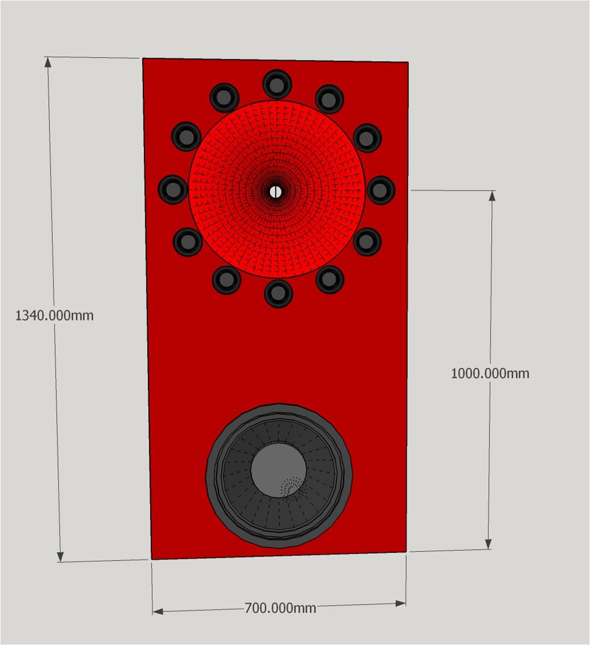

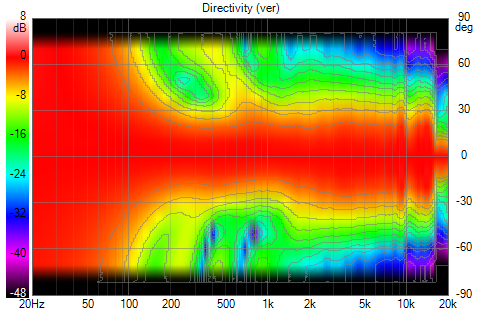

and if I add 15" woofers to the top and bottom of the previous sim, I get some control over the vertical circa 200 Hz but there still is excessive influence in that lower midrange so more work to be done
attachment.php
and something like that is bigger than I want to build
15" woofers at +/-750 mm from wg 1m above floor

A 15" woofer up high is just too much.
I'm going to try that larger waveguide with lower XO next. I think that will help. But there is a limit beyond which you need to synergize or use that monster Celestion AXI2050
Then use enough small midwoofers to get the bass without the concentrated weight. I will try two columns with perhaps half wavelength spacing at 500 Hz XO

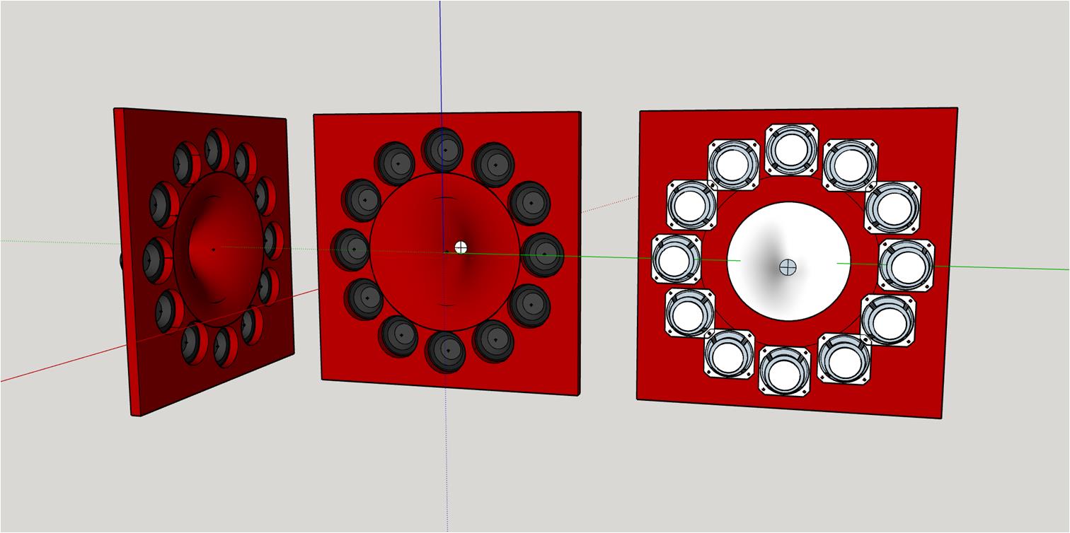

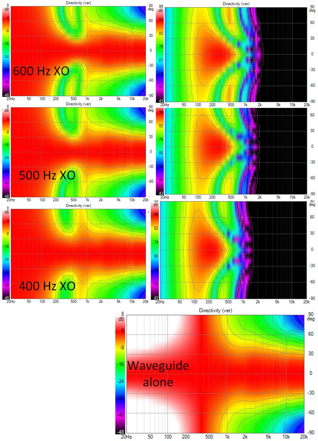

I've got some polars despite the shortcoming of the directivity files. It appears that Vituix does a fair job of extrapolating downwards in frequency.

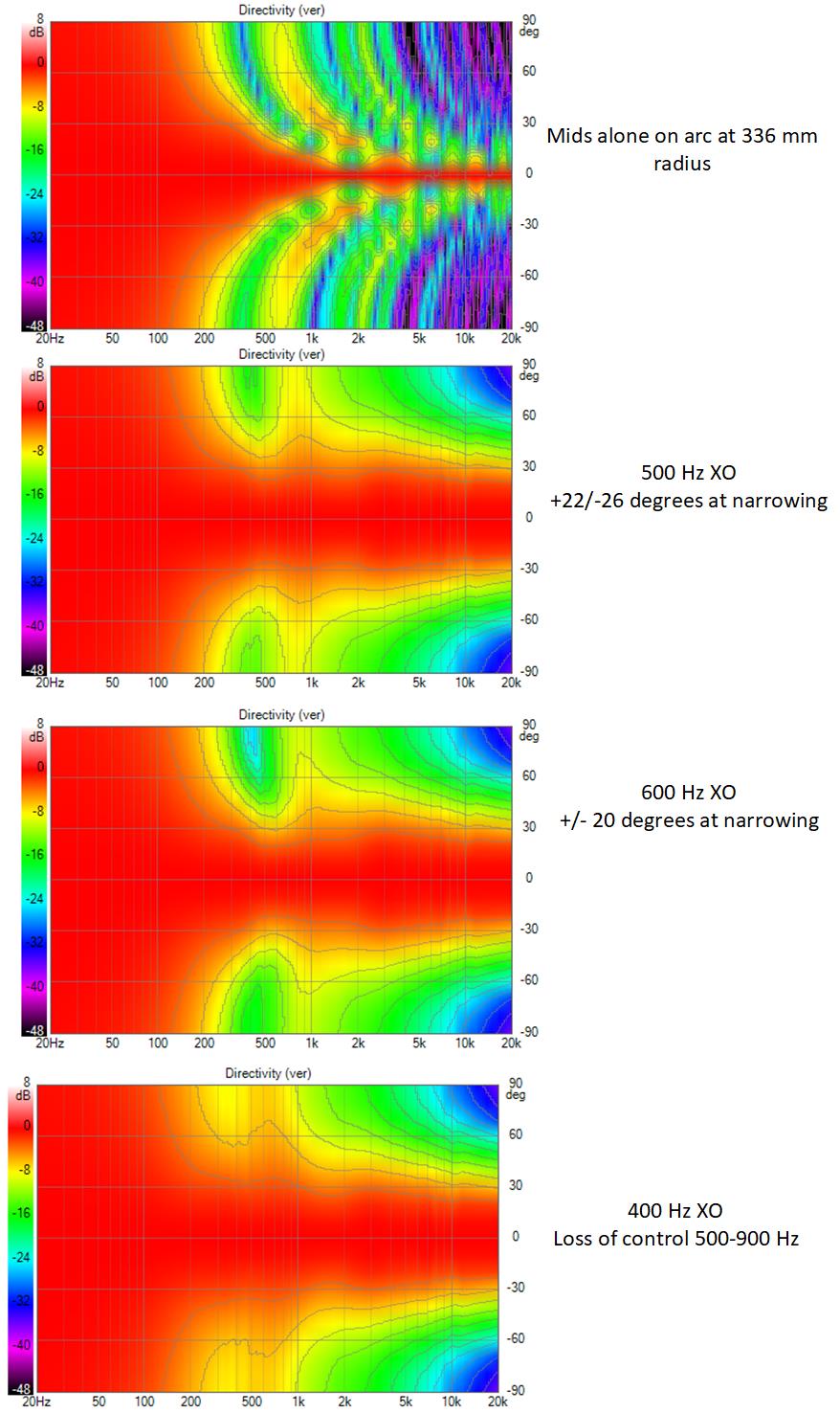

For a row of midwoofers above and below the array, these charts show results for XOs of 600, 500, 400 Hz from top down. The right hand graphs are both sets of drivers; the left hand charts are the un-normalized vertical polars of the mids alone.
attachment.php
The CTC is too high for greater than 400 Hz XO, the directivity of the WG is too low for even a 600 Hz XO.
Things look better when the midwoofers are on a circular arc. The effective CTC is smaller since all drivers are same distance from axis instead of at increasing distance for the ones further from the axis

Here are the polars for the mids on an arc of 336mm radius. There are 12 drivers at the hour marks of a clock with the drivers at 3 and 9 oclock muted. The baffle has to grow to 600mm wide for this but the 4 drivers over the +/-250 mm X mark do extend the H pattern control
attachment.php
These sims where done absent floor and ceiling reflections to focus on XO and CTC issues. With XO in the 500 Hz to 600 Hz range, the wg doesn't need to be synergized. Alternatively, one could design for 1" exit driver and synergize using the 4" Celestion sealed back mids.

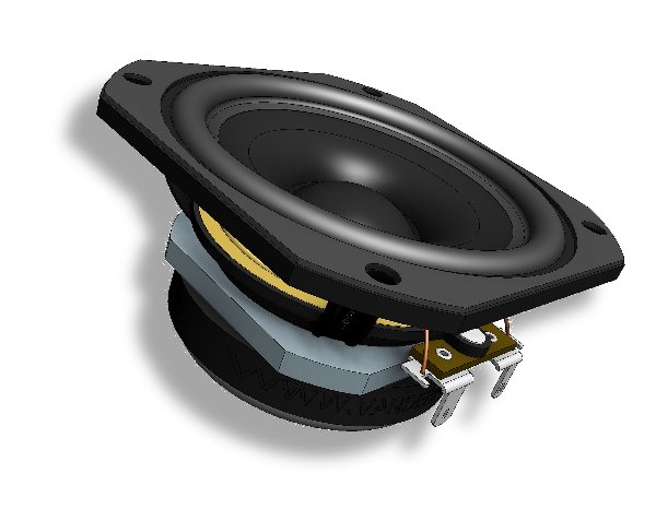

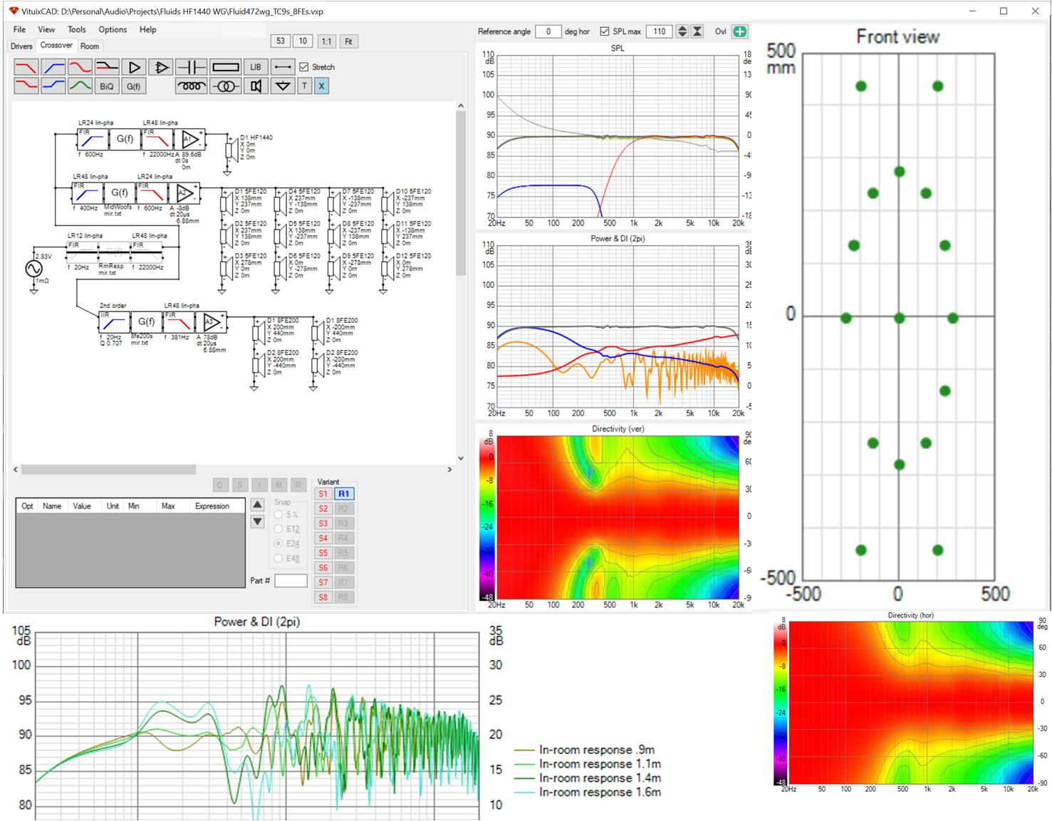

Switching to TC9 mids improves the picture. The baffle was too wide for 5FE120 clock face. CTC improves marginally with TC9s. But I'm back to using that same fake model.
attachment.php

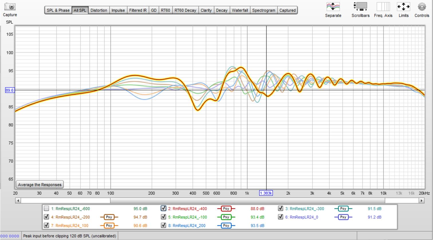

The polars are great but there is a floor bounce null at 300 Hz
attachment.php
That null is inherent in the wg and tc9 center to floor distance and is there with either or both of those two drivers playing. I can fill it somewhat from the woofer but that, as I showed not that long ago, would be a precarious balance.

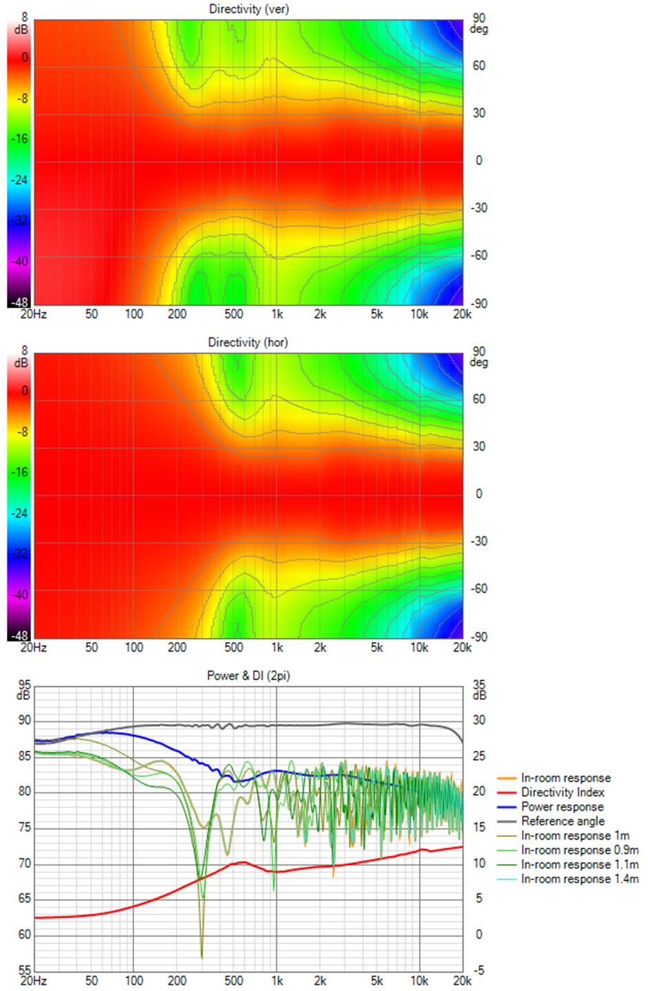

Lacking a better idea, I tried replacing the TD15 with pairs of 8" woofers just above and below the circle of TC9s
attachment.php
This gave vertical directivity at 300 Hz albeit and the floor bounce null is moderated although its hard to see how much without smooting the room responses
attachment.php
For the above graph I flattened the room response. Only floor and ceiling reflections are enabled. REW insisted on highlighting the 400 mm offset line. This is pretty good for seated listening at 3m; somewhat disappointing in the amount of reflections seen above 1 khz, I expected less given the apparent directivity...
