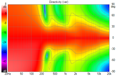

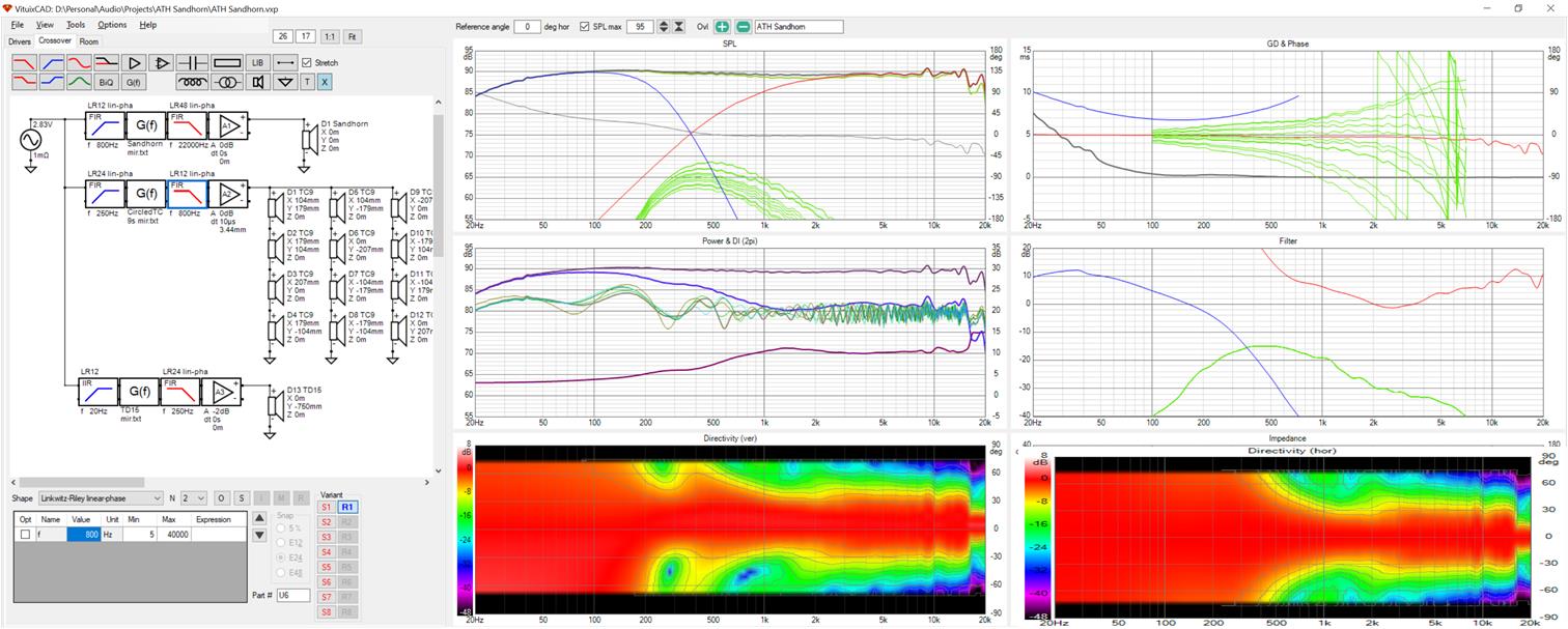

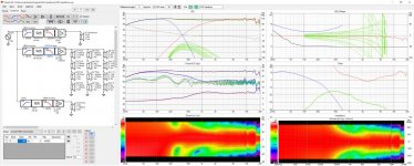

I added a TD15 woofer at floor level and enabled reflections. The room response overlays in the middle graph are +/- 100 and 200 mm offsets from nominal mic ht of 1m, There XO is set at 800 Hz with very little narrowing of H pattern. The narrowing increases if XO is raised...
attachment.php
This horn is 60H so wall reflections are smaller than with seos18. The response variation with height is smaller also.
With this smaller wg and omitting the 3 and 9 PM TC9s, the cabinet will be narrower. Now for an ATH waveguided designed to terminate in a baffle...

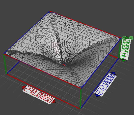

Nice work, I've attached a pretty good squareish guide in Vituix format that you can play with. I have a round version too but haven't exported the data.

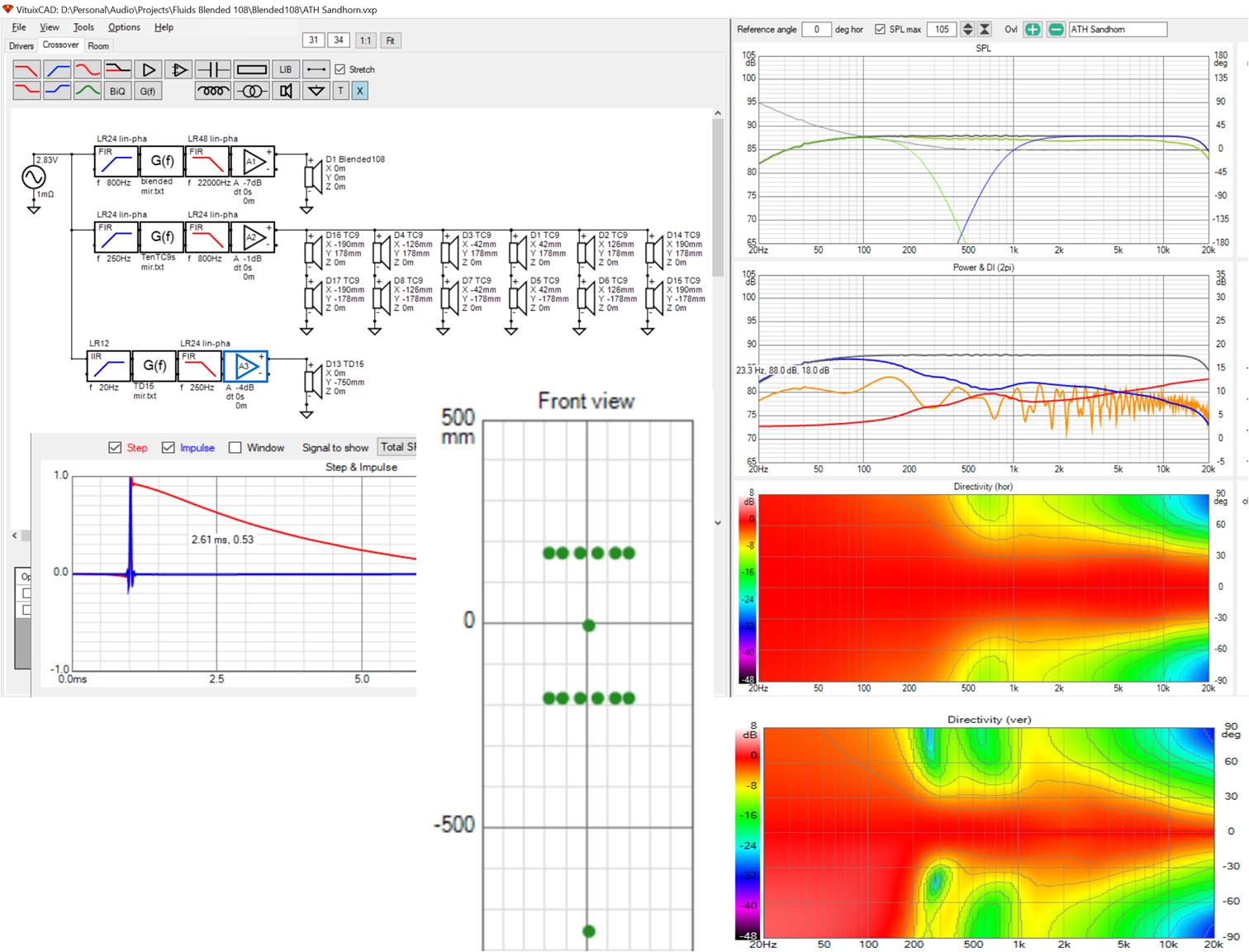

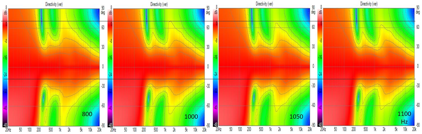

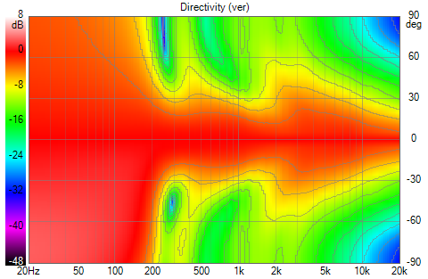

Your waveguide works quite well flanked by 5 TC9s each just above and below and with a 15" woofer at floor level. 5 TC9s exceed the width of the wg so the horizontal pattern controlled is extended. CTC doesn't allow XO to the TC9s high enough to keep the vertical pattern from widening a little bit above XO. A quick look tells me that some overlap between the tc9s and the CD cures that so I will work on that next

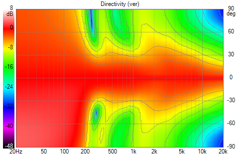

Overlap narrows the vertical, perhaps too much. Just a little bit is all that is needed.
High pass on CD/wg is 800 Hz. With low pass on TC9s at 1000 Hz:
attachment.php
which might not be enough
with low pass on TC9s at 1300 Hz:
attachment.php
which is clearly too much
with low pass at 1100 Hz
attachment.php
which is as far as I would go.
The overlap causes a 2 db or so hump in the FR in the overlap region. This can be flattened with a PEQ or by a room/global EQ stage, which is what I did for the sim.

Its easier to judge the overlap with all the graphs side by side.
attachment.php
I added two reference lines to the composite.
The upper line is where the red sidelobe near 2 kHz in the left hand, no overlap graph fades to invisibility. Overlap is intended to reduce this lobe.
The lower reference line is at the narrowest point in the no overlap graph- at the XO to the woofer. How much reduction of the vertical widening of the pattern at 2 kHz is limited by how much narrowing of the pattern one is willing to accept elsewhere. I don't think this can be settled in simulation 🙂

nc535, what is the G(f) block doing in you sims? Is that the EQ?
G(f) is how Vituix represents a FIR filter block. "mir" at the end of the file name means the filter response is a mirror image of that of the simulated or measured response input to the filter. Its actually an impulse response inversion and produces a flat line frequency response. The low pass and high pass filters that flank it then set the slopes for crossover. Done this way, the whole process of creating a crossover takes a few minutes. In the "lab", I would add a shelf filter for voicing. When going to the lab, Vituix can export an impulse response for each set of cascaded filters, which then can be imported into JRiver or some other DSP engine.

Here you go, if you think a smaller guide is worth trying I might something suitable already cooked.
I think I prefer the 800Hz or 1000Hz from above. The change in directivity is smoother. I don't target something that jumps from one to another even if it's better over some of the range.

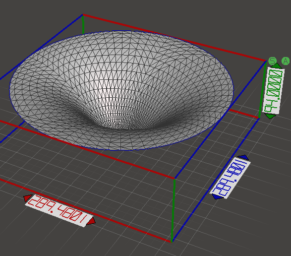

Thanks. What is the diameter?

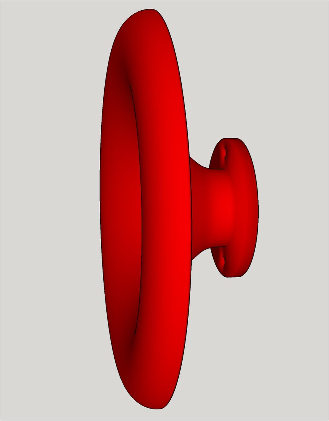

I'd like to have the shape in Sketchup for visualization and fit. All it takes is a profile line to rotate but importing a curve is difficult unless you can find a plug in. I've imported one of mabat's stl's but its got so many triangles and squares it brings the program to its knees. If I delete all the shapes except a single profile line, I'll have what I want.
I agree on the 800 Hz. That is the widest vertical window and its not at all clear that that light red widening near 2 khz hurts anything.
The diameter is 289.4801mm 😀
As you see from the wireframe this is circular but not axisymmetric the vertical beamwidth is narrower than the horizontal.
I can send you the whole thing as a step file if you can import that, rotating a profile won't work because it's not the same all the way round.
attachment.php
Now I know how to handle a large STL file - the same way one does a small one but go for a cup of coffee between steps
attachment.php
This is mabat's ST-260 imported into Sketchup, scaled to size, edges softened and painted.
