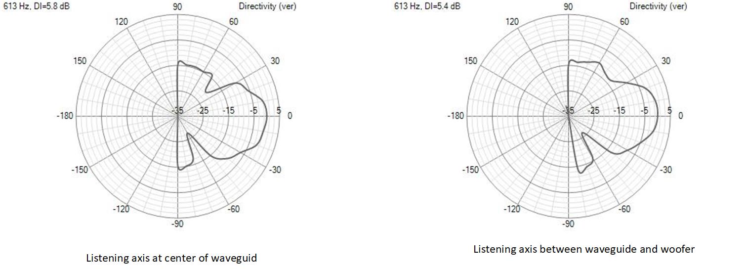

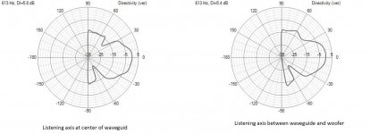

Conventionally, we place the wg center at ear height and the woofer below resulting in a path length difference on the listening axis. If we shift the drivers upwards so they are centered about the vertical axis, path lengths are equalized on the listening axis. You can tilt the wg down to counteract beaming at hf.
The lobing at xo is best seen in Vituix using a polar chart at/near XO frequency
attachment.php
Judging where the main beam is down 1db, the beam width difference is 50%. At -3db or -6db points, the difference isn't nearly so large

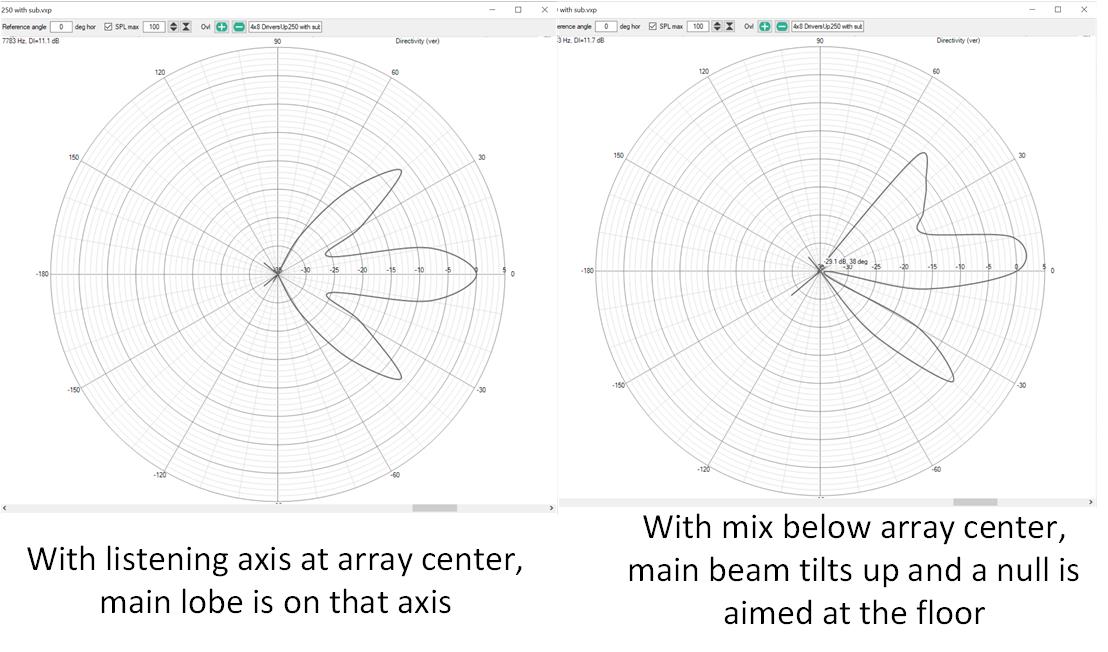

with the help of polar charts, I think I can explain the improvement in my vertical window with shifting drivers upwards.
To relate it to the previous post, think of the center, unshaded portion of the array as the waveguide/tweeter and the outer, shaded portions as woofers.
The main things that happen when I shift the entire array upward is shown below with polar chart at a random frequency.
attachment.php
When I repositioned the array, I tilted the main beam of the array upwards and aligned the bottom edge of it with the bottom edge of my vertical listening window at my listening distance. For a different listening distance I would want a different vertical array position.
There is also less energy aimed at the floor than at the ceiling. I'm not sure how much that matters. The floor reflections are earlier but enabling/disabling floor reflections has a larger effect on the room response than doing that to ceiling reflections.
While the lobing pattern in the polar chart varies with frequency the two aspects noted are consistent with frequency.

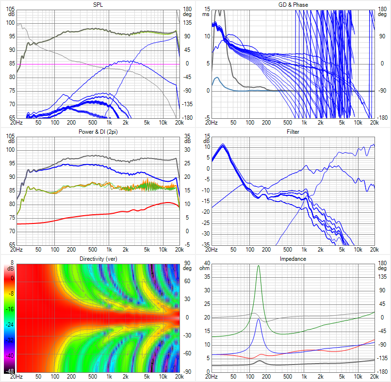

A very quick test with only TC9's used shows it could be an advantage to use the filler drivers:
attachment.php
Obviously I needed boost on the single HF driver. But with a bit of work this could be interesting enough to figure out 🙂.
I'd say bbutterfield is on to something here. It all started with that fractal array thread.
(replaced it with some EQ on the filler drivers and central tweeter, plus added the +100, -100 and center axis)
It would need a good ribbon/planar tweeter that is sensitive enough, and some work to get the pattern just a bit wider to also cover standing positions.
For the above example I just ripped out the central 3 TC9's, moved 2 to act as filler drivers and one as the central tweet. All done with linear phase crossovers to be able to quickly adapt. With a bit of shaving, this one would fit the spot of a TC9 central position: NeoCD3.0

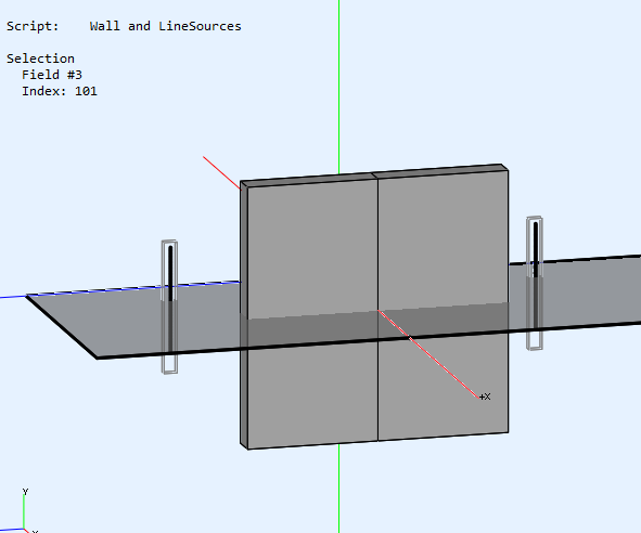

I also found this little example in the ABEC demos folder, a virtual line source with wall in the way, interesting.
